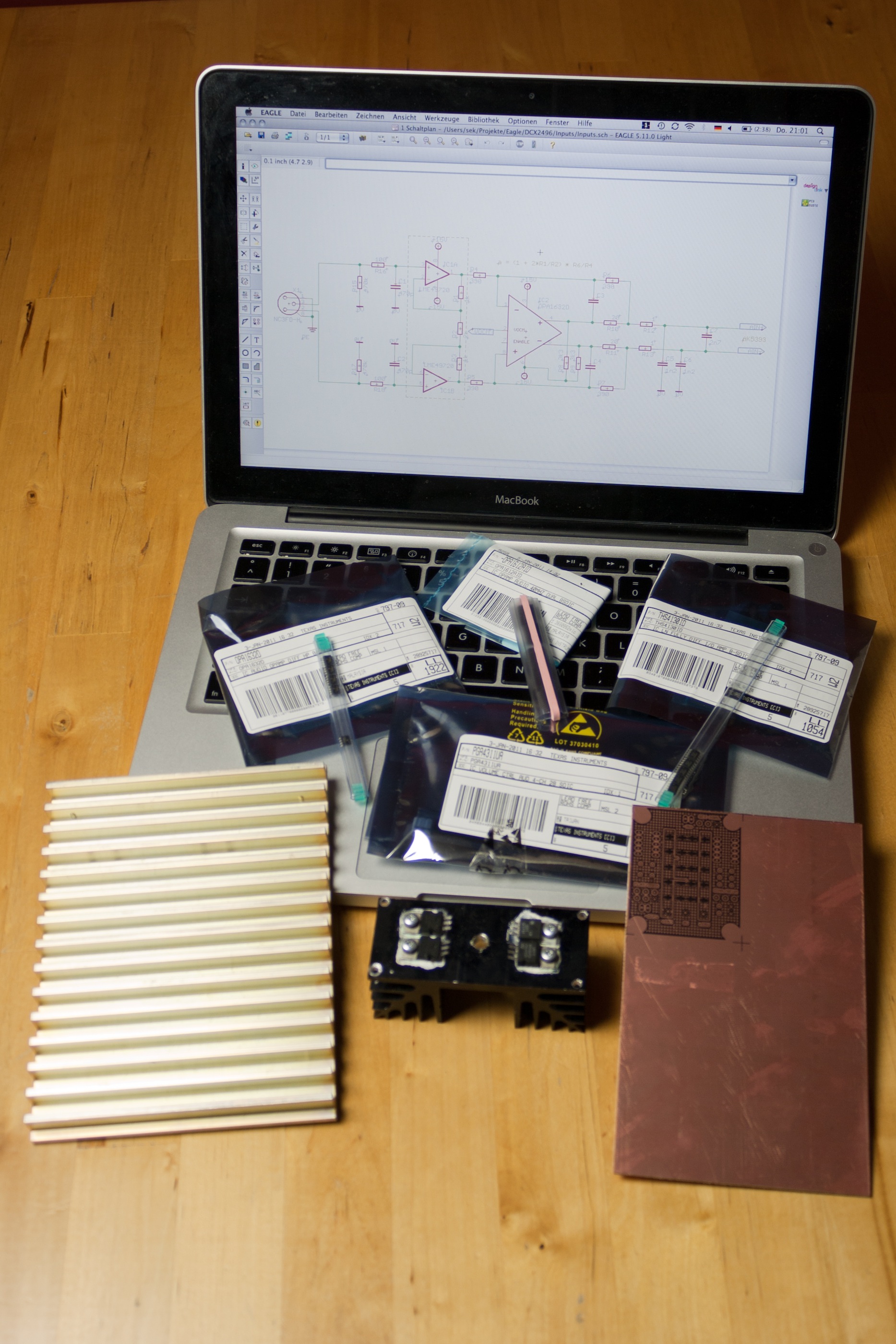

I'll post as soon as I got something, but unfortunately it's exam time (cs) of the year already!
All of the most significant parts have arrived, though (see pic in fullscreen mode). I'll likely be able to get to it in about two weeks.
Sebastian.
