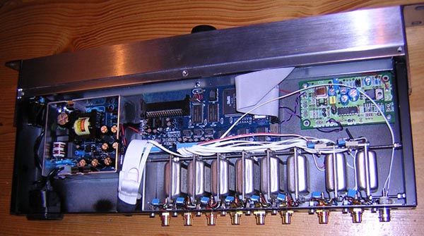

DCX2496 minus 16 dual opamps + 8 transformers
hi guys,
Just finished major surgery to my DCX, I removed the I/O pcb and
mounted input and out transformers. The transformers are microphone input transformers of good quality but of unknown origin, ratio is 1:3.16.
The '1' winding has a centertap that I use to supply a 2.5V offset
voltage (from two TL431's) to the ADC's.
Result is a lot more 'air', space and detail. The sonic impact of
this modification is about the same as mounting the Tentlabs XO2.
I mostly listen to CD through the digital input, but the analog
inputs improved quite a lot also.
kind regards, Peter

power supply bypass
hello
for those who want to mod less radicale i can recommend to bypass the 100nf condensators for ps decoupling for the 4680 opamps (c1-4, 69, 70, 92-97) beside the mods on the analogue i/o suggested in this thread earlier.
i used 10uf smd tantal (c - footprint) and it really is surprising what a big improvement this is. especially on low and very low levels. which means first input led flashing or below you gain great in tonal smothness and soundstage.
one would think that at such very low levels the imperfections of digital converters would dominate the sound but as far as i can hear, there is still a lot of improvement that can be done at the analog side.
http://www.kinotechnik.edis.at/pages/dcx2496/DCP02068.jpg
http://www.kinotechnik.edis.at/pages/dcx2496/DCP02067.jpg
for peter
from your picture i would guess that your bypass condensators for the ad/da converters are still original. try to replace them with 10u tantal - if you dont have anything better in mind
http://www.kinotechnik.edis.at/pages/dcx2496/DCP02031.jpg
its a very cheap mod easy to do and gives very good results as well
hello
for peter
