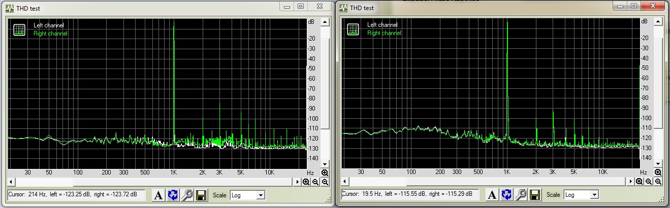

Yesterday I changed PSU's capasitors to low-ESR Nichicon caps designed to be used with switching power supply. In theory it could benefit transient/bass response slightly. I could not compare the two DCX's since the other is not burnt in yet. I did notice some difference between their sounds in a/b comparison (slightly more bass, fuller sound) but coudn't tell was it because of the new caps or the lack of burn in. Also the RMAA result vere slightly better, but this was so slight that it could be due the natural variation.
After verifying that my mod worked I changed some caps on the digital board. Those five caps that are nearest to the ADCs I changed to Elna Cerafines, and from the capasitor herd near the PSU I changed all 10µf caps except the three that are between the power regulators. RMAA measurements showed that THD% and IMD% dropped:
THD%
before: 0,0094 %
after: 0,0044 %
IMD%+noise
before: 0,014 %
after: 0,0080 %
IMD% over freq:
before: 0,056 %
after: 0,045 %
In graphs, these lower THD and IMD values show themselves as less "noise" in the high frequencies. IO have attached a picture of THD graph comparison.
I have not yet changed the caps in the I/O board nor the caps that are next to the DACs (will do once I collects the boards).
After I have collected the boards with new op amps and DACs I will run some test to verify the possible improvement. I'm pretty excited to hear the AK4396's sound, it has got good reviews and seems to live up to it's name "crystal".
After this I will change the rest of the capasitors and measure and listen again. Then I'm finally done with this "improvements based on the stock design" modding. If neither of the DCXs doesn't die in the process I'm kind of a surprised.
It seems that replacing the stock capasitors to some high quality caps is a very easy and quite benefial upgrade to DCX. Take a look, this result even with half of the stock caps still inside:
That's nice - it does show some noticeable improvements at the top end.
Did you do any dual or mulit-tone measurements? The often show a lot more distortion than a single sine wave. Good for seeing if you are making progress or not.
I did just basic RMAA. It has pre-set IMD% test, which measures the IMD with two tones, one at 60 Hz and one at 7 000 Hz. Is there some more versatile measurement tool? Preferably one that is free or available in "the other way".
