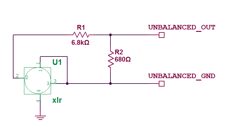

High output impedance
It might not sound as good this way as you are increasing the output impedance by the amount of the new series resistor which will interact with the following cables more. This will work really well at the amp though.Why not attenuate the output with a resistor divider? I did it right inside the xlr jack.

It might not sound as good this way..
Sounds fine to me. In fact it sounds the same (to me) as the signal unattenuated through my line receiver (shown a few posts back) to the amp. When I first got the DCX, I used it straight with the output unbalanced to the amp with volume attenuation from the source and this sounded just fine also.
If I had my time back, this is exactly how I would configure it in the beginning and save myself some work (and money). I have 6.8K in series and 680R to ground for ~20db attenuation.

I think that I should use the resistive divider circuit to lower the sensitivity of my DIY amps. Epecially as unbalanced they are being pushed 6db harder by the DCX.
I suppose that I should take account of the speaker sensitivities, and try to trim the gains for a good matched output at the crossover points.
I could put the Divider circuit internally on the DIY amps.

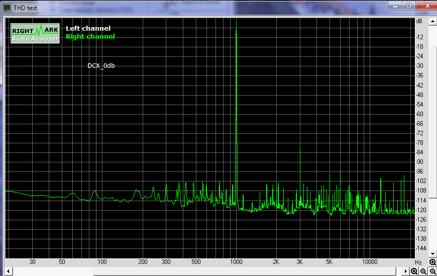

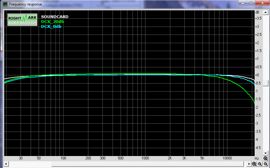

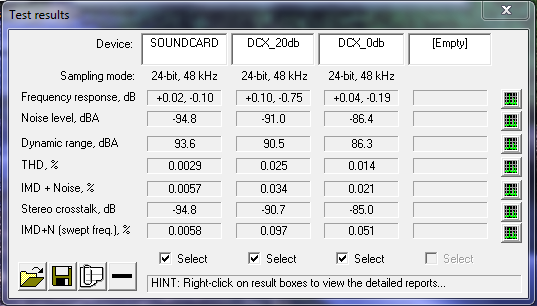

Curiosity got the better of me and I ran tests myself on the DCX using RMAA.
My unit is stock and a little more than a year old. I reset all of the channels to flat, input gain to 0, output gain to 0 and all filters and EQ off for the test. The test is on one channel only and RMAA is set for mono mode so pay no attention to crosstalk figures. I'm using the analog input "a" unbalanced. Output is also unbalanced (pin 1 tied to pin 3).
Results:
Soundcard is a Creative Audigy in slot 1. Slot 2 is through the DCX and attenuated 20db by my resistor divider in the xlr jacks. Slot 3 is through the DCX with no output attenuation.
Frequency response:
THD for the DCX with 20db attenuation:
THD for the DCX with 0db attenuation:

Thanks for those John.
Do I see a suppression on even order harmonics? And that your attenuated signal looks a little more even in harmonics than the 0dB?
Odd the slight roll off at the top of the attenuated signal. Not likely to notice it, but what would cause it?

THD is lower for the unattenuated, frequency response is a bit better and IMD is lower. Noise is up though, but not by much - still close to -90db. Looks like it is a better bet to leave the signal through the (stock) unit low. It would be interesting to run the same tests on a unit with the modified input and output stages.
I'm surprised by how much distortion the DCX adds, even with all of the DSP disabled. Using this formula: THD= SQRT ( (dist1*dist1) - (dist2*dist2) ) to subtract the soundcards THD gives worst case - 0.0248% and best case - 0.0137%. Can most of this be attributed to the output stage?
