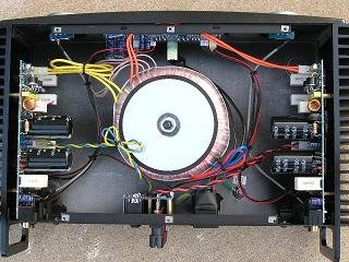

I am in the middle of building the quasi FET design and was starting to wonder how to package it nicely in a box with heatsinks , power supply, etc...
I bumped into the A500 pictures and thought that for $180, it might provide a lot of hardware to get there.
(a box, heatsinks, transformer, connectors, knobs, potentiometers, etc... might cost as much).
Does anybody have the schematics of the A500?
Has anybody tried to mod this guy before?

I was also looking at the A500 as a potential for DIY project.
Upgrading the capacitors, changing some electrolitycs and eventually replacing the power pcb. But I would like to konw a little bit more beforeI jump on it.
To try answer your question on transformer rating, just based on the diameter (around 6 inches), I would expect this transformer to be in the 500 VA range.

The transformer should be at least 800 VA, a nice one.
As I said a high VA transformer is a must for me.
3) I hear that Behringer does not provide service manuals of its products (unforunately).
It should be very difficult to find the schematics.
4) Thank you for the info.
I hoped more. I am a little worried about a only 500 VA rating.
Actually my first mod would be, if it were possible, the replacement of the transfomer with another one more powerful of at least 800 VA (better two 500VA/each space allowing), hoping that in the circuit there are no current limiting devices/circuits of course.

In the end I bought an A500.
Overall a very nice amp for the price (180 euro).
I have pushed it with my Dynaudio speakers and found that at mid to high level the amp strains and the sound become thin and compressed.
Sign of a limited current delivery at some point.
To be honest I have to say that my speakers are demanding in terms of needed current from the amp.
Looking inside and I see a quite big (about 600VA ?) mains transformer (regulation ?), 4 small filter caps (3300uF/100V) of unknown quality and discrete diodes bridge of 6A on each PCB (one per channel).
Do anyone own the schematic?
I strongly think that the first mod should adress the diodes bridge (with something like a 25A units) and the too small filter caps (4X10.000uF of good quality could help).
But I have to find the schematic first.
