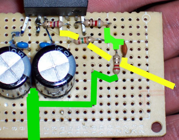

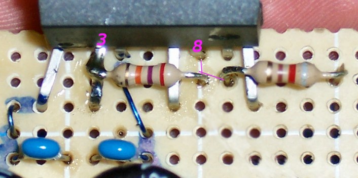

Since this amplifier is designed to run without a preamp, we need a few passive parts.
A 2.2uF electrolytic cap or a smaller value poly cap.
A 470 ohm resistor.
A 1 million ohm resistor (1M).
The capacitor blocks DC to protect the amplifier and speakers, while the two resistors help combat noise.
This photo shows the three parts added.
It shows the path of the input cable in yellow, while the ground is shown in green.
A 470 ohm resistor.

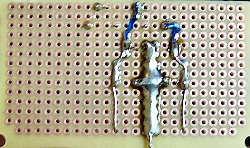

MJL21193 said:What it's going to look like soon...nice and simple.
Yeah, that right side looks awful.
Edit: Its a nice passive pre there, and I did so much better job on the little LM1875 board.
The problem is that (this time) I used eboard (with pads) and that wasn't a convenience at all! I've spent much extra time trying to keep the circuits away from all those extra pads. Darn.
Maybe I should give it a redo on plain veroboard, before going any further?

AndrewT said:
What about a list of components for the simplest version.
Then a list for the simple version
Finally a list for the normal version.
That's a really good idea!
Its not really several versions, though. Its the same amplifier given with or without the optional hum-reduction components.
Simplest version (the "core" amplifier). . .
One channel is listed--so, for stereo, get twice as much.

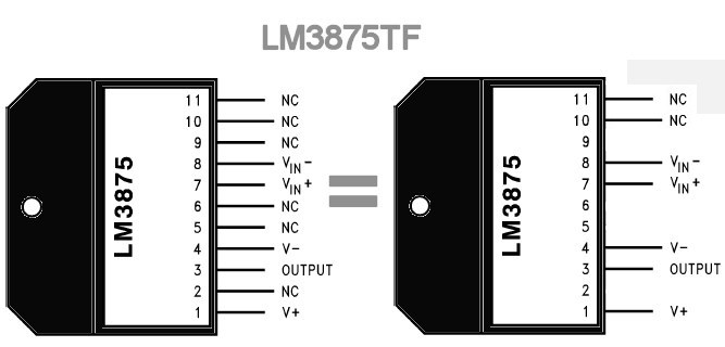

IC chip:
- LM3875TF or LM3875T+heatsink insulator
*Either needs a sufficiently large heatsink

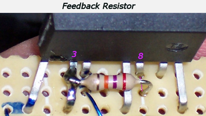

NFB, Negative Feedback Loop (two resistors that set the gain):
- A 27k resistor
- An 820 ohms (820R) resistor

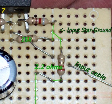

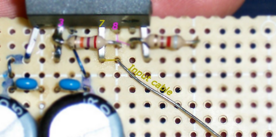

Input circuit:
- A 15k resistor (goes directly from pin 7 to ground)
- A 2.2uF capacitor (made-for-audio electrolytic or any "poly" cap)
- A 470 ohm resistor (can choose any value between 0 and 1k, depending on results--470 ohm is the centerpoint value)
*Using a potentiometer is suggested

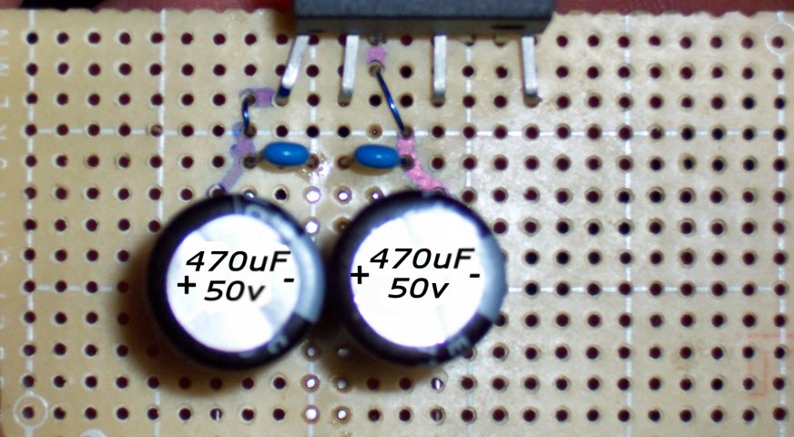

Power:
- 1 pair of 100nF capacitors (50v or larger capacity)
- 1 pair of 470uF (or 330uF) electrolytic capacitors (50v or larger capacity) the stripe of both caps faces the "v-" side.
*This amplifier also requires an additional power supply board
Optional components:
- A 1 megaohm load (1m resistor) at the amplifier input terminals (from + to - of the input signal cable--at the amplifier board)--performing hum reduction utility.
- A 330pF cap from pin 7 to ground (in addition to the 15k input impedance resistor)--performing an RF blocking utility.
- A 2.2 ohm resistor (a value from 2.2 to 4 ohms is fine), from power ground to input star ground (connects to the 15k, 330pF, and 820R listed above)--performing a "groundlift" utility.
- A speaker output zobel consisting of a 100nF cap (or 47nF cap) and a 10 ohm resistor (resistor goes from pin3 to the cap--and the other end of the cap goes to speaker ground).
*The speaker output zobel may, optionally, be located at the speaker output terminals of the amplifier chassis.
Component selection:
- Resistors? 1/4 watt resistors will give good results. You may use a more-durable 1/2 watt resistor at the speaker zobel.
- Potentiometer? The A20k Dual Gang (20k stereo pot) is a generally compatible value, although there are many other working options.
- Power supply board? A rectifier (makes the AC from your transformer into DC for your amplifier) and at least 2 pair of 2200uF caps per rail.
*Power supply board needs further discussion; however, that topic is beyond the scope of this thread. A kit example was given earlier. We will construct power supplies later. Those are easier, but there needs to be a safety discussion located on the power supply thread.
