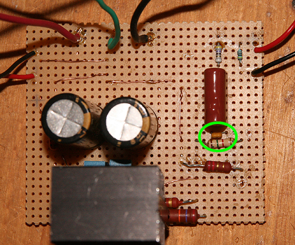

The cap circled in green does shunt RF. That 220pF circled in your photograph is named "RF Blocker."Daniel- is the cap circled in green not the shunt cap?
What you're missing is the cap specifically named "NFB-Shunt Cap."
That is the electrolytic cap in the upper left corner of this photo:
Please install it as soon as possible.
You need it. That part will help you get up and running, with less chance of destruction. It blocks amplification of DC. You can use any 440uF or larger cap there.

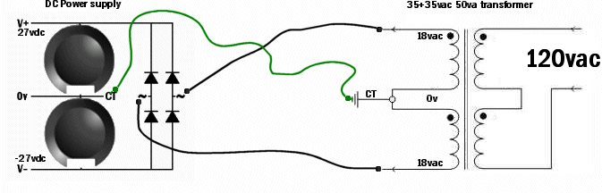

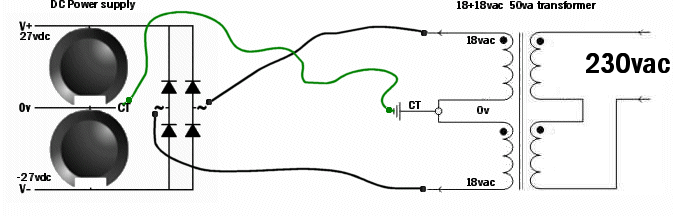

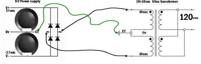

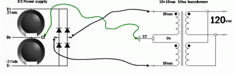

Well, you did make DC, but you didn't make Split Rail DC.The transformer is wired in parallel. The leads on the transformer are quite short so I have pigtailed them close and run a lead to the rectifier.

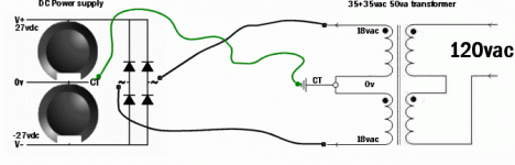

For split rail power (standard of audio amplifiers for more than 40 years), you'll want to hook up your transformer correctly.
Here is transformer diagram from Decibel Dungeon:
Wire your 9+9 transformer as per the top diagram.
Use 3 conductors of about 8" length, fluxed and soldered to transformer output, which is shown on the right-hand side of the above diagram.
After you complete that task, you have a suitable center tap transformer.
Next,

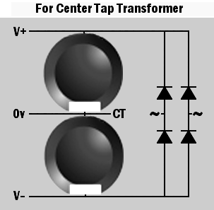

Connect your new 3 conductor transformer cable to this:
Right-hand side of that shows "~" and "~" for "ac bridge"
and it shows "CT" for center tap, 0v, ground.
That is why you need a 3 conductor transformer cable.
(For reference, V+, 0V, V- is DC output)

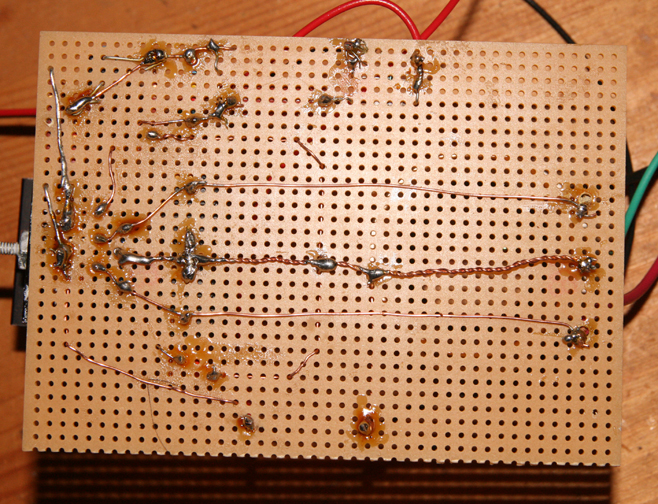

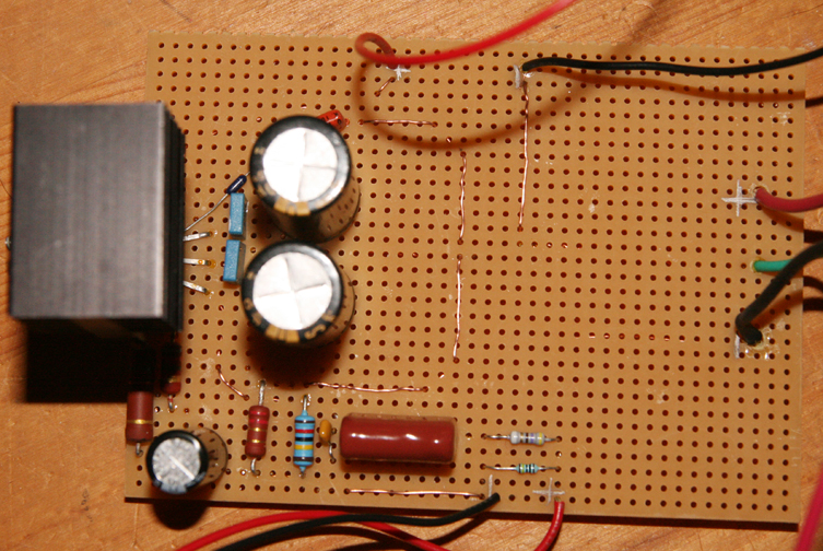

Well I've finely got the centre point right. I blew 3 fuses the other day trying to get it following the drawing on DD.
So far one of the amps is working well but the other is just humming fairly loud. No music! I have tried comparing the 2 boards but can't see any difference between them except for one small transistor. Is it possible that I have blown the 1875? I do have an extra that I could put on it. Maybe you can see something I am missing in the photos.

Hi Prezden,

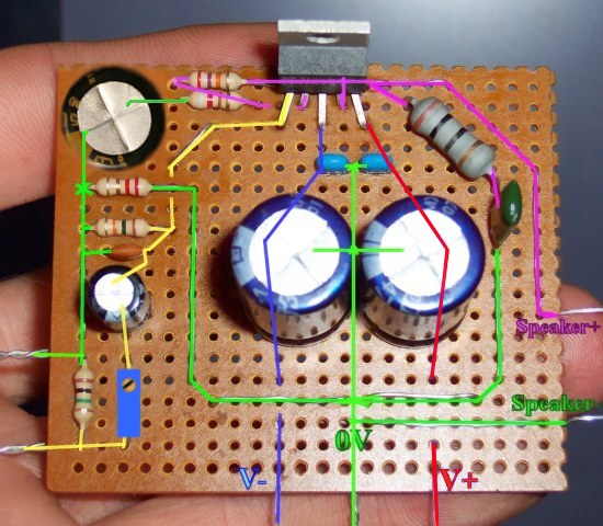

Second photo, error = the NFB-shunt cap is shorted.
Cut the diagonal copper trace (far upper left corner), so that your signal can travel through the NFB-Shunt cap.
NFB-Shunt cap can't work when shorted.
Second photo, error = inter-trace spacing too tight at the chip.
Spread the traces (far left, under chip) to provide more room between speaker output, Pin4 and inverting input, Pin2. There may be a short, either now or soon to be, accidentally between inverting input and speaker output--tiny small-signal input transistor is not strong enough to withstand that. Needs slightly more space there.
Second photo, minor error = too much inductance, the board is too big.
Phenolic perfboard can be sized by scoring it along the holes, both sides, and then flex it. The gauge of cable shown is too thin to be covering excess distance, and that makes excess inductance. I'd suggest to use half as much board.
Quality control check
Before connecting a speaker, connect a DC voltmeter to the speaker output of the amp, set the DC voltmeter to the most sensitive setting and see how many millivolts of DC offset is present. If digital meter, check at other sensitivity settings too, because some digital meters "'possum" when out of range. We want 0.00 volts DC. Don't connect speaker if more than 150mv (a tiny fraction of a volt).

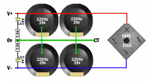

Attached below, is a functional clone of the K50 kit's power board, demonstrating the lowest cost, bare minimum, power supply. This is enough to get up and running. It can be expanded later to a proper supply by upgrading it with CRC resistors (pi filters) to improve resolution and adding larger power supply tank/reservoir to improve bass. But, here's the starter bit without those enhancements.
