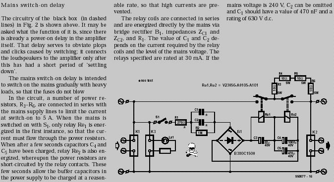

We're talking transformer ...not motors ...... so, I don't see why we need to use more than 15A switch. Example: Full load current for a 1000VA transformer is less than 10A. If we allow 75% more for in-rush current , 15A is still o.k. If it goes a lot higher than that, the circuit breaker at the electrical panel would trip before it even have a chance to destroy the switch.
Yes, there are the two factors listed above that produce huge inrush currents. I think Nelson talks about 50A and higher turn-on surges. My caps are short circuit - 88,000 uF worth. THe only
saving grace is the thermistor in the primary circuit which is about 9 ohms at turn-on. You need a big switch, the only question is whether my switch is big enough... time will tell.
BTW, the lights in my amp circuit go quite dark for a short time when I turn on the amps - the surge is quite pronounced.
Hello,
The enclosed circuit can help you with some problems that you haveing.
Also with that, you can use whatever switch you want, without any problems.
