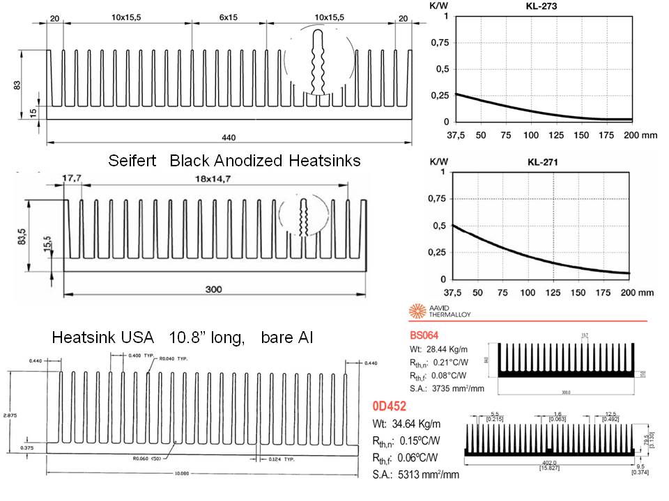

Sorry I failed to notice that your temperature measurements were in F and not C. 18C temperature variation between outputs from the heatsink mechanical design is mediocre, but adequate for proper operation. The emitter resistor attached to each output transistor should be large enough to balance current among the outputs, even with individual temperature generated current variations. Personally, I would not invest time and money in changing the heatsink on your amp. From your picture, the construction looks good for its age. The advice of removing each output transistor and replacing the thermal grease and mica insulator is a good value project.
Cheap sonic experiment…. Replace the small value feedback capacitor with a silver Mica, and make sure the feedback resistor is a high quality metal film construction. A schematic is necessary for any circuit update option discussions.
The attached figure shows some of the better modern heatsinks used for plastic TO-3P package which would likely have 3x better cooling than your amp’s ,multi-piece heatsink. The “Heatsink USA” has good value and is sold here and on eBay. If you get the urge to construct a modern DIY circuit amplifier these are cool.

Thanks, I was checking those heatsinks out earlier, as I was pondering the temperature differential in that amp.
