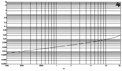

Converted it to jpg.

If we assume that the 588 jfets is for one channel in push-pull setup and unbalanced mode, driving into 8ohm load, then at 1W RMS each jfet will be driving a +/- 0.85mA (1.7mA pp) of load.
And it will be at 8Vpp.
Comparing with THD measurement of B1 buffer, this thousand JFET amp's performance seems to be too good.
The only explaination that I can think of is that the symmetrical output stage help to significantly cancel of the distortion.
Or else there could be some intellegent design in it, which I can't wait to see more details.
