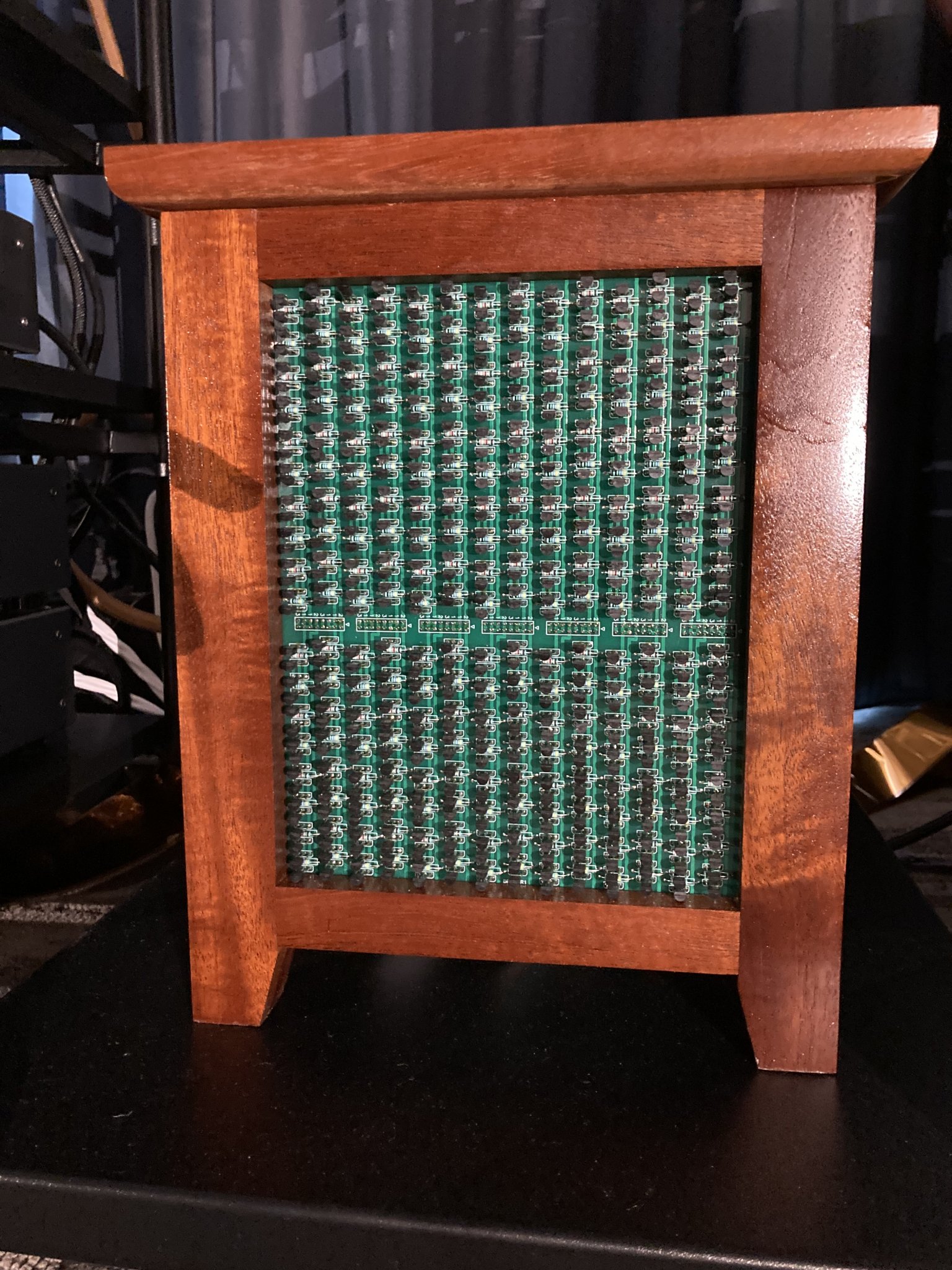

Below is a higher resolution picture of the new Beast of a thousand JFETS. The new Beast uses the Fairchild J113 JFETS. As configured, the Beast can supply 20 watts into 8 ohms with balanced inputs.

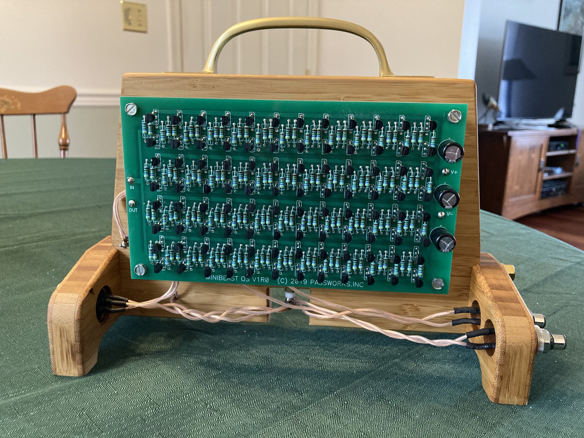

Nelson has made smaller versions called the mini-beast and micro-beast. Nelson gave me a 48 JFET Mico-Beast which I use as a headphone amplifier. It provides about a watt into 32 ohms with a single-ended inputs. See below.
