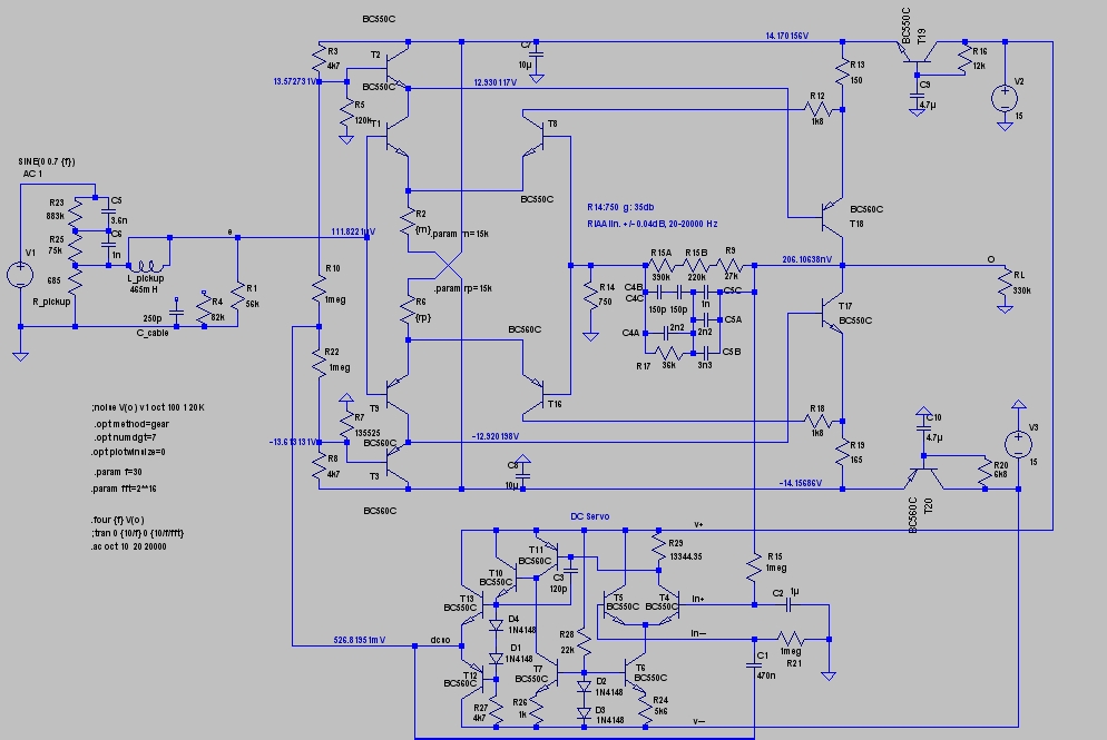

I tried different OpAmps lying around here as a DC servo.
From the "vintage parts box": ua741 (metal TO-39) and TBA 221.
Also OPA27 and now OP07. No significant differences in the result.
There are also OP177 and NE5534 that I could put in for a test.
...probably they are all vintage....
I think in this application it makes no audible difference whether the related OPAmp is with FET or BJT.

You use FET opamp for servos so the output voltage error is small. Remember the large resistances needed for a long time constant will convert bipolar bias/offset current into definite voltage error in a servo application, or else you'll need a bulky expensive bipolar electrolytic just to keep the resistor smaller.
You are right about that but I chose to have cascodes which eliminates the extra capacitance.Don't forget Miller capacitance!

Actually, I don't like using an OpAmp as a DC servo in this case, I think it somehow contradicts this 1982 preamplifier concept, which originally only used BC550/560 transistors that were cheap and easy to get.
If I use OpAmps, I should use them for the MD preamp itself, which makes more sense.
IMO.
So I tried to do the whole thing with BC550/560 only, including DC servo.
The simulation works quite well. Now I have to build it soon to see if it really works.
Any opinions?

Weren't T2 and T3 originally current sources rather than voltage followers? With voltage followers, the main amplifier is essentially a pair of differential pairs with folded cascodes. I wonder how much loop gain is left with this set-up.
The bias current of T12 and T13 seems rather unpredictable to me, as it depends on the matching between unequal devices. Why not add an extra diode and emitter resistors, making it a class-A servo amp?
By which standard, please? Is there any evidence?...much better are two step, phase stable amplification with passive filter between.

there's no low noise phono with such high impedance riaa network into a bipolar transistor base...So I tried to do the whole thing with BC550/560 only, including DC servo.
Any opinions?
With 2SA970/2SC2240 is living easy, especially on drivers with higher voltage and direct usage without reductors.
Also more obsolete. Any you can find is fake.
