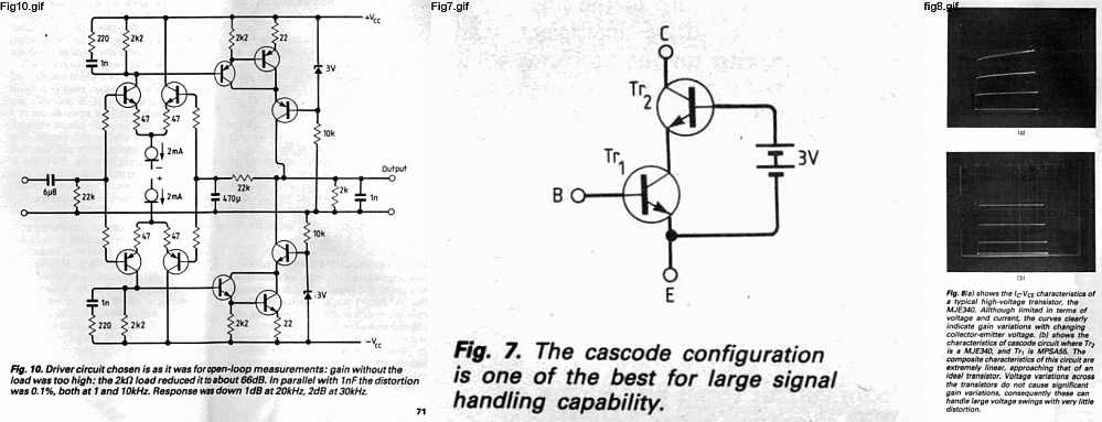

I've seen that WW paper and it is something of a puzzle.
Erno shows in one figure the composite "Hawksford-style" cascode as a "floating" circuit with a battery and two transistors. The output collector is labeled C, the input base B, and the bottom emitter and end of battery E. Then as Walt mentions, he shows the improved performance of cascode versus non-cascode. But he does not show the overall circuit upon which the curve tracer photos are based.
Then he builds his driver stage and then complete power amplifier, and the outputs of conventional two-Q emitter-ballasted darlingtons are cascaded into common-base stages, but with the CB bases referenced via diodes to the rails, NOT to the darlington emitter R's.
So this leads one to suppose that he did not have Hawksford-style enhancement in mind to begin with.

Erno's use of the driven cascode predates Hawksford, by 5 years. Strange that Hawksford wouldn't have referenced Erno, but who knows? Plus, it may be confusing to some read about a "Hawksford-style enhancement", that, in 1983, had not yet appeared.
Let's give Erno the credit due for establishing the point through graphical measurements that this type of cascode does indeed lower distortion.... even if it didn't get used in his final implementation of the PL and PCB.

My interpretation of what Erno tested for the curves of Fig. 8b is a composite as per his Fig. 7. This what we have been discussing.
Nelson Pass said earlier that cascodes such as this have been around for some time, and I'd echo that. They are treated within Evans' book in a small signal context: Arthur D. Evans, Designing With Field-Effect Transistors, McGraw-Hill, ISBN 0-07-057449-9, 1981. This book references original work by Jim Sherwin, which goes back to the 1970's.
Which brings us back to the germane question, when was such a cascode, shown to be superior for large signal audio power amp applications, first used as such? Perhaps Nelson Pass could help here, I don't know without some research.

I guess the question still in my mind is---does figure 7 imply that the "E" of the composite device is working in a circuit that has at least some impedance in that composite emitter? Since when "applied" in the amplifier schematics we see only the standard cascode, with no second device feedback a la Baxandall and variants, I wonder.
After all, the two sets of curves could be generated with no impedance in the emitter, and still show the improvement as documented in the scope photos.

I have now studied the article, and see no puzzle. Instead I see that Borbely in fig 7 shows a driven cascode and in fig 8 shows how linear this cascode becomes.
However, in his final power amplifier design, Borbely does not use a driven cascode but a normal telescopic cascode referenced to GND.
Attached are the three figures.

But...with no load or reference shown for the composite emitter in Fig. 7---that could still be thought of as referenced to common, rather than some resistance to common (or supply rail).
If no resistor, no driven cascode. Not clear to me anyway (as one guy I know would say at that statement, "That's easy for you to say").

I remember a very early article from Baxandall where he showed this 'super pair' but named it 'the Liniac' for linear AC amplifier. I think it was in Wireless World.
jd
jd, you may be recalling John Linsley Hood's article in WW about integrated Darlingtons, his point being that the IC realization allowed appropriately smaller geometry transistors for the input device. This is not the super-pair topology, and having seen the original article recently I don't recall it there.
See for example: A Paul Kemble web page - John Linsley Hood preamp designs.
Brad
Brad
- Baxandall Super Pair
