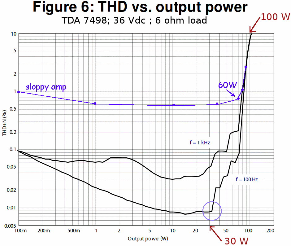

...To me, the honest power rating is the point at which you see the THD curve abruptly kick up....
That's a very perfectionist point of view.
Do you really hear 0.01% rise to 0.02%? I say no.
In fact, from decades of 'professional' observation of real listeners, several % distortion often goes unremarked.
And in many situations, a system is "not loud" unless it is run past 5% THD. They were sometimes as happy with 10W as 100W, as long as they got the obvious "loud" from distortion.
10% is of course generous to the Marketing Dept. 5% primarily 2nd (naked SE triode amp) is really inaudible. 3% 3rd (naked P-P triode) doesn't really sour the music. The more complex distortions of high NFB amps do deserve lower THD numbers for the most critical listeners. BUT if a listener is THAT critical s/he should buy an amp so big that it never gets near clipping or high THD. (Ah, but battery size/cost/runtime set very strict limits on "so big".)
Also: your "abrupt kick-up" gives a heavy advantage to un-clean amplifiers. That "clipping rise" is very nearly the same for any modern amp: just clipping. However if a sloppy amp does 1% at best (rarely audible) before it rises, it will earn a higher "honest Gnobuddy" rating than an amp which gets down to 0.01% before the clipping-rise.
Possibly. Maybe you just discovered something about my personality. :)
I disagree. Unclean amplifiers are unclean because of low (or no) negative feedback; they never show the abrupt "hockey-stick" bend from a nearly horizontal THD vs power curve, to a nearly vertical one.

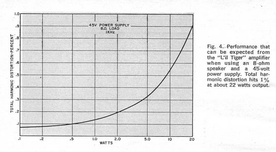

As an example, Printer2 has posted THD vs power curves for a 51 year old (1967) SS class B power amp design called the Lil Tiger a few times. I'm attaching the relevant graph to this post as well. Negative feedback is low by modern standards, because of the limited open-loop voltage gain of the design - and the result is a THD curve with no abrupt knee in it at all. It just curves smoothly upwards.
So, power at the onset of clipping, or power at 10%? In a way it comes down to which form of unfairness you prefer: be unfair to the excellent low-THD abilities of the amplifier, and so advertise the 10% THD power output? Or be unfair to the maximum possible amount of extremely dirty power that can be squeezed out, and instead be fair to the excellent low THD performance the amplifier is capable of if you turn it down just a couple of dB?
Class AB not B.

Class AB not B.
This is one of those debatable things. If you provide zero bias to a complimentary symmetry transistor output stage, it actually operates in class C, since it remains cut off till the input swings to roughly +/- one Vbe of the output devices.
So if you now bias it to just eliminate the dead spot in the output, technically you have just achieved class B operation.
Ideally you adjust bias for nearly uniform summed transconductance throughout the crossover region, and that usually involves a few mA of quiescent current - in devices that will be flowing several amps of peak current at full output. If the bias current is 2% of the peak current, (and the output devices are therefore conducting over, say, 185 degrees instead of exactly 180 degrees), is it class B, or AB?
Things are very different for the usual valve class AB output, where the quiescent bias current is as much as 70% of the peak current. Now there is no doubt at all that operation is class A at low power, shifting to class AB near full output power.
Before the audiophools got in the act and started worshiping class A, every audio electronics textbook or design book I read called the typical push-pull solid-state output stage - biased to just minimise crossover distortion - class B. Now people call them class AB, the implication presumably being "not as good as class A".
I'm not emotionally attached to either term, but to me, "class B" is a lot closer to the engineering reality when the device only conducts for the barest whisker more than 180 degrees of a cycle.

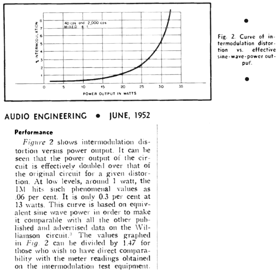

What is your rating of the 1952 Hafler-Keros? 1W? 13W? 19W? 29W?
Three thousand Jumbo Watts. With fries.
The '52 Hafler-Keros curve looks a lot like the '67 Lil Tiger one as far as overall shape goes. The signature of relatively low negative feedback designs.
-Gnobuddy

So I think that the main objective here is to AVOID any clipping in our little Class-D battery-powered amplifiers because it sounds so bad. How is this done simply and effectively? Is a pair of Zener diodes in the input enough to eliminate the awful Class-D clipping? Or is there another circuit that can be used?

Class-D clipping looks awful on the scope due to hi-frequency artefacts - that are above the audible frequency band.
But what you see is not what you hear. So I generally would not call it sounding awful per se.
