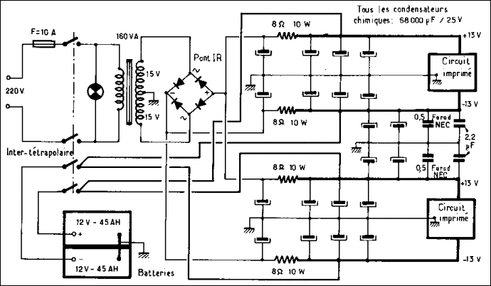

Must be something better priced, we could build.
here a schematic
what do you think about it?
i wonder about that schematic. when it`s switched on, there should be the ripple of the mains over the battery supply.
i think when the batteries supply the amp, the mains should not be connected to the battery.??!!!
Ralf

show us other/better psu schematics....
regards,
Ralf
