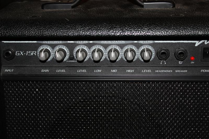

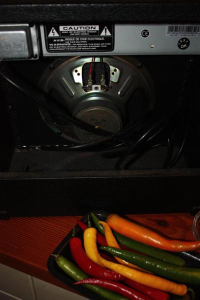

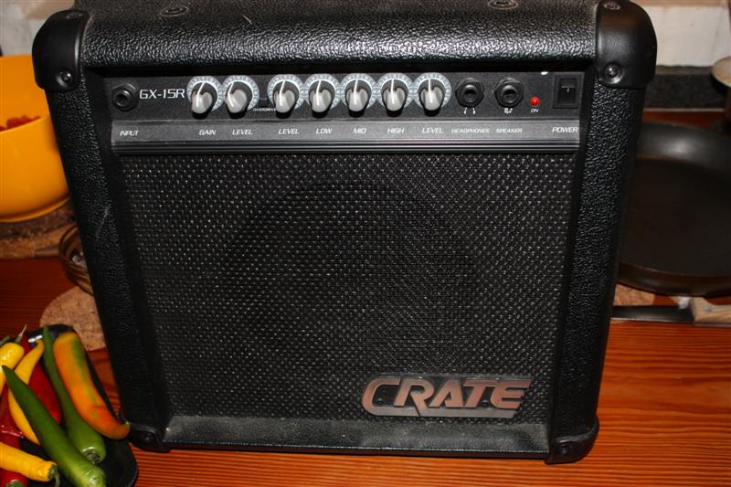

But it does have output for exstern speaker, which could be a nice woofer :scratch2:

Handy. Looks like a guitar amp though...
I expect that switching off the internal speaker when you add extra would be a good feature...
I put 2x 1/4" jack sockets on the back of my combo, and soldered a plug onto the onboard speaker. That way, I can choose to unplug the internal speaker, and power 2 external cabinets. You can get so much more volume that way.

ahh, no problem
you seem to have overlooked that I will use extern woofer
"onboard" guitar speaker will be used as midrange/tweeter only
maybe crossed around 1khz or so
I could aslo completely disconnect onboard speaker
and connect a tweeter compression driver/horn instead
lots of options :rolleyes:
but will such small 15watt guitar amp manage to drive a 15" pro woofer :confused:

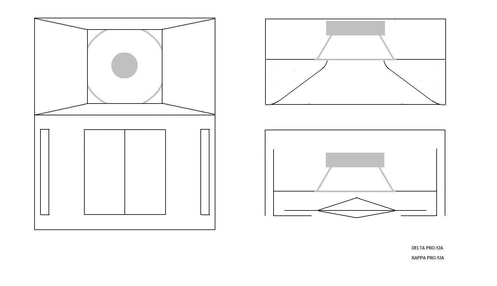

I have done some more calculations, especially on front port on low woofer
and it all fits very nicely :rolleyes:
low tuning is around 40hz in 80liter
front 20-30liter and 2 slot ports of 20mm x 100mm, gives upper 105hz roll off
and according to calculation upper midwoofer roll off around 100hz in 15liter closed

Still, looks cool.
Thanks Chris
Calculation says 115db+, within linear 4-5mm Xmax limit of both drivers, down to 40-45hz
But you are right, about a filter
if used professionally I would make it fully active, with DSP eq
But it probably never leave my "living room" :D
and if building two of them with additional tweeter/horn, it could also be used for party, everyday musik, PA, DJ, etc
sure, for bass guitar only, one driver in a much smaller box would do fine
but I expect this bigger design will have much more "volume", a bigger sound

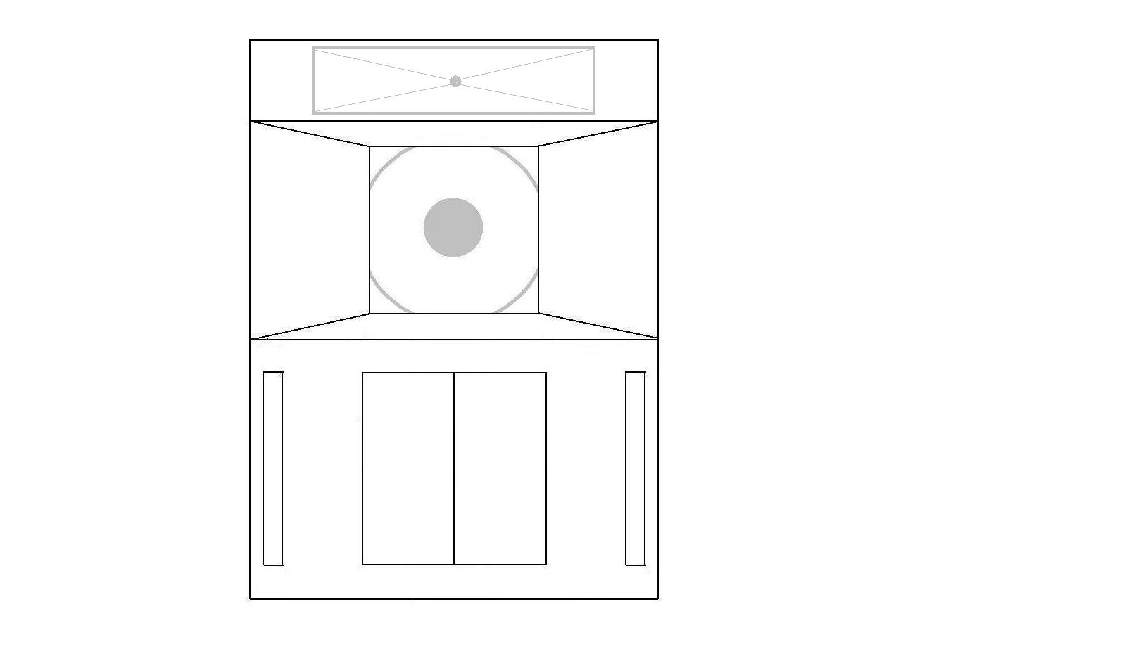

I think making this into a PA would be a good idea. Here's an idea. Instead of the Delta 12, use a Beta 12CX, as you'll be able to get a point-source mid-high, instead of a tweeter sat on top.
Chris
Ex-Moderator R.I.P.
Joined 2005
yes, I have thought about it, using Beyma 12XANd, but cost is higher
older Beyma 12XC30 is cheaper
10" 10XC25 might work too
raised cost's may not be more than with addditional tweeter
anyway, someone posted something like ..... believe me, you dont want very high frequency for bass guitar
I dont know, maybe it becomes a bit sensible to string noise, distortion, etc, and gets more difficult to play
maybe less good for home hifi, but for PA it ought to work with a couple of slot tweeters or piezos
mounted in upper waveguide horn baffles
with a switch, and adjustable att, and still only xo on tweeter
a more hifi quality oriented version would need additional horn on top, and proper 2way xo, crossed much lower
