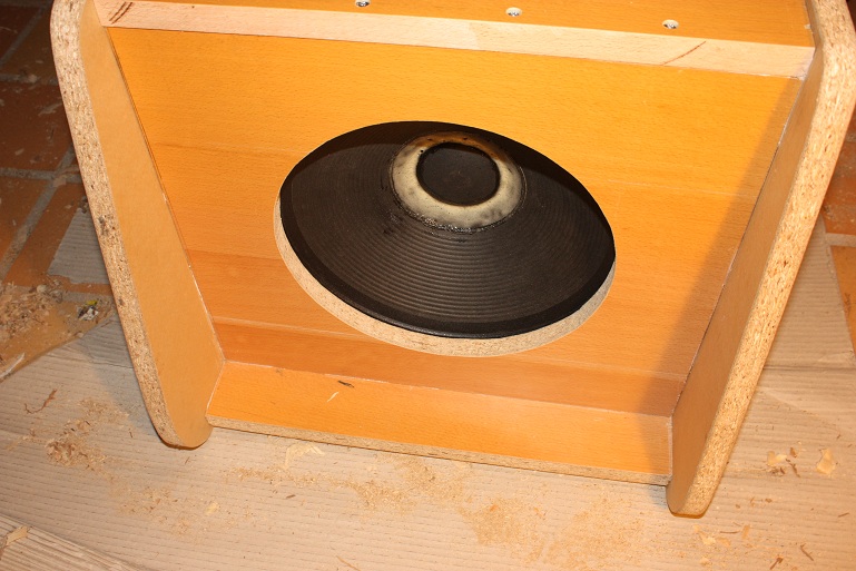

I had to put it back in my big midhorn
just to hear how its changed
and its changed
the 'signature' is still there
but its now much less 'ressonant'
cleaner, and more homogene
it apparently aslo means a less output
feels much easier to play now
with nicer tone, and more natural
thats the most important thing
and what I was hoping fore

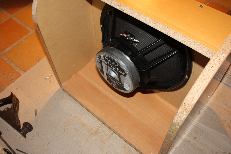

the wood)wings) rings like a bell
very annoying
cut off some wood
and it definately helped
next is to add bracing/reinforcement wood, vibration control
so far it works ok
playing solo its not so good
but it integrates well with the music
tho not very loud

ok, ressonance control it is then
but most important to me is, I can now play/practice again, without severe tinnitus attacks
not yet fullly there, but its going in the right direction
and this only one step on the way
with designing/constructing a bass cab, there are many issues I did not expect
have to admit, I still know very little about this
and I now understand why its not so easy to design good commercial bass cabs
definately not simple or straight forward

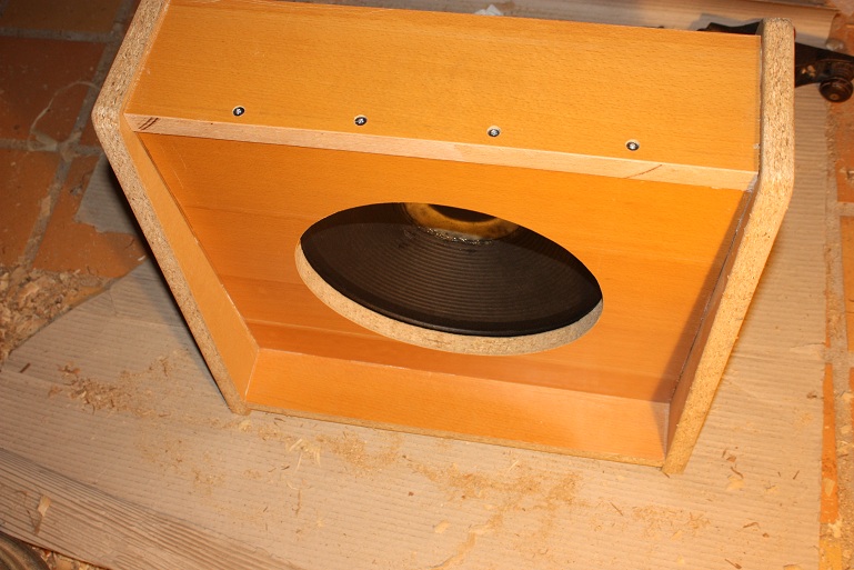

lows are ok, and clean
with that little touch of 'gnarly' tone I happen to like
but theres simply too much 'midrange', giving a 'canny' sound
I have noticed this 'canny sound' tendency before, when adding that gnarly tone with amp electronics
but obviously some of the 'can-sound' now comes from the wood/construction
and also, the woofer will most likely need a bit of coating
no doubt, this woofer cone is light, and stiff
might do a better job as guitar speaker
i have my doubts with open baffle speaker for bass
if open back design....18" would most likely be better
