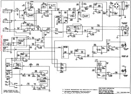

If you can post a link to a schematic, we'd be able to be more helpful. Google didn't turn one up.
Ill retouch the solder joints on the preamp board, then the other sections and test as I go. I wont give up on this baby. She didnt work at all when I bought her for 250. Had to replace the speakers and some fuses/fuse holders.
this is a simple issue, thats my feeling anyways.:)
Cant upload the pdf as its too big a file size.

Check the pre-amp voltages. there should be +/- 15VDC for the preamp. If one side measures 7.5Vdc then look at the power supply board. SWR uses a pair of 7.5V zener diodes in series with a paralleled pair of 5 watt resistors to drop the +/- 70Vdc from the output stage down to +/- 15vdc in most of there amps. the 5 watters in parallel have about 7.5 watts across them. the leads of the resistors are twisted together get HOT real HOT and they will melt the solder right out of the joint causing one resistor to disconnect. when this happens, the preamp voltage on that side drops to 7.5Vdc about and will cause the pre-amp to oscillate driving the output stage to full power oscillation! Its a nasty problem. and it common to all pre fender models.

Hi guys! I'm just a neewbie in this forum so first of all I would like to say HELLO to everyone! I was lurking this forum for a long time, this place is a great source of knowledege for sure.
I found this topic while I was looking for a SWR redhead schematic, and up till now the one posted by Chicago_Mike is the best i found.. too bad is so small that I can't read it :(
could you please let me know where can I find a bigger version of this schematic?
thank you in advance to all you wisemen!;)
PS: sorry, my english is awful :dead:
You might try with the nice people at Fender, they will send you the
schematics for free, at least if you're doing a repair or mod. I don't
know what they say if you tell them you're building from scratch...
The pre-Fender SM400 schematics are on the web,
http://www.freeinfosociety.com/electronics/schempage.php?cat=1
The PA circuitry should be the same as the 350, and the preamp at
least similar I guess.
