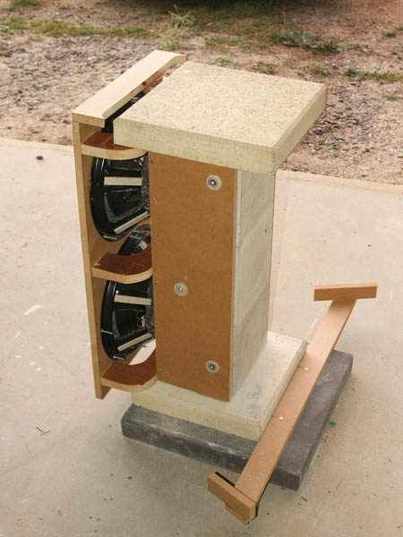

Hi LineArray
Here is a pic of the woofer mounting, note the following.
The woofer is glued by the magnet into the assembly and mounted at the front also, it is for all intents and purposes a homogenous construction.
The assembly is isolated from the concrete block column by heavy felt pads with just enough give to absorb vibration without driving it into the column.

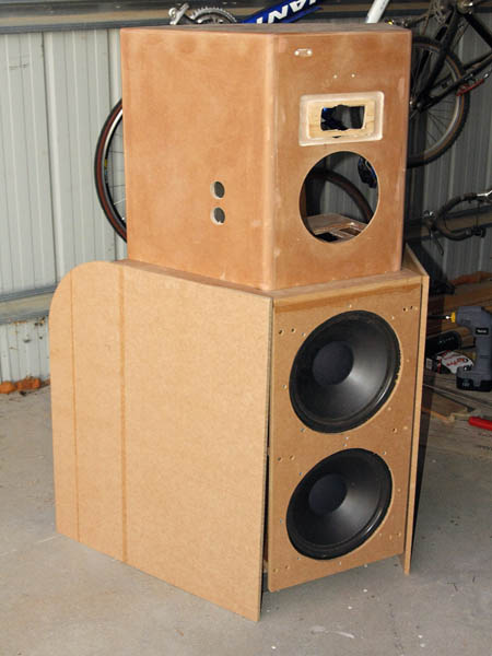

Just for a little perspective here is a pic of how the top baffle locates and with one of the bass baffle wings leaning against the structure.
Obviously these are very large speakers, fortunately I have my own dedicated listening room so WAF is not a problem.
