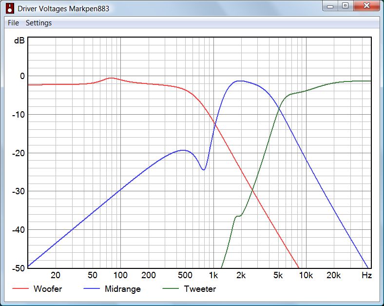

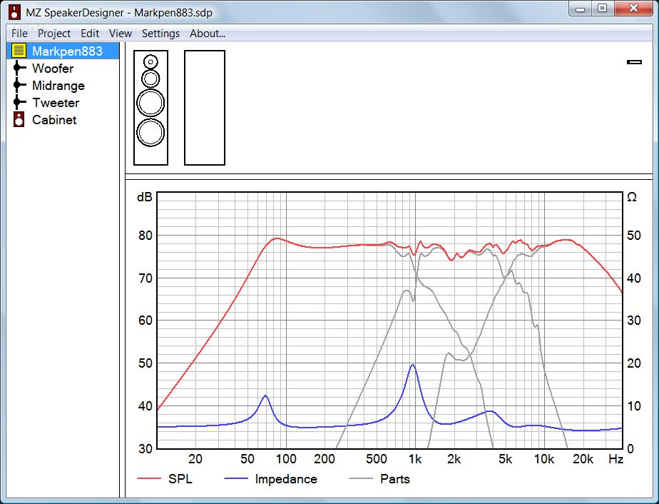

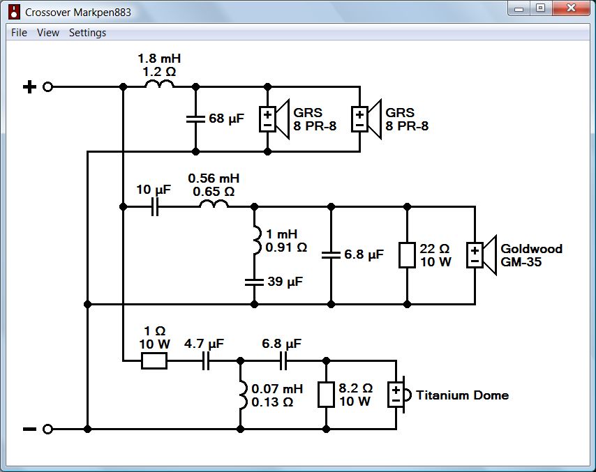

These sealed midrange drivers have a terrible resonance peak, which has to be equalized in the crossover by all means, otherwise the result is not be very pleasant indeed.
There are many unknowns in this speaker project, which make a proper crossover design difficult. Nevertheless I do attach a possible solution. It's as best I could and shouldn't be completely wrong IMO.:)
