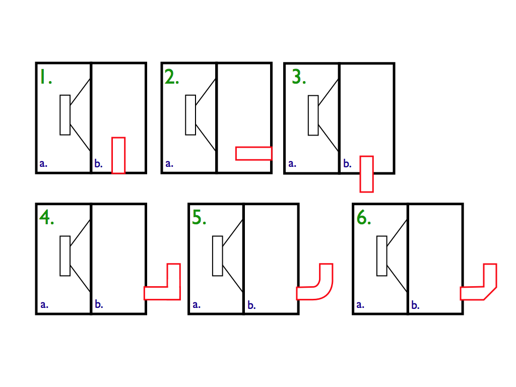

I drafted several different bandpass enclosure designs. However, I'm not sure if all the variations can be successfully implemented. Hopefully the resident experts can chime in and offer feedback.
Consider design #1. Typical bandpass. Nothing unusual here.
Consider design #2. What happens if the tuning port (red) is placed parallel to the plane of the driver? Does the tuning port have to be perpendicular to the mounting plane of the driver?
Consider design #3. Can the port be extended out of the box? If so, do the volumes of chambers a. or b. change? Does the tuning port change in length or diameter?
Consider design #4-6. Can the tuning port be routed? If so, which design would be optimal of #4-#6? I'm guessing #6 is ideal.
In my application, I am considering a bandpass enclosure for midbass (50-250). Would a bandbass enclosure cover ~2.25 octaves?
Thanks in advance!

They all will work. #4 will have a lower tuning than #6 if the lengths are exactly the same. I would angle the inside of the port on #6 too. Regarding #2, you want more than the port's diameter between the speaker plate and the rear of the port. Regarding #3, technically the vollume of b. should be made smaller. You might be able to design a front loaded horn to go from 50-250hz with Hornresp. The box will probably be big if you want a -3 to 0 db @ 50hz.

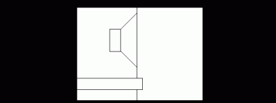

another idea> Place the port inside transversing the closed portion of the enclosure. Design the box dimensions to fit both the port length and the dual internal volumes.
Bandpass designs are really best for an octave or less when efficiency is a goal. Play with some t/s design programs to get a better idea, besides midrange sounds emiting from a port would sound a bit weird.
No
You might be able to make it slightly shorter, but the difference won't be much if the port is not a substantial fraction of the enclosure volume. The actual vented volume subtracts the volume of the port. Moving the port outside would slightly increase the volume and lower tuning very slightly.
5, the larger radius on the bend, the better
It could, but why? I think a direct radiator here would be best.

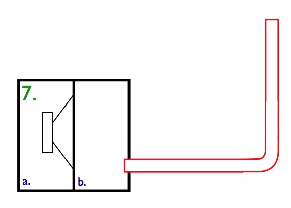

I should have been more specific. The attached file (multiplie ports are not shown) would be a better example of what would actually be implemented. However, without understanding the relationship between the port, the port volume within the enclosure, etc., I have no way of knowing if it would work. Is design #7 possible, or this the does most of the volume of the port have to be in enclosure b?
Ron E, now you understand my desire to deliver sound via the port to a specific location, can you expand? Does a substantial volume of the port have to be within enclosed chamber (enclosure "b")? If so, at what ratio (port volume within enclosure to port volume outside enclosure) does the bandpass design no longer work?

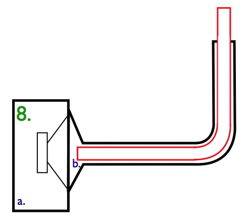

If the port(s) must be substantially within the enclosure, my idea would not work unless enclosure "b" followed the port (assuming correct volumes for the port and enclosure, of course;)). See attached design #8. Much harder to fabricate, but possible.:eek:
Are there more advanced bandbass modeling programs that I should look at that consider the actual location of the port(s) volume?

Using your idea wont the end locations mostly determine the length of tube/s then not tuning per se?
I would calculate the optimal port length and then locate the enclosure at the end. So I would let the port length determine where the enclosure could be instead of starting with the enclosure location and letting the resulting length influence the tuning. Kinda the inverse:confused:
I believe the point of Ron E's quote was that the physical volume taken up by the port isn't considered part of enclosure b's internal volume. If you remove the port from that box, the effective volume "b" has been increased, and thus Fb will decrease if port dimensions are held constant.
Do you have an estimate as to how long the ~250Hz port would need to be? Practical limitations my be a problem, it may need a very large surface area if the port length is to be very long.
None of the port has to actually exist inside enclosure "b".
You do not need to have the port inside the enclosure. Making volumes into long tubes is not a good idea, in any case. Long tubes can have organ pipe resonances at frequencies in band. http://www.physics1.howard.edu/undergraduate/Labs/GenLab1/10-resonance.pdf
Another type of organ pipe resonance, due to the port, is a major source of out of band noise in bandpass boxes. This organ pipe resonance for a port will be at F=13572/(2*L) and multiples, where L is the length of the pipe in inches. THe longer you make this pipe, the lower the frequency. To keep out of band resonances an octave away from your bandpass, you would want a port length no longer than ~13.5".
