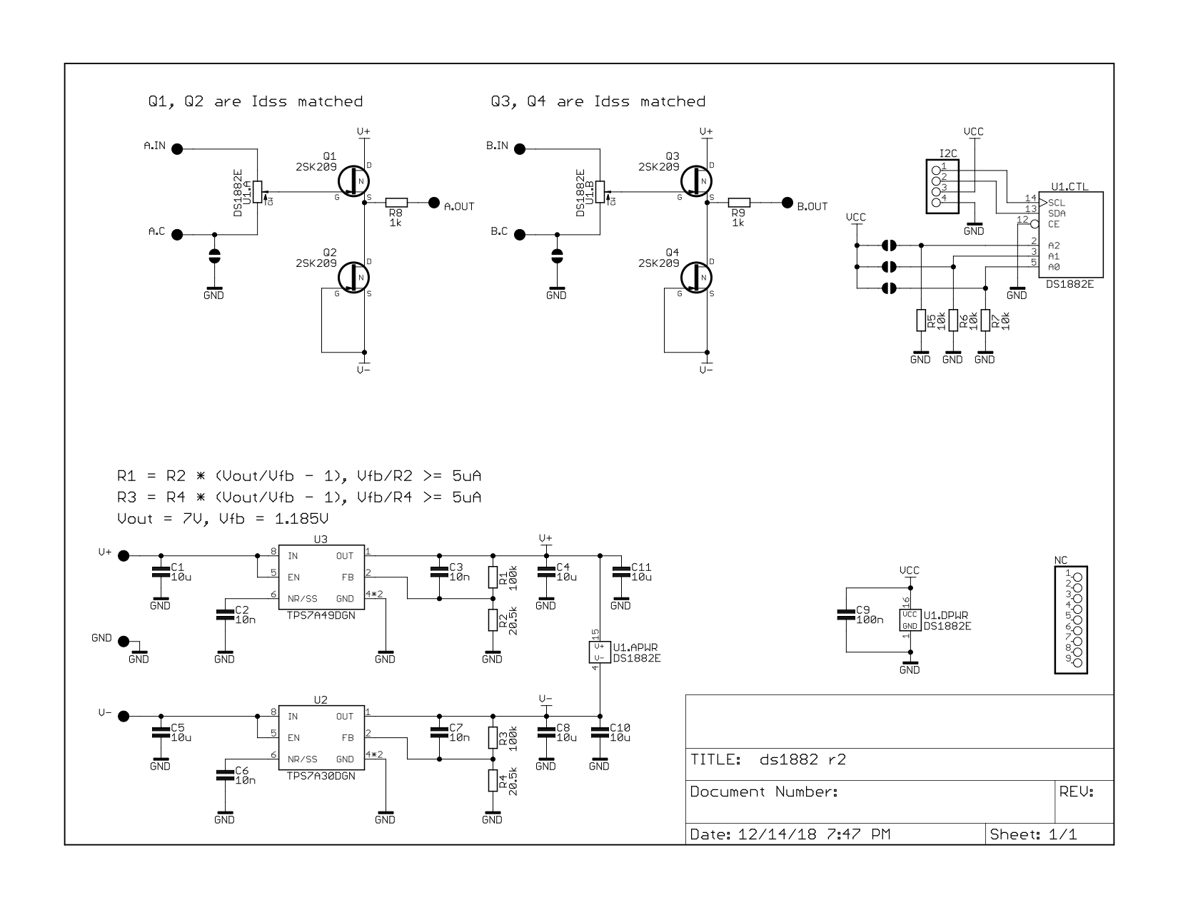

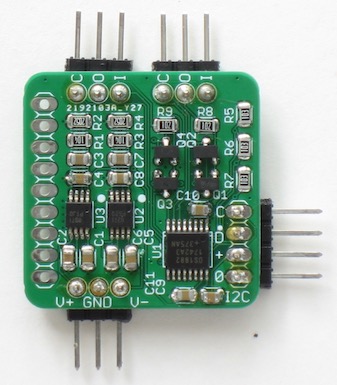

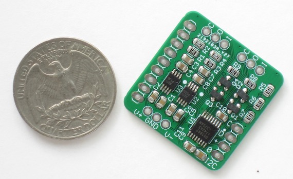

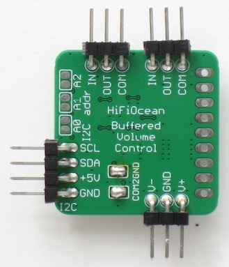

Now with the DS1882
As announced in my last post, here is one more volume controller. This one is based on the DS1882 digital pot, with the output buffered by matched JFETs, B1/Mezmerize style. The digital potentiometer, two JFET buffers and their analog power supply regulators are mounted on one 1100x1100mil (28x28mm) board.

What’s the difference, if any, between your digital pot approach and a MDAC attenuator?
I think the main difference is resolution, in theory is easier to find DACs w/ higher resolution than digital pots. But I may be wrong.
You want a log relationship between the control code and the output level in a volume control, and a digital pot does just that. MDACs, on the other hand, generally have a linear relationship between the control code and the output level. While the number of steps may be higher (e.g. 256 in a 8-bit DAC vs. 64 in the DS1882), in terms of perceived volume these steps are more coarse at the low end, where you want them fine, and fine at the high end, where you don't need that. One can try to correct that in software, but it would reduce the effective resolution and increase complexity. There was an interesting chip, the AD7112 (see the attached datasheet), now obsolete, that did it in hardware.
Other than the resolution, the working principle of a digital pot (an R-string DAC) is different from that of an MDAC (that usually employs an R-2R ladder). You need to look at how an MDAC, a digital pot, a mechanical pot or any other control fits into your schematic. For example, a digital pot may be sensitive to loading - the reason I included a JFET buffer in the schematic above. For another example, a typical current output MDAC relies on an I/V converter, usually an opamp (again, see the attached datasheet for an example).

Joined 2009
1. I'm assuming the microcontroller (Arduino, RPi...) knows at every moment not only the position of the encoder, which is sent to the pot, but also the attenuation generated by the pot (ie volume in dB), is that the case? I mean, I want to be able to show the real dB volume in the display.
The datasheet for WM8816 (or any other volume control chip) defines the relationship between the gain/attenuation in dB and the code that you send to the chip. Your MCU can get the input from e.g. an encoder, display the dB number, calculate the appropriate code and send it to the volume control.
2. Not really sure at all what the ±18V input signal refers to.
WM8816 is unusual in that it handles +/- 18v input with only +5v power supply. Other chips, e.g. PGA2310 or DS1882, need analog supplies, and the input signal cannot exceed those analog supplies.
3. Gain range from -111.5dB to +15.5dB. Am I understanding correctly that we can attenuate the original DAC output but also have gain? (ie like attenuating from positions 0-128 and gain from 129-256, or whatever)
WM8816 has not one but two digital pots for each channel. These pots work together with an external opamp to provide gain or attenuation.
4. How is the output VRMS and Zout calculated?
Output Vrms = input Vrms * 20 * log10(dB gain). There are plenty of online calculators to do the math for you, for example, this.
Zout and current drive capability will depend on the opamp you use.
