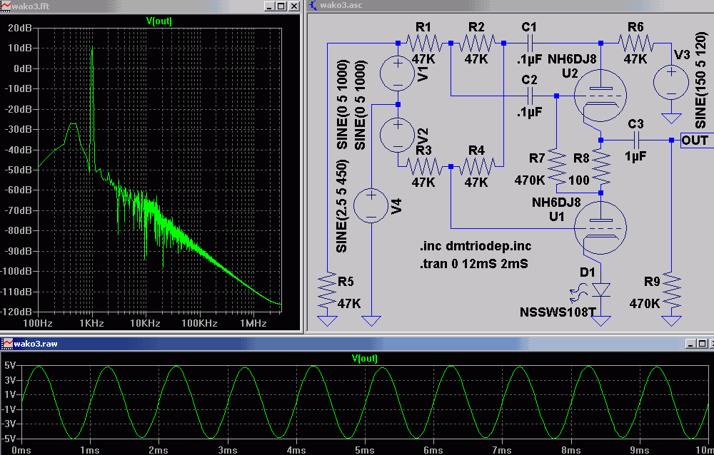

Thanks DF,
A quick modeling in LTSpice actually helped me understand it, essentially it is a "down and dirty" way to take in the "balanced" input from the sound card. It still preserves the only real thing I was looking for and that would be to reject common mode noise injected into what might be a rather longish cable run in my rather "Noisy" listening room. (an old house with all kinds of crazy wiring in the basement.

No RIAA suggestions for you. But if you actually enjoyed puzzling out the Broskie
Cathode Follower? Here is my own competitor: Differential White Cathode Follower.
Please note this is a worst case sim with tons of common mode noise and power
supply ripple added for extra aggrivation. So, why is it none in the output???
I can smell ye olde brainwoods burning already...
+2.5VDC bias on V4 is well within common mode rejection range, so not essential.
I was tryin' to fake like a +5V DAC at the time, or quack like a duck, er whatever...
Ground referenced signals work just fine.
Not much time today...but a quick look at the schematic would indicate that "common mode" noise on the lower triode would be inverted on the plate which is tied to the grid of the upper triode cancelling it.
I assume the inverse is true at the top where the reverse happens off the upper cathode to the output?
