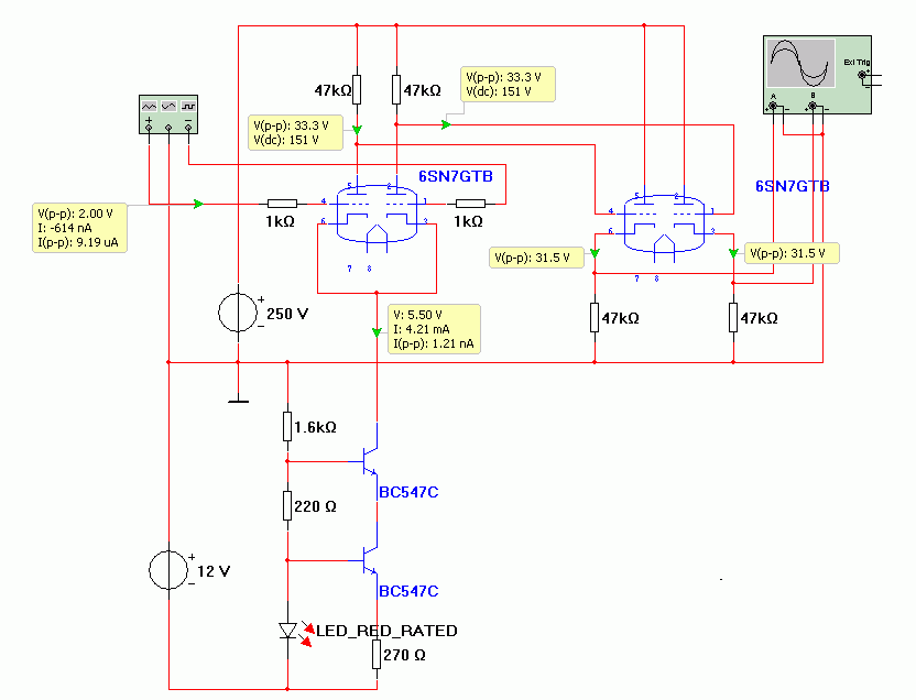

ive built this pre and Im having some trouble getting it going. At this stage I have not passed a signal through it but its connected to an amplifier and a test speaker.
It hums really badly, especially bad if its at the begining of the pot or end of the pot. The pot is a noble 50K pot.
The voltages are all fine and I have triple checked all the wiring.
Any ideas?
Just thought I would add, this is my first tube preamp.

hey-Hey!!!,
I have built a PP linestage. It uses the Russian 6C45 in LTP/diff amp with a cascode CCS in the tail. The plate load is a 20k:600/150 from the Chicago Super Range, the BO-2. It will deliver a Watt into 600 or 150 Ohms and the circuit will back it up. The 10k load presented to each triode yeilds a 5 or 6 to 1 ratio v. its plate Z, so for the balanced 600R output, I'm getting about 100R output Z. On the 150R connection, it is more like 30 Ohms. With drive like that I can put the linestage and source next door( or at least across the room )and not have to worry about losses. The amps I've built are all PP and rigged with the excellent Neutrik XLR input jacks.
So far the OPT's have been remarkably inexpensive on ebay. I have two in service and one spare to unwind and make more at some point. According to the specs both primary and secondary have balanced capacitance to ground and the winding DCR is quite well matched ( around 280 R per half primary ). If there's any interest in a pair of these, let me know as I'd like a second set; we'll start the reproduction process straight away...
cheers,
Douglas
