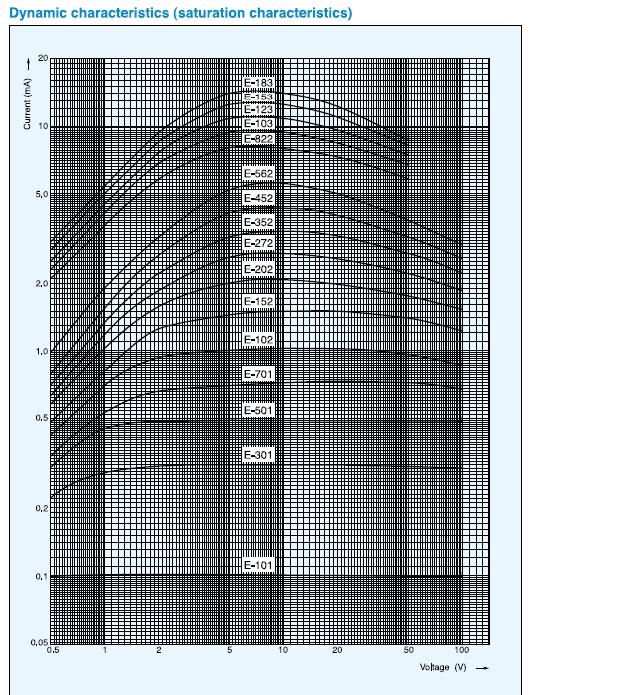

You can use a constant current diode instead of the LM317. They are also called current regulating diodes:

The DN2540 and 10M25S depletion mode MOSFETs are the preferred choices these days (SY here turned a lot of people on to those). The LM317 is a poorer performing choice, but it's cheap, ubiquitous, and really easy to work with. And since the OP wants a simple project, I thought I'd throw that in.
But the CRD's you pointed out are even easier. You want 30mA? Put two in parallel and there you are. And they're less than $3 each now.
I wonder how they perform... Anyone?

Performance depends on the current rating, with lower current values maintaining constant current over a wider voltage range than the higher current values. I am not sure about the conditions used for this test shown in the charts though. Also I think it's important to understand that when used in the tail of a long tailed pair, the voltage doesn't change a lot anyway. Here's a page about them:
http://www.centralsemi.com/product/cld/index.aspx
These curves look a lot better:
http://www.centralsemi.com/PDFs/products/ALL_SMD_CLD_curves.pdf

Looks like about 5 to 15 volts is the sweet spot. I'd want to use them with a 6SN7, 6N6P or 5687 most of the time, so I'd need to choose an operating point with a bias of about -7V to -10V, if possible. Limits their usefulness, but otherwise they would be so easy to use. Thanks again.

Yeah, what's confusing to me is that other manufacturers, including Central Semiconductor, show almost a ruler flat curve for their CLD's (CRD's) over the entire voltage range, and Semitec does not. Vishay stopped making them apparently, but someone else is making their TO-92 style device.
