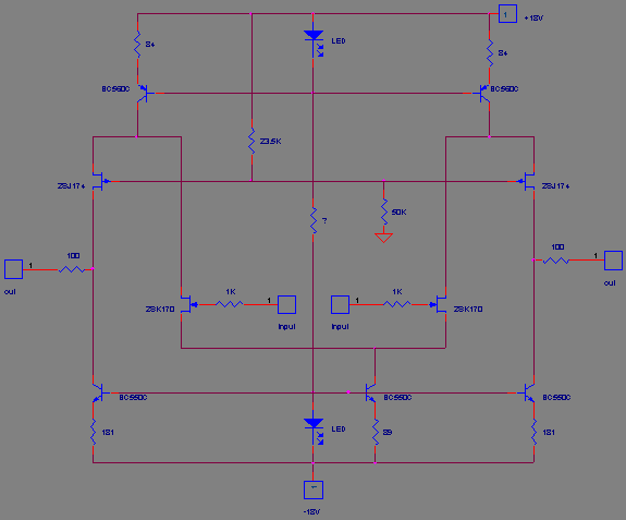

Well, I've been doing this type of amp design for a few years now. I was not much of the solid state forum member but Ive been doing that, speakers and systems on and off for my whole life. I work in the semiconductor industry during the day. There is no better tool, other than your brain, than something like Pspice or some circuit sim package. I just recently got a hold of Pspice and I have an excelent mentor, it's great. In my opinion, if your prototype is amplifying in the first 15 minutes, your pretty good at what your doing. With Pspice, your circuit is working and close to optimised, before you build it. It's not perfect, but, by the time you build it, you know the circuit very well from playing on the simulator. All the guessing is transfered into trust in the simulator and you get much more time to debug and optimize sitting at your computor. Rather than cursing at the circuit board. You get more time to listen also. A mandatory concern in this forum.
That having been said. All I have at this moment is a Schematics file. A Cadence freeware front end for Pspice. I can't seem to get it into something normal like jpg or something. I will attach it and I will try to get a real pic on here shortly. Well, It does not like .sch files... I'll redraw it in capture... Sorry
I should have said up front: THIS IS A WORK IN PROGRESS!!
Is it to the thread? Is it Balanced in? SE????? ??? All JFET?? well, the signal path at least... Line AHHH Well, Right now I think the gain is about 300. Right there it says that this guy may not be ready for this forum...ooops, Like I said, a work in progress... I have to throw away some parts and maintain the linearity, rather than use 40db of feedback... I think at about 3V out @1khz the simulated THD is .007% and -3db is 750khz+.
this is very similar to my Circlotron front end... What do you poeple think???
Well, I should have been doing something else this weekend but after all this preamp jazz, I decieded to take a look at the BOSOZ, the Aleph P 1.0 and the aleph P1.7. I mostly used the simulator and at least to begin with I looked at all three as published. I will need one soon anyway, especially one that will go SE to Bal. but I am also still on the market for ideas to drive the current design... I looked at the L also but I really need that bal drive for the amps. I have been playing with the Circlotron topology but have not settled on a drive mechanisim. I currently think a circuit like the XXX899 Pat. would do well. Similar to the one I posted without the output current source...
Anyway, my initial results(without any data here!) were something along these lines: All three will do the 25V P-P Balanced level I need. Woaa. I had never noticed that before??? Both the BOSOZ and the P1.0 are disticntly Zen in nature but can produce these high levels at less than .05%(without quoting any numbers here) Thd (from Pspice). And with really low, low level numbers, increasing steadily with higher level. Add an abundance of current sources (The Aleph P1.7) and the Thd is about an order of magnatude lower!!!
My initial conclusions: With the low distortion and great headroom these circuits have, (on the sim at least) all of them are wort the listen. My folded cascode JFET Circlotron version gets about .005%THD @ 1kHz, @ 10VP-P and .06% THD @22VP-P into 8 ohms. My initial tests using the BOSOZ as published, with the Circlotron output did a little better
Yes, very similar to what I've been experimenting with, and it looks like it wll work, but I really like the idea of the ZEN simplicity. Even what I posted has 9 devices. The 4 device solution looks more like what I was looking for though...
The BOSOZ driving the Circlotron follower seems to be shaping up better than the folded cascode, on the sim...
