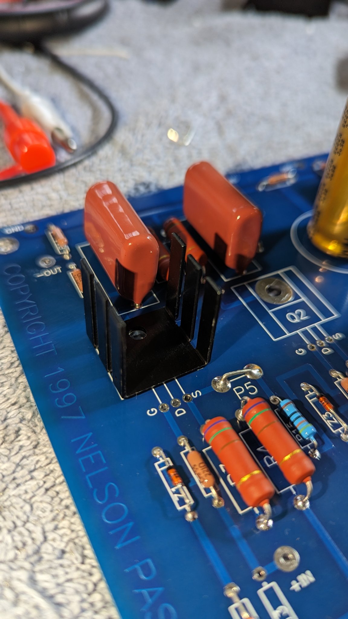

I have the BOSOZ built except for installing the MOSFETS. I've never installed one where you want electrical contact to the board via the TO-220 tab however this board is designed with the FETs laying flat and a heat sink with screw attaching the drain to the board. I assume that I would still put thermal grease between the FET and the heat sink and electrical contact would be made through the screw on the bottom of the board and the top of the tab on the TO-220. (There is no trace connecting the middle pin of the FET).
