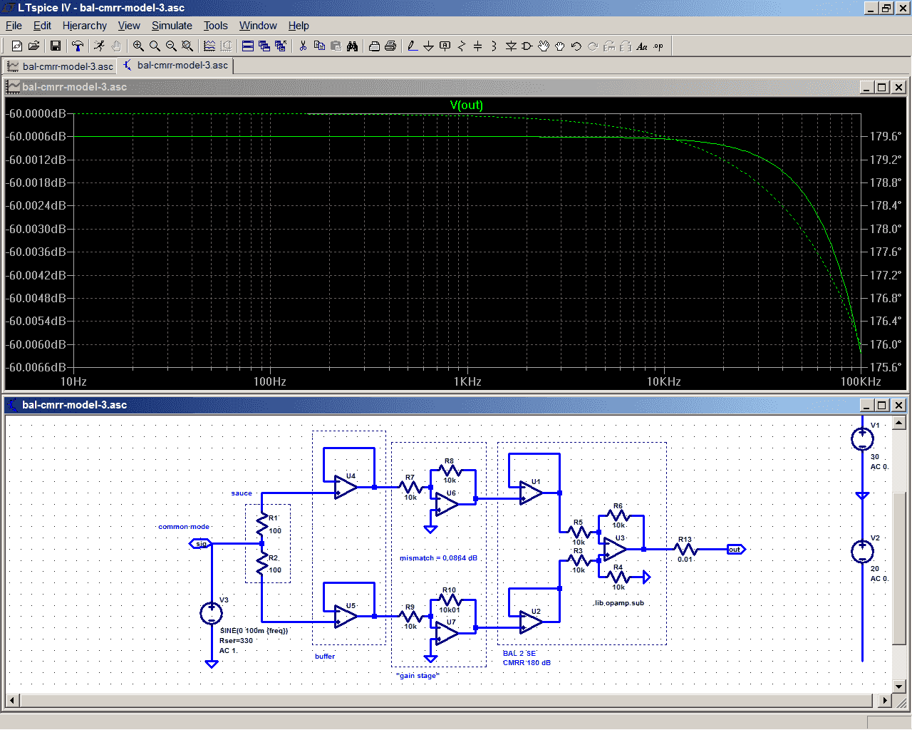

I was referring to a circuit like Bonsai's (or proposed by the OP), with single-ended buffers feeding two channels of the PGA directly. Common mode to differential mode conversion depends on channel tracking there. I haven't done the math in a while, but asking for 60 dB of CMRR (which would be a decent value for a line-level input though not SOTA) would require matching on the order of 0.1% or 0.01 dB. The part is specified for +/- 0.1 dB, no idea how good it is in real life.
Get why I'm seeing a potential problem there?

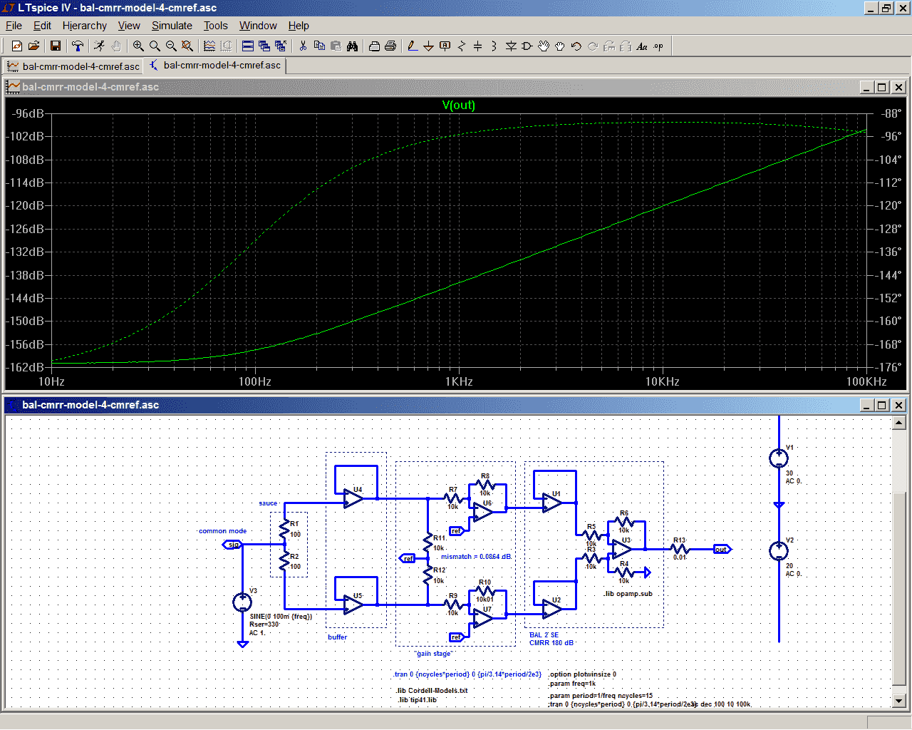

Here's a lil' sim for you guys. I placed a very slightly mismatched "gain stage" between a buffer and an ideal bal/SE converter and fed a pure common mode signal into it. If not mismatched, attenuation is 180 dB, which is to say infinite within computational accuracy.
Increase one 10k resistor by 10 ohms (+0.1%), and you get 0.864 dB of gain mismatch or a CMRR of -60 dB, both inverting and noninverting. This mismatch converts part of the CM signal to differential. (The bal/SE converter on its own has ~infinite CMRR.)

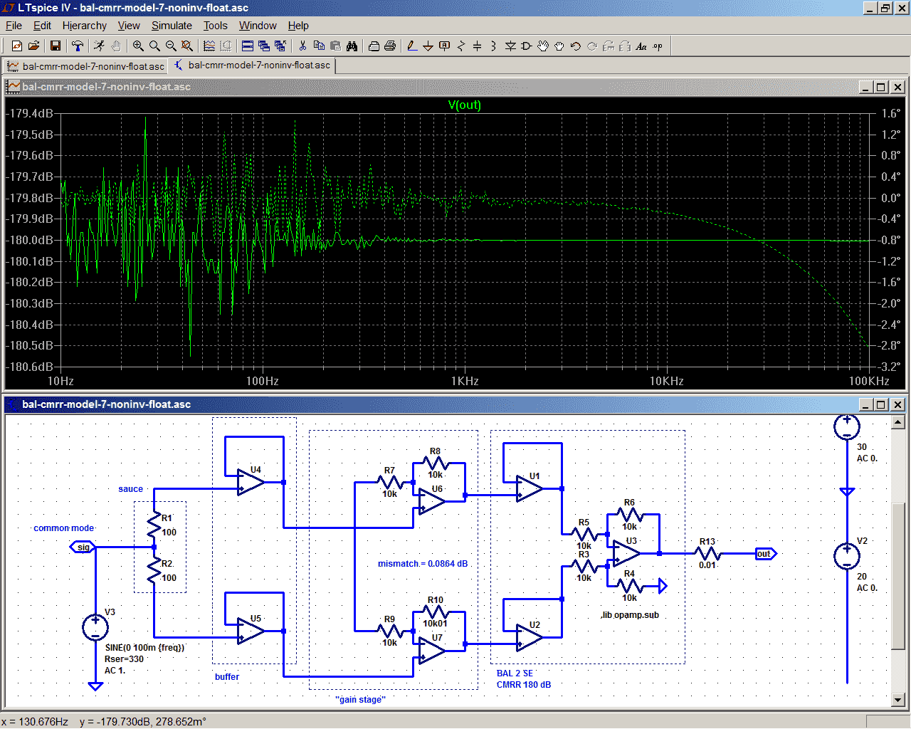

I also tried the trick of referring the gain stage to a common-mode signal, and it does work quite well, though clearly some work on part of the opamp is involved so its effectiveness diminishes towards the higher freqs (still very good though). For a noninverting type of gain stage this reference would have to be buffered. Not sure about the noise penalty.
Connecting the two noninverting amps together INA style works great though, CMRR is up to maximum possible again. Not sure whether that'll fly with a PGA, but worth a try I suppose.
