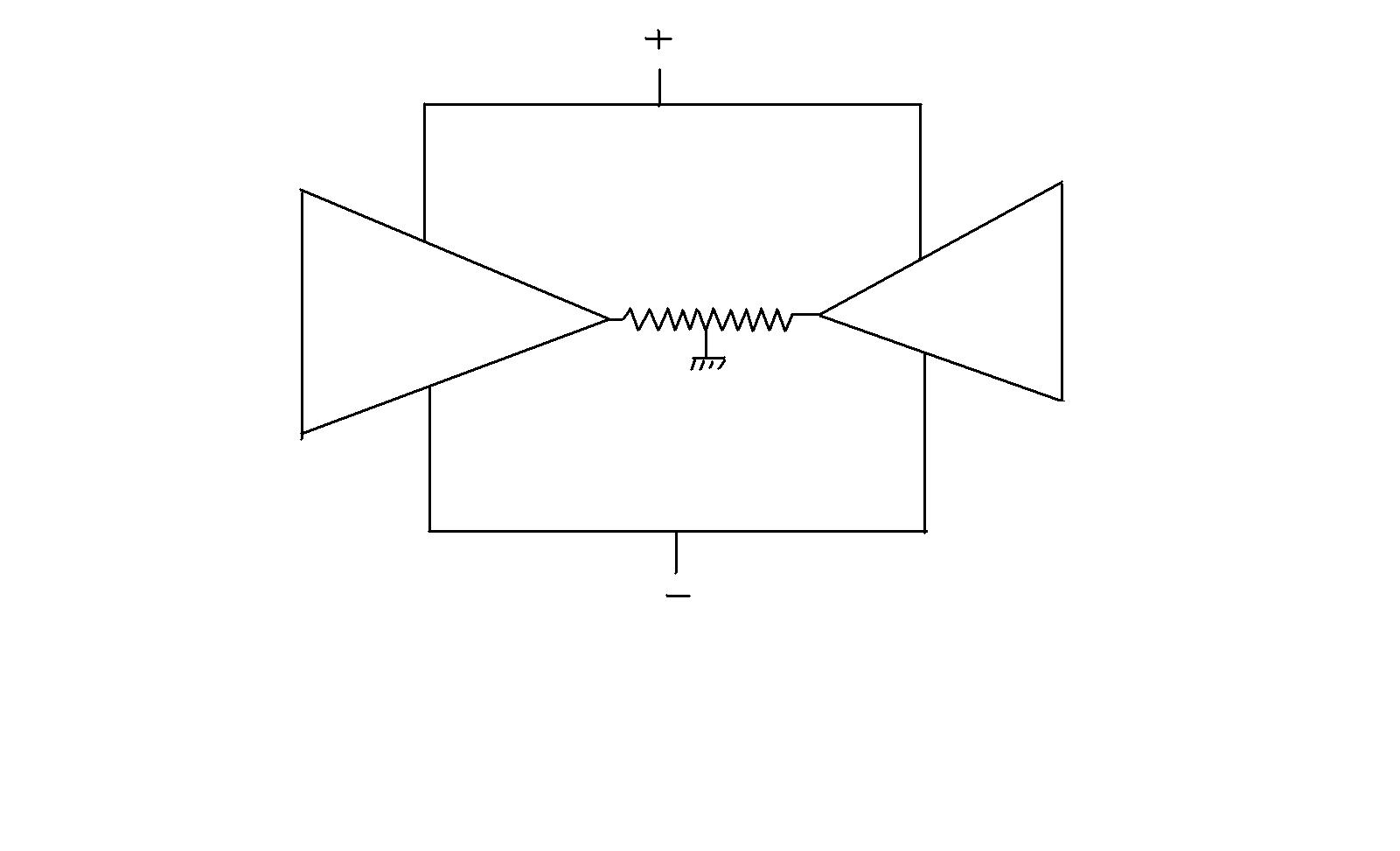

No.So you have 1 pair on each side (ie 2 pairs) which are in parallel. So simply add the currents of the parallel pairs.
So if you have 1A through each pair the total bias is 2A.
the two halves of the balanced amplifier are in series driving the common load.
That's why we get double the power into double the load impedance.
The two halves are not in parallel as far as operating like an amplifier are concerned. So you should not assume the analogy of paralleling the supply rail currents models the bias situation correctly.
Each half of the balanced (or bridged) amplifier is biased to 1.3A, i.e. 1.3A passes through the top emitter resistor down through the upper output device, carries on down through the lower output device and finally through the bottom emitter resistor.
This bias current determines the the maximum ClassA output current (2.6Apk) of the stage. The instructions tell you to bias the upper and lower devices together to maintain near zero output offset from this one half of the amplifier.
Then proceed to bias the other half, again to 1.3A. This too allows a maximum ClassA output current of 2.6Apk.
The load is in series with both halves of the amplifier and thus it is limited to 2.6Apk of ClassA current.
The sum of the two bias currents is 2.6A, the bias current is 1.3A.
Parallel and series are quite different.Take care not to confuse the two.

Forget about everything X.
Look at the supply and look at the output mosfets.
If you have 1 A going through one side and 1 A going through the other side the current drawn from the supply is 1 + 1 = 2. It can't get simpler than that

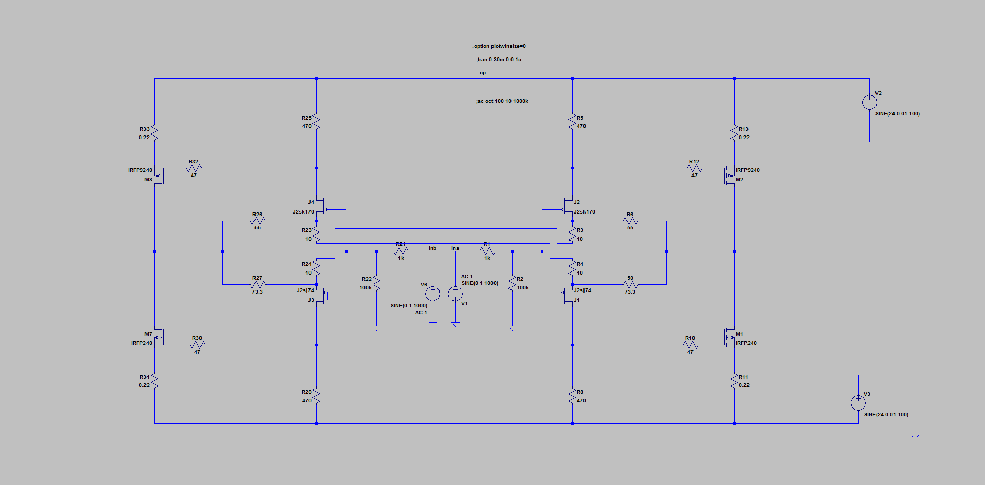

I just noticed the different values for the feedback resistors (55 & 73R) - could you direct me to where this came from? I completely missed this!
Also, does it also apply to the "normal" unbalanced cct or is specific to this balanced arrangement?
Please excuse my ignorance, here ..
