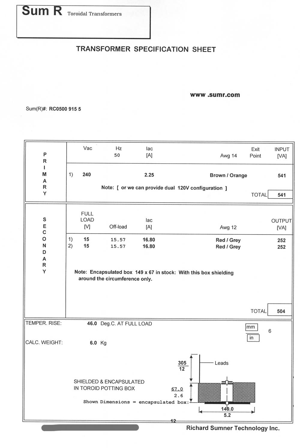

done, after I saw your post in reply to mine earlier I sent Richard an email asking if our needs were possible within the size constraints. I did not know what current rating the secondaries should be?, so omitted that, but asked for 500VA with 2 x 15vac secondaries and coreband and whether this would fit in 150 x 80mm. anything else I should add? he has been quite approachable WRT group pricing for smallish bulk buys before. will let you know what he says. I prefer potted TX personally, but thats cool, i will do that if it will fit, but did not ask for that in the quote.
we did want 2 separate 0-15 secondaries rather than a single 15-0-15 didnt we?
asked for 500VA with 2 x 15vac secondaries and coreband and whether this would fit in 150 x 80mm. anything else I should add? ..............., but did not ask for that in the quote.
that 16Aac of secondary current requires ~5sqmm of copper cross sectional area.
It is very likely that this will be a bi-fillar, or even more likely a tri-fillar winding to allow thinner wire diameter to be used.
AC Current = 500VA / (2x15) = 16.7A.
As AndrewT said, most likely bifilar (i.e. in effect 4 secondaries wired as 2x 2 in parallel).

sumR spec
well as usual Richard got back to me surprisingly quickly
attachment.php
and there are 2 other boxes he can order in if we find them more suitable
Here is a design. As you know, we can alter it to your needs.
I have listed the toroid box in stock. There are two others I would have to order if preferable;
a) 149 x 82.5
b) 152 x 75.
These are a bit larger and allow shielding on the top & the sides.
i'll have a quote later today I have also asked for info without a box, just with mounting hardware
i'm definitely keen on the case, but I do want to see it first, not to judge its quality, that is beyond doubt, just whether or not it is suitable for myself personally for this build. love the sound of the suspension
