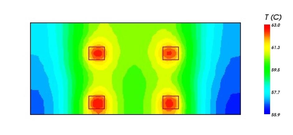

I did some thermal simulation today to see how far we can optimise the heat source positions.
This is the first (well optimised) result.
You should not look at the absolute values, as I used 25°C ambient.
The exercise is aimed at minimise temperature variations over the heat sink area.
So you should look at the difference between max and min, and compared those to thanh's experiment.
As you can see, by clever heat source placement, you can get the temperature difference down from dT = 20°C to dT = 7°C.
(The relative positions of the MOSFETS are as per F5X PCB.)

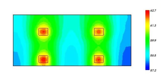

What if we put the MOSFETs wider apart across the width, say by another 40mm ?
As you can see, only very slight improvement, especially to Tmax. So we are already very near to the optimum.
As I already mentioned, the geometry of the fins is such that increasing height to 200mm brings very little improvement, but jacks up costs by some 30%.
So if you want to dissipate more, you need a wider sink, which makes heat spreading with 4 MOSFETs even more of a compromise (to the PCB layout).

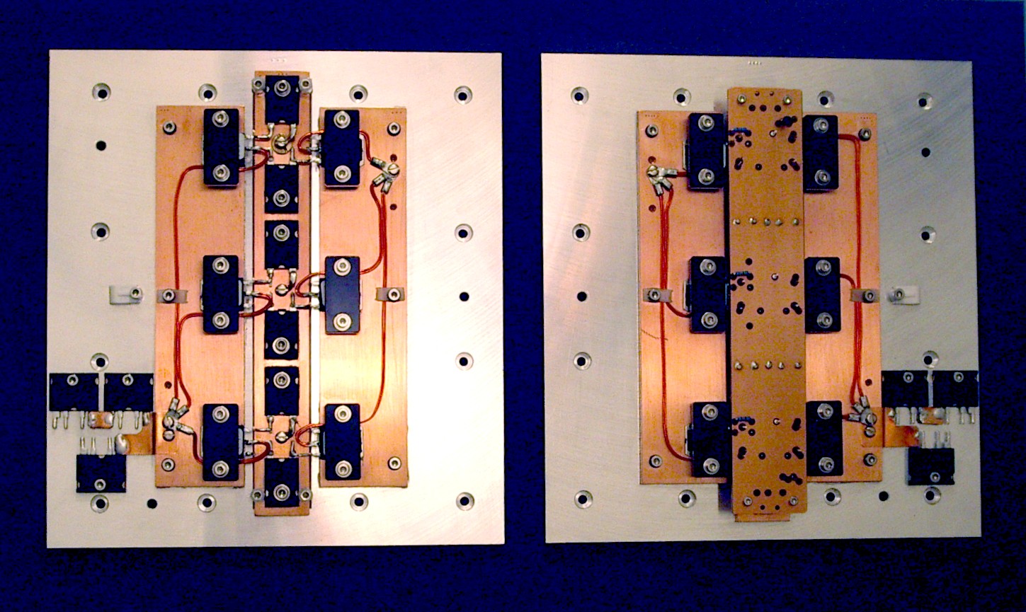

I show you one example of the use of heat spreader -- my 7 year-old AXJ100 design.
There are two levels of heat spreaders -- a 12mm thick aluminium plate 230x200mm, and copper busbars 4mm thick x 40mm wide. 0.5mm Aluminium oxide insulators between aluminium and copper with aavid Ultrastick both sides. The MOSFETs are thermally and electrically coupled to the copper by conductive silver grease.
You can think about the cost and whether this is what you want to do.
This will not be the default solution I offer for the F5X.

Someone asked by PM what if we solder the MOSFET to a larger piece of copper.
While I cannot entertain all wishes for endless simulations, which cost both time and money, I will do this one particular one, just to end the discussion.
You can see that under same conditions except for a larger heat source size (50x40mm), and renew optimised heat source postions but maintaining the F5X layout, the gain on Tmax is an entire 1.5°C.
40 Bucks for 1.5°C can only be good for psychology, does nothing to improvement MOSFET lifetime, which does not need any improvement in the first place, IMHO.
