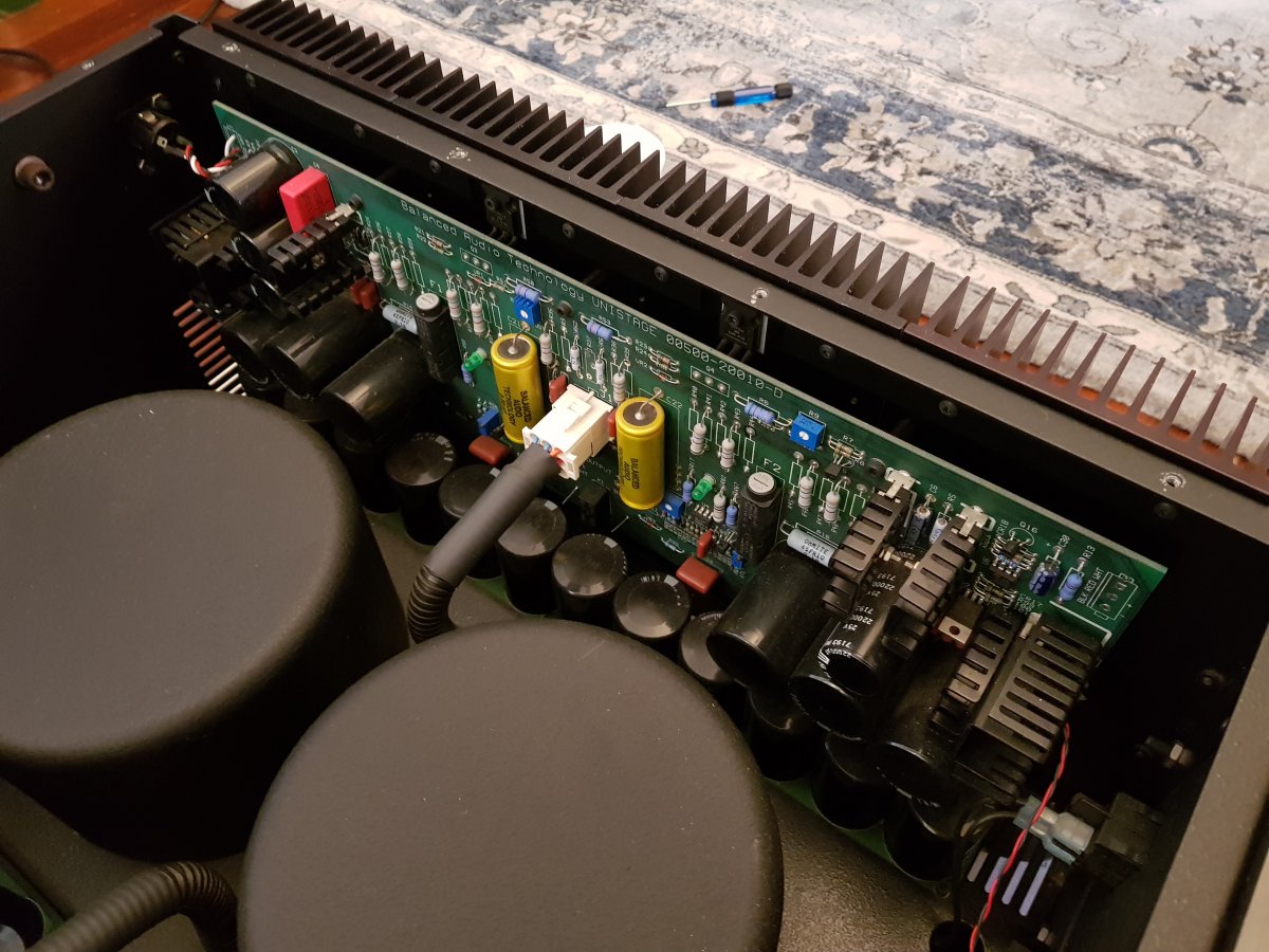

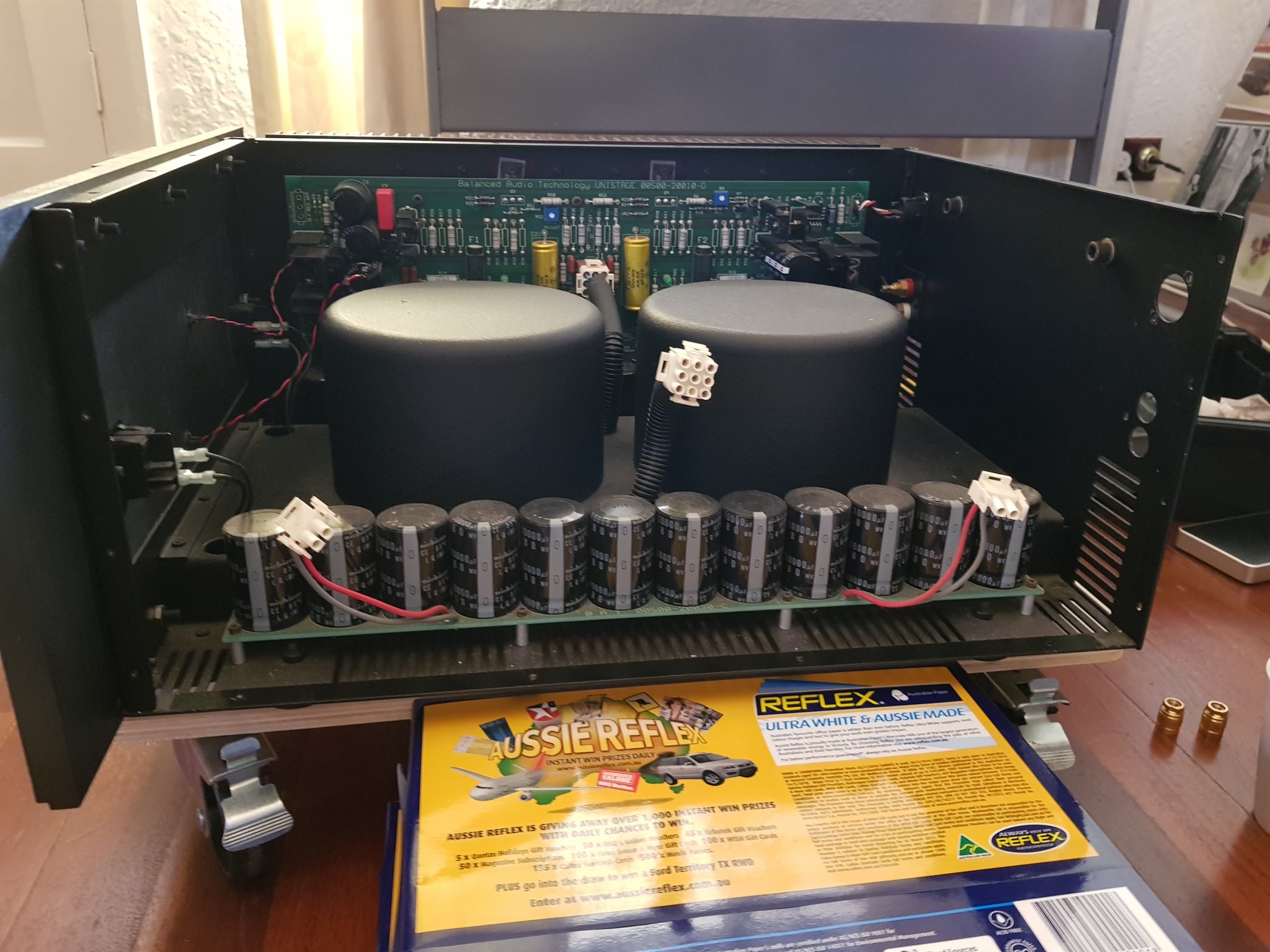

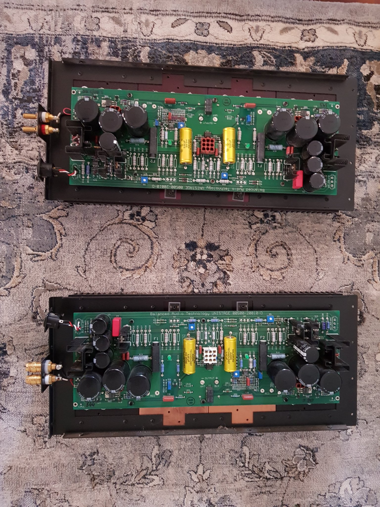

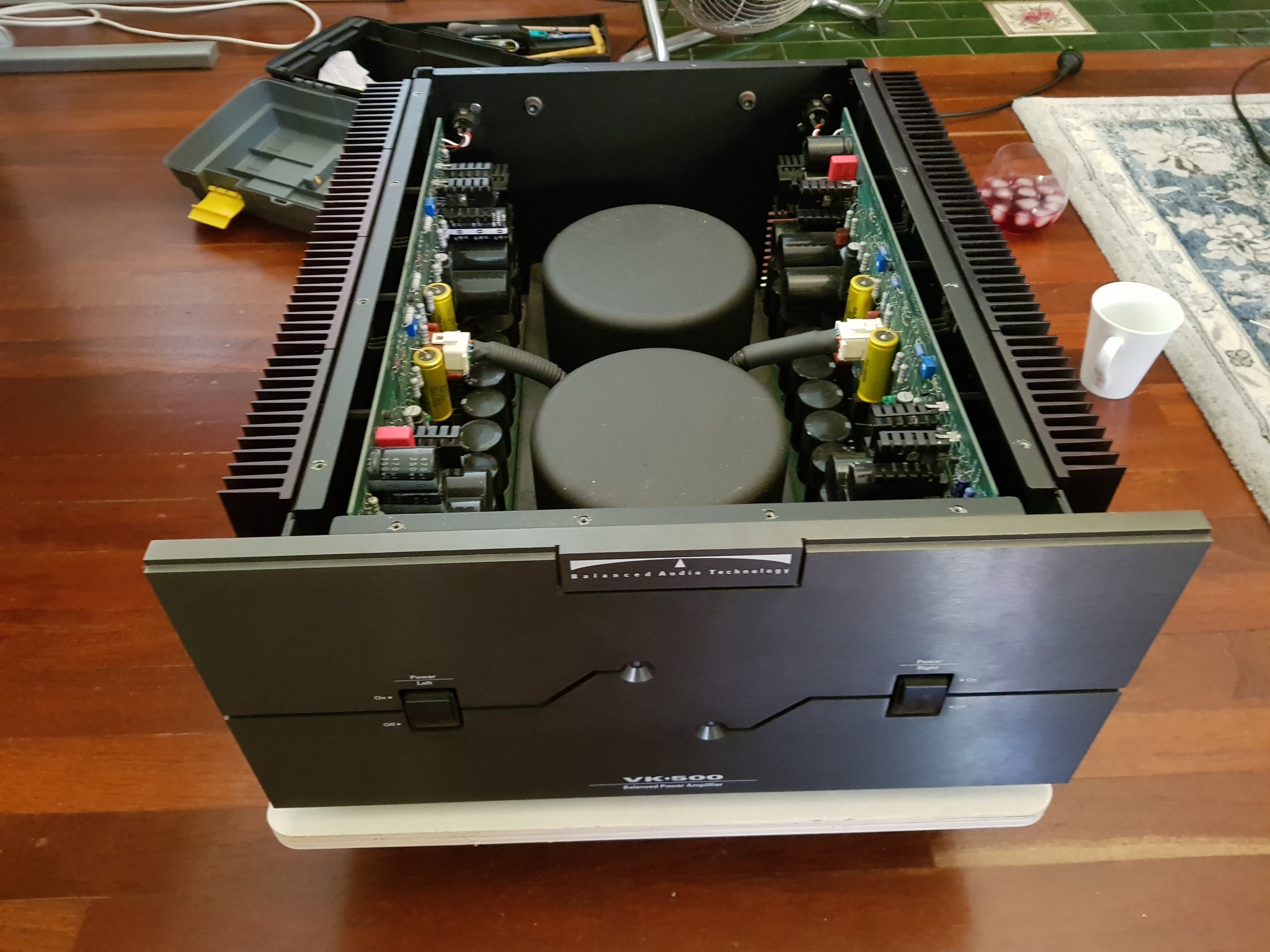

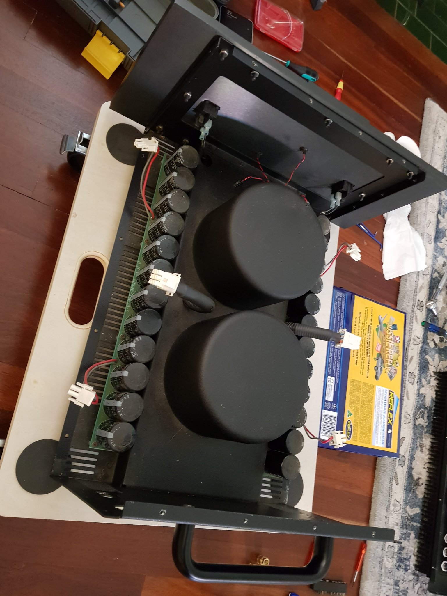

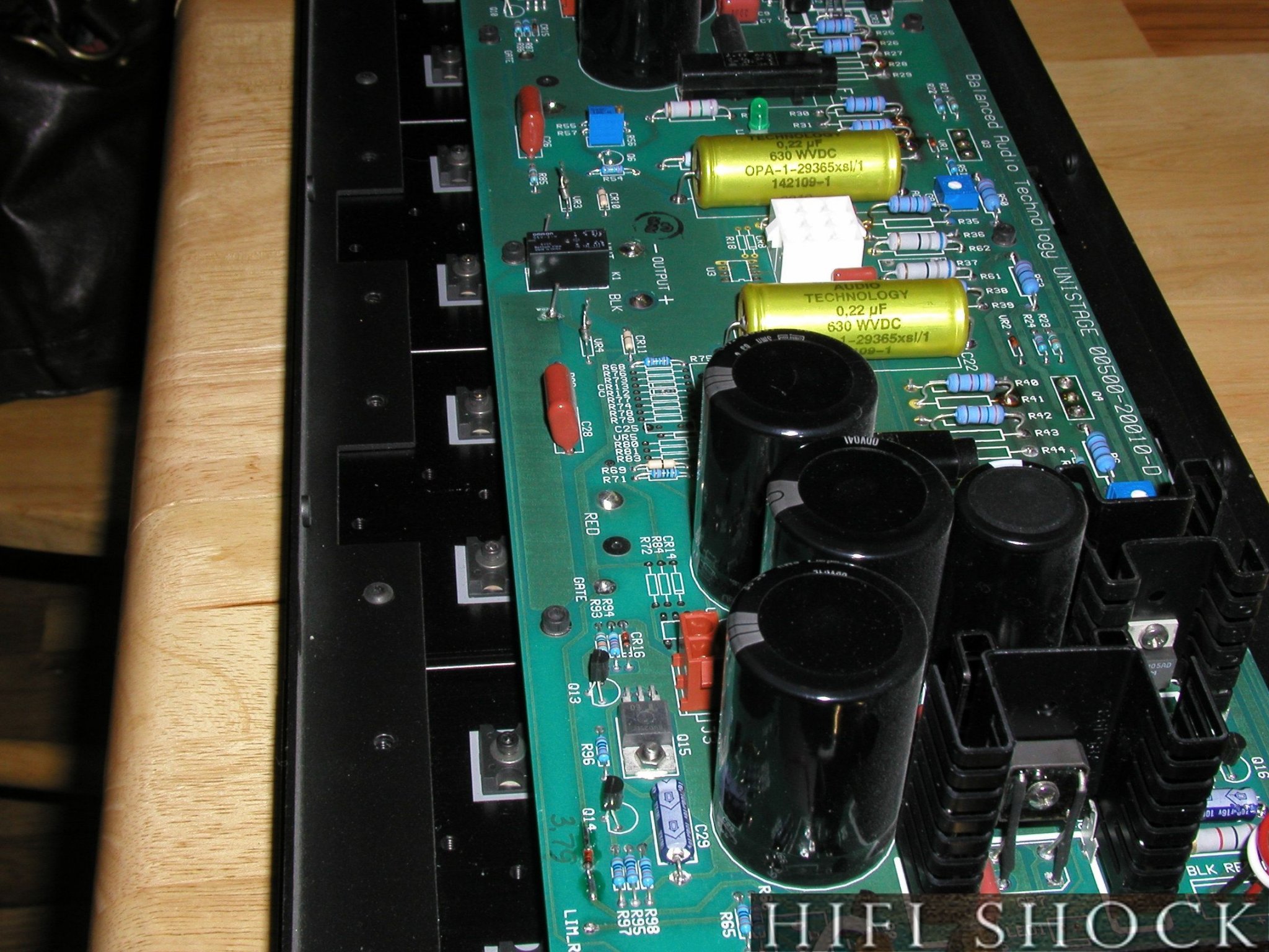

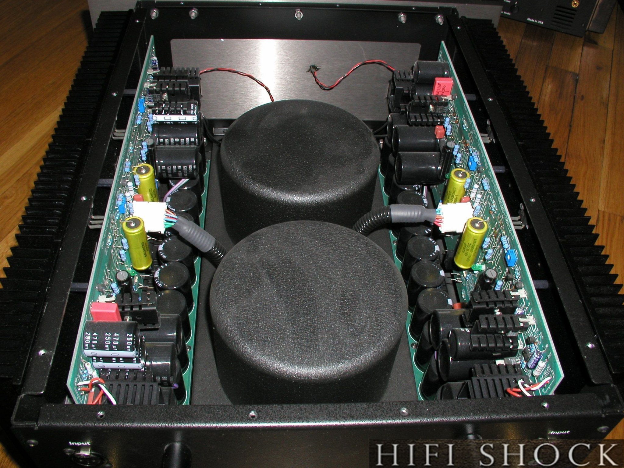

Here an URL with pics of a dismantling procedure:
https://www.stereonet.com/forums/topic/238057-balanced-audio-technology-vk500-repair/
In the attachment some images.
At first glance you can see numerous N-CH MOSFETs in parallel mode operation, but no associated source resistors.
https://www.diyaudio.com/community/threads/bat-vk-500-schematics-info.203650/
was an URL with schematic - unfortunately this file in the URL is deleted in the meantime.
Who have save the schematic ?
