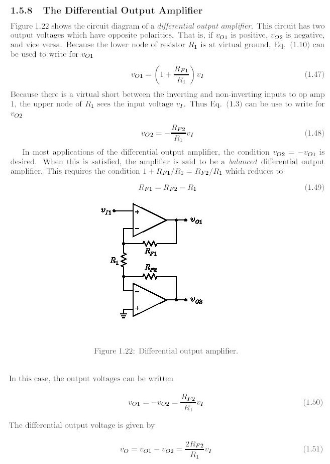

You may want to consider the following:
1. Arrange for your preamp. to contain two of the following single ended to diff. conversion circuits.
2. Use them to drive two stereo amps, each driving it's own 'speaker in BTL mode....make sure the two channels in each stereo amp. share the same star point in the chassis.
You can balance your amp to you heart's content and still not get real world balance when you connect it to a preamp or other source. Go to the Jensen transformer web site at
http://www.jensen-transformers.com/
and rummage around, especially through the white papers AN002 and AN003. They will convince you that a JP-11-P-1 line input transformer is the way to go. Check out the application notes for that transformer, also.
