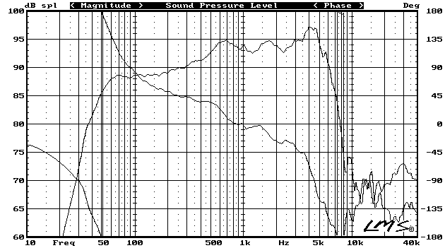

"The midrange should have either a large-ish or small-ish baffle so that there isn't a step in sensitivity half-way through its frequency range" Ceramicman.
In an ideal world this would be fantastic make the midrange baffle small enough to remove BS effect from the range of frequencies you want it to reproduce. But do you know how small this would need to be!
I have excel w15's mounted in a square baffle with about 5mm spacing either side of the driver. You would need to cross over at about 400hz to completely remove baffle step in this cabinet from the equation. I have measured them in the position they are used and yes they are on top of a 60cm tall 30cm wide 60 deep bass box BUT they require about 3db baffle step comp starting at about 1600hz and ending at 400hz. This baffle could not get any smaller.
Anyone know of a tweet i can cross at 400hz??
With bass boxes what you said can be implemented, if you xover low enough from the mids!, I cross over at 150hz to the bass. This is after baffle step has occured, ie the bass is the theoretical 6dBdown throughout the pass band, so I just ramp up the bass by 6dB to compensate for this. In reality I only need about 3dB though the same as the baffle step applied to the w15's.
So the obvious thing to do is make the baffle big enough
to prevent a step in the midrtange response, then by
defintion the step occurs ithe bass region.
IMO this is one reason why many simple 3 ways are flawed.
The bass unit c/o is chosen for the mid c/o frequency, whilst
it should be chosen to implement BSC as well.
Another reason most 3 ways are flawed is the bass unit
sensitivity needs to be 6dB more than mid and treble.
sreten.
