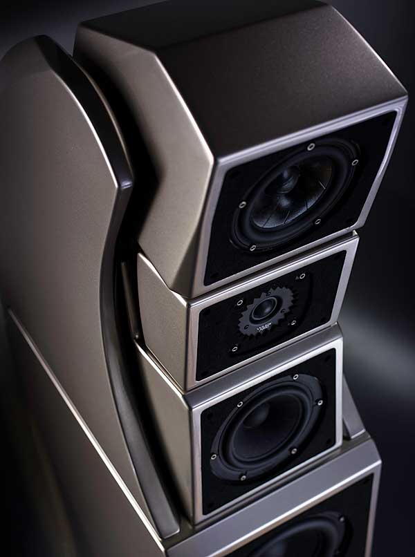

Stereophile lifted an old test of speakers with felt srips around the tweeter, very much like in David Ralph's tests. Sadly no measurements. Dick Olsher Dahlia speaker | Stereophile.com
Wilson is perhaps the best known user of felt - star shape! Their Alexx was in test bench and tweeter response shows nothing special in my eyes, specially compared to eg. Magico Q series and Vivid Audios which have round baffles. Notice that only CSD measurement is of single on-axis measurement!

Nice to see all that deep soul-searching comparing my felt to your foam albeit based on unsubstantiated impressions of image "sharpness".
I don't know what this is supposed to mean or who it's addressed to, but earlier I provided measured before and after FRs using felt with a tweeter, and did the same with foam which gave similar results. Both work much the same and the measurements proved that.
