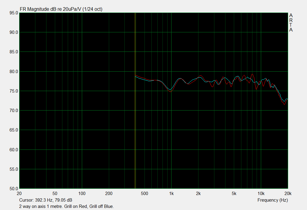

I finally had the opportunity to make some quick grill on, grill off measurements of my main speakers, so as promised, here they are.
I was able to move the speakers to get a little to get a bit more reflection free time however the measurement environment was still far from ideal, so I've still had to use a rather short gate time of 2.5ms, so the measurement is only sufficiently detailed down to perhaps 1Khz.
So, not ideal, but it does give some idea of the effect of the grill cloth and it's frame on higher frequencies. The front panels are flat, 39cm wide 59cm tall, the "midbass" driver is centrally located while the tweeter is about half way between the mid bass and the top of the cabinet with a 20cm centre to centre spacing. The crossover is a 4th order LR at 3Khz.
The grill cloth is very simple - a wooden frame about 15mm tall and 10mm wide with black acoustic cloth pulled tight. There are no struts or braces - just a frame around the perimeter. The mounting pegs cause there to be about a 3mm gap between the frame and the surface of the panel.
The first is an on axis measurement:
attachment.php
The blue grill off measurement is clearly significantly smoother right from about 2Khz up to about 15Khz. In particular notice the peaks at 8Khz and about 6.5Khz.
Subjectively, putting the grill on loses some of the "airiness" of the treble and sounds slightly sibilant, but not to an objectionable degree. There is no sibilance with the grills off. The peaks at 6.5Khz and 8Khz in particular explain this sibilance.
There are noticeable dips at 3Khz, 4Khz, 9Khz and 11Khz that all probably contribute to a small loss of presence and airiness when the grill is on.

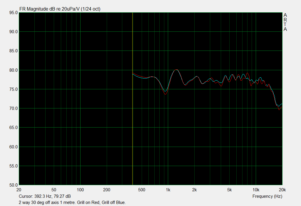

Next is 30 degrees off the horizontal axis:
attachment.php
In this one the difference between grill on and off is significantly less at lower frequencies, with only a small dip at about 4Khz being present until about 7Khz.
It's obvious though that the peak at 8Khz is still the same as is the dip at 9Khz.
This suggests the 8Khz peak and 9Khz dip is a cavity resonance formed between the tweeter and the grill cloth, and this peak/dip combination is probably present at most if not all off axis angles.
On the other hand most of the fluctuations seen at lower frequencies on axis are gone off axis, suggesting that the frame of the grill cloth was responsible for those.
Despite both drivers having a significant amount of high frequency directivity the frame of the grill cloth still has a significant effect, although nowhere near as bad as the Technics speaker I posted earlier.
On the other hand, the cavity resonance at 8Khz could probably be avoided by reducing the distance from the grill cloth to the tweeter. If it was halved it would shift it up to 16Khz so a bit less than half the gap should move it out of the audible region.
