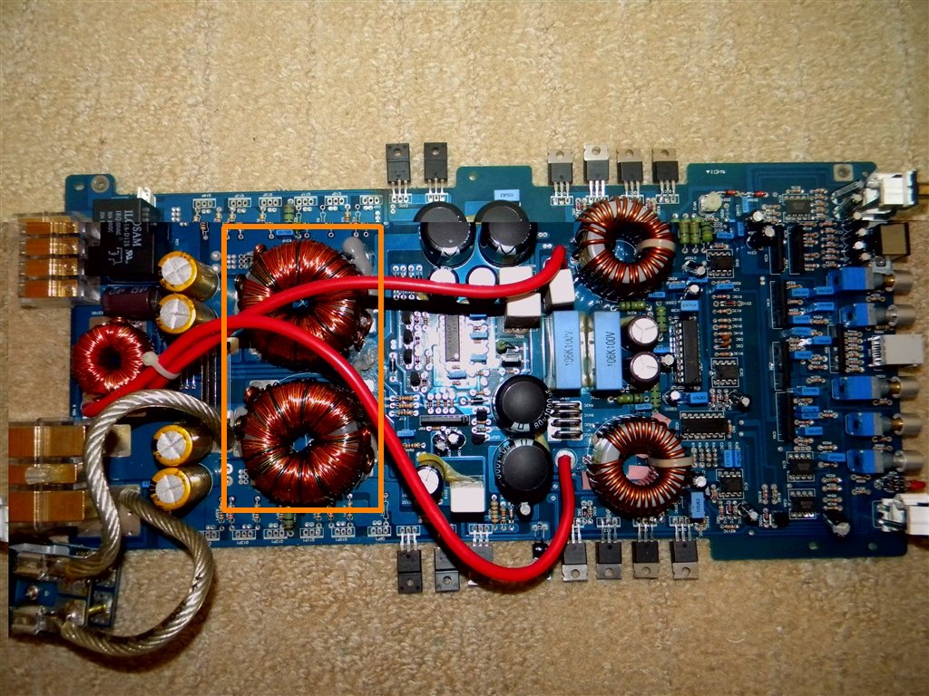

This is common when the transformer shorts between windings. The short is often intermittent which means that you may not initially find voltage on the RCA shields of the amp. Remove the cover from the amp. Place the black probe on the amplifier's ground terminal. Place the red probe on the input RCA shield. Twist/push/pull on the transformers. Does the voltage ever go from well under 1v to near 12v?
Do this with power applied to the amp but no remote voltage. Don't connect the RCAs from the head unit to the amp.

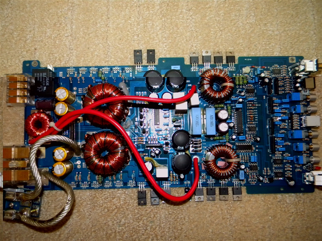

the transformer from the power suplly or the transformer from the amp part. i put a photo with the amp. Could you indicate in this photo what is the transformer that you talk about. Please!
Do you mean to measure betwen the ground of the amp and the "ground" of the rca, or on the positive part of the rca connectors?
The photo is old when i replaced the transistors from the power suplly

you're right! if i twist one of the transformer between ground and the negative of the rca i found 12V. What is the solution?

The most common place for the transformer to short is the point where the terminal windings (the ones that solder to the board) make contact with the rest of the windings. For the transformer that's shorted, pull those windings away from the rest of the windings. Does that prevent the prevent the transformer from shorting when you twist it?
the distance between the holes where the wires goes into the pcb is big. i discovered a couple of places where the transfomers is shorted. to many places to put some glue to repair the damage. If i proceed and i respect what you said it means to desolder the wires and to put a insolating material betwen the layers.
