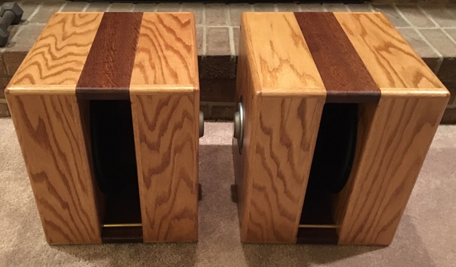

However; I found a company in Europe (TLHP) who had SLS 12's in stock and I purchased 6 of them today.
I'm building several subs for some audio buddies who liked mine, and I had already cut the wood pieces to fit the SLS dimensions so I'm really glad I found another source for the woofers.
Mine are shown below:

Beautiful! They look like a prettied up Visaton Petit Orgue!(I'd love to see measurements facing both ways-Visaton goes one way, Pass et al the other)
