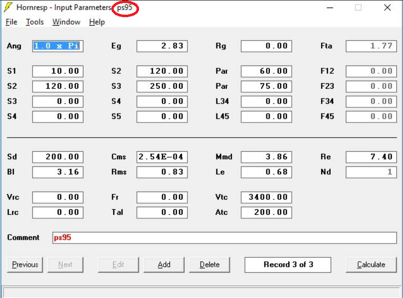

Hmm, isn't this something similar to what I mentioned awhile back? I had some files that when I opened them I got an 'invalid result, change data' error, so had to create new files, but couldn't delete the bad ones.
Also, the driver specs for 'your' ps95 is actually the hiq.txt he just uploaded and I've [so far] successfully imported, used to make new files.
GM
Hi GM,
Hopefully the problems you were experiencing were fixed some time ago.
As far as this latest issue is concerned, it turns out that records are being correctly saved to user-created data files after all .
The comment "when i opened the hornresp, it for some reason didnt load the saved data." would tend to suggest that File > Open was not used to load the ps95 data file. The default data file would have been automatically loaded when Hornresp was started, which would explain why the desired ps95 record number 3 could not be found.

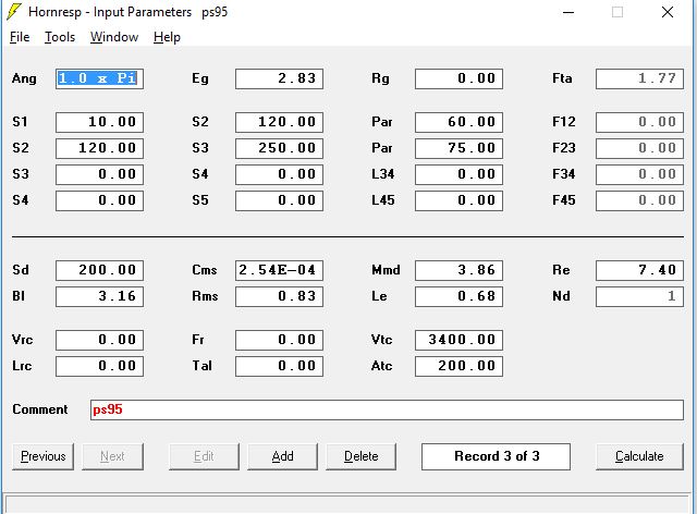

added the driver params and some initial params to the horn resp.
not understanding how to calculate S1, S2 and S3 values
i have selected parabolic horn. so what would be the flare axial length for horn segment 1 and 2?
have selected 3.4L (3400cc) throat chamber volume. this i calculated based on driver Sd i.e. 200cm2
am i heading in right direction?
When designing a horn using T/S specs [as opposed to creating something with a 'slider' Wizard], this driver's super high Qts falls strictly into the small open baffle range, so a narrow bandwidth [BW] big vent reflex [AKA 'scoop bin'] is the horn equivalent.
If positioned in a corner, then the small vintage style cabs such as the Klipsch Rebel can be adapted to work well.
Note I just did a couple of 'quickie' one segment horns, so of course divide them up in whatever way its response comes closest to my sim [that you can easily build with flat panels of course].
Note too I changed the power handling to the published 25 W max and since these have a paper accordion surround, limited it to 0.5 mm Xmax, a typical limit for such designs, though will move a bit more before the VC starts leaving the gap.
