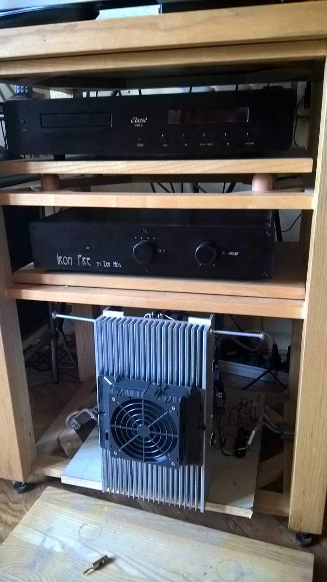

Official Court Jester
Joined 2003
well ........ it'll be swell ......... but no
proper trio for upper and proper trio for lower position
Idss in say 5% range for trio , difference in summ Idss between trios , say, max 15%
even then , Temp Co (for DC offset) is way superior than with complementary version
I didn't
I got it exactly as is ...... using it for years for same purpose
hey , I even did Babelfish J2 prototyping on same htsnk :)
back in 2010.

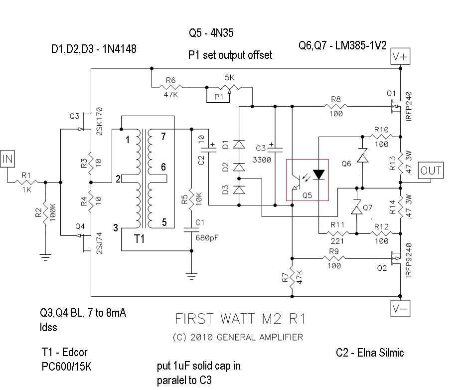

I am trying to get a grip on how the M2 circuit works. :confused:
Can give me a tip on those components that I do not understand? Optocoupler seems for against overcurrent through the power FETs. Per overcurrent it makes the voltage to open the Q5 and then closing the FETs. But is this just for protection or to continuously stabilize the bias precisely? What is the effect on the sound?
I thought I need to understand the M2 to follow you further.
You see that I am not electronic engineer however I would to taste the charm that you cherish about M2..

damn ....... it took me longer to find it than to write it again ....... but sorta sleepy , so better to search for than to read my own brainfarts tomorrow ;
(edit: I'm also not electronic engineer , but that's not preventing me of making my self a fool in public , on regular basis :rofl: )
anyway , it is here :
Official M2 schematic
to quote my self :
optocoupler is there , functioning in this way:
LED is fed with voltage across two source resistors
series resistor for LED is to keep current and voltage for LED in safe area
LED is shinin' on transistor base , defining conductivity through it
transistor is part of current path from + to - PSU rails , and it's maintaining proper voltage between mosfet gates
(current through mosfets rise , LED shining brighter , transistor more open/lesser effective resistance , so lesser voltage between gates so current through mosfets decline)
3300uF across transistor is to neutralize process of normal current fluctuation through mosfet source resistors , so LED is having in same manner fluctuating voltage , inducing same fluctuating of light to transistor base
that way voltage between mosfet gates is held pretty solid and steady
so imagine that cap as wide open solid fork ,placed with fork pins between two gates
on whichever side (pin) of fork you're pushing/pulling , other side is following , always staying exactly same apart
in case of M2 , fork is pushed/pulled on lower end , through C2
you can connect it to other end of C3 , result will be the same
I bypassed C3 with 1uF polycarbonate just because I can , will sleep like a baby , knowing that I'm done everything that fork stays solid even on highest frequencies**
that's exactly intended role of C3 - to not conduct signal , but to represent solid pushrod to signal ; that trick/part of circ is sometimes called level shifter
**not that's for certain , but sleep is important
(all ref. to schm in post #1 ; sketch of exact forks missing there , so I'm enclosing it , just in case ; second picture just because I'm Enormous and my Ego is Enormous)
:clown:
edit: linked schm from #13 , so you don't need to jump from tab to tab :

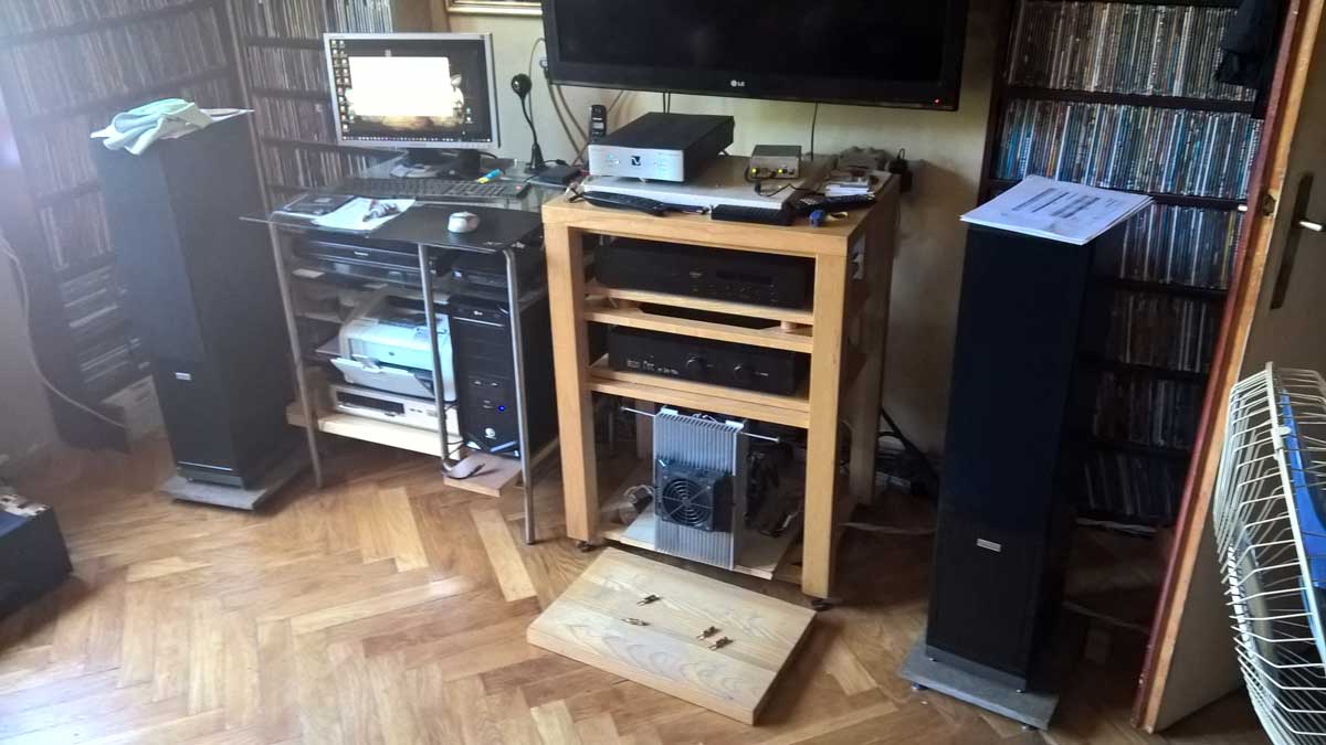

Joined 2003

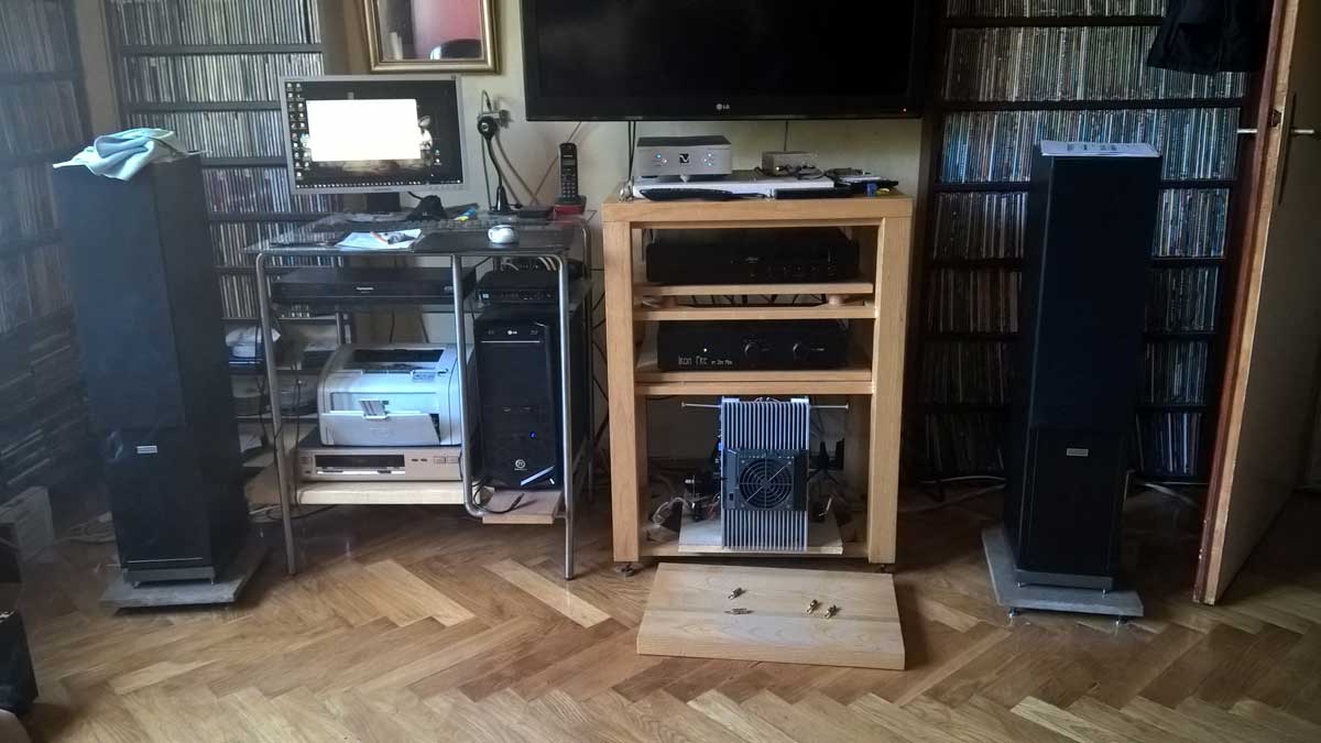

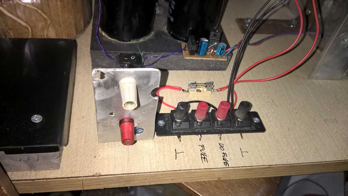

and today is first day of evaluation on Dynaudio Contour 1.8 Mk2
4R impedance .....
after just 30min (after initial warm up) it is clear that Babelfish M25 is damn well improvement over regular (Papa's Koan) M2 ......... and that still even without trying/engaging (supposedly superior ) White Cathode Borbely JFet buffer ...... and that one is promising to have objectively lower distortions , driving that nice Edcor Iron
and , we are speaking here about properly made M2 - dual mono (each channel having 250VA Donut and 4 x 33mF caps) with proper wiring inside ...... while T-Bed is having common supply for both channels , with old and tired caps and sooooo crappy wiring ........ and with flimsy 1A6 fuses inline with speakers
