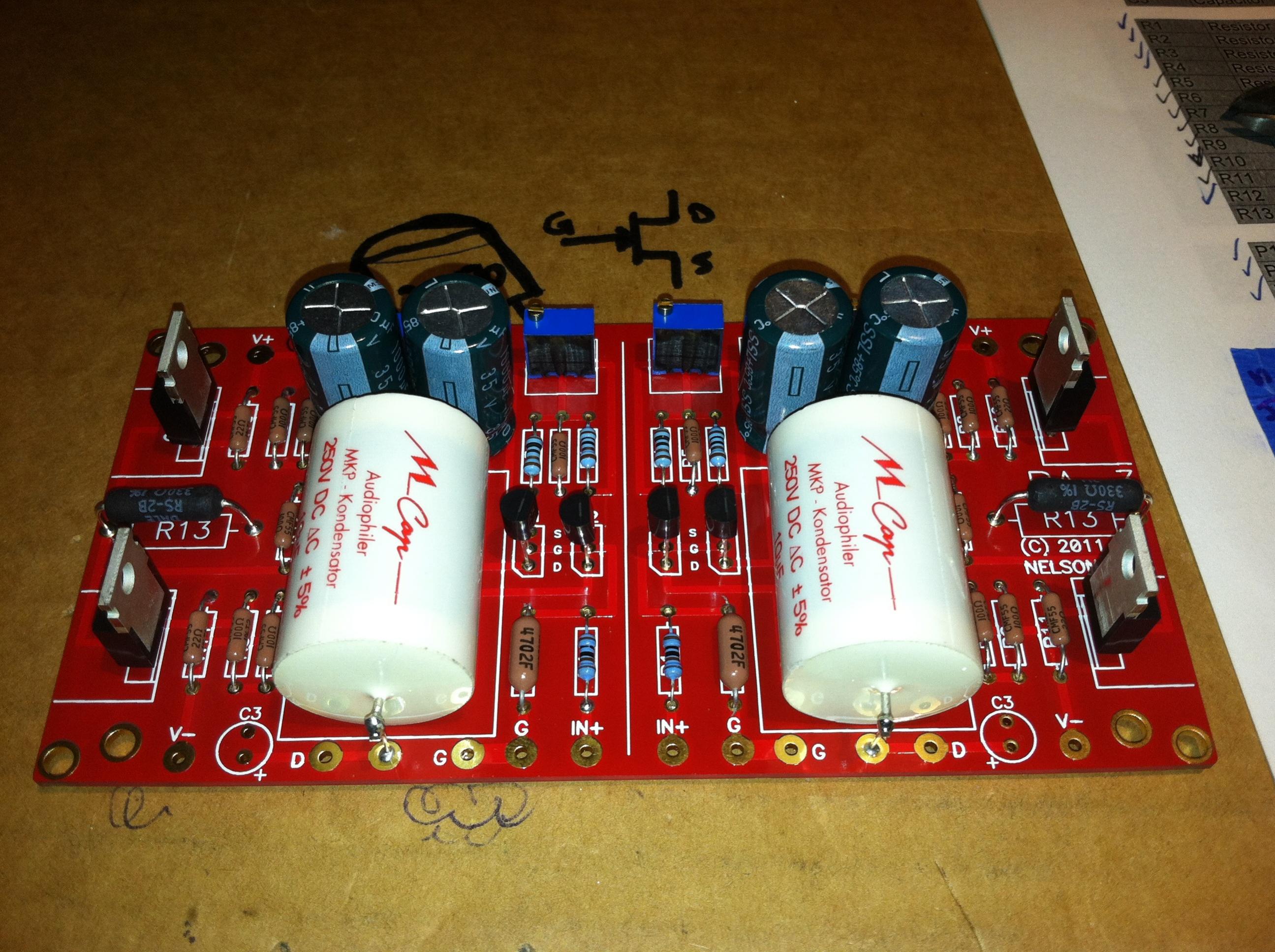

Listened to the preamp today through two other amps. AJ and TSSA. Sounds great. bumping head on ceiling, IMO. will be more about tweaking of cirucit from here on. Listening to Patricia Barber, Companion, SACD, and it just excellent. Speaker limited at this point. Gotta try UGS to compare. Got the transistors, so will be working on that, populating shunty, and BA output. Will probably go 4 pairs@.5A on output. Gotta figure SE resistor value. Been looking at BA1 output as possible SE CCS.

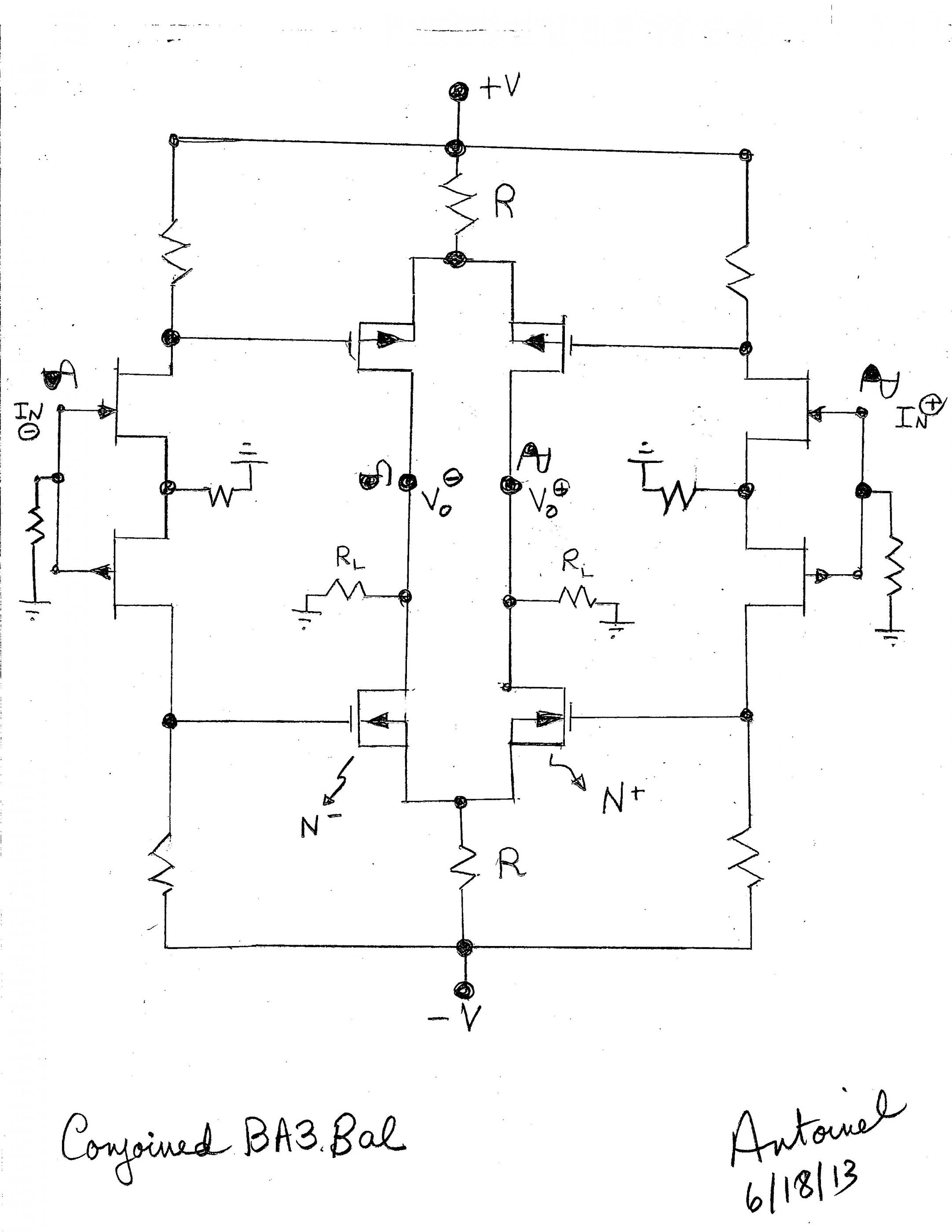

A BA3 Balanced schematic
The simplified schematic is attached. It is a different topology from that done by Mr. Pass. It shows two conjoined BA3 Front Ends. The P-MOSFETs are configured like a differential amplifier. Ditto for the N-MOSFETs. I'll gladly elaborate if needed.
Should get error current through comon source connection of the output fets.
The following is the expected performance of proposed circuit; pending experimental confirmation:
- DIDO; diff in to diff out
- SIDO; single ended input to diff out
- Potential for vanishing distortion across a load which is connected between the output ports.
Please clarify your question. A bit obscure which prevented an answer. In your opinion, what is the impact on performance by the absence or presence of an error current.Was that a yes?

Antoinel, Nelson speaks of distortion reduction due to error current in his Zen V6 article. From what I understand it is the result of special feedback for which he is known, and is different from standard balanced/bridged operation.
