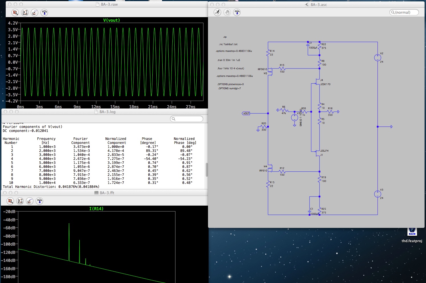

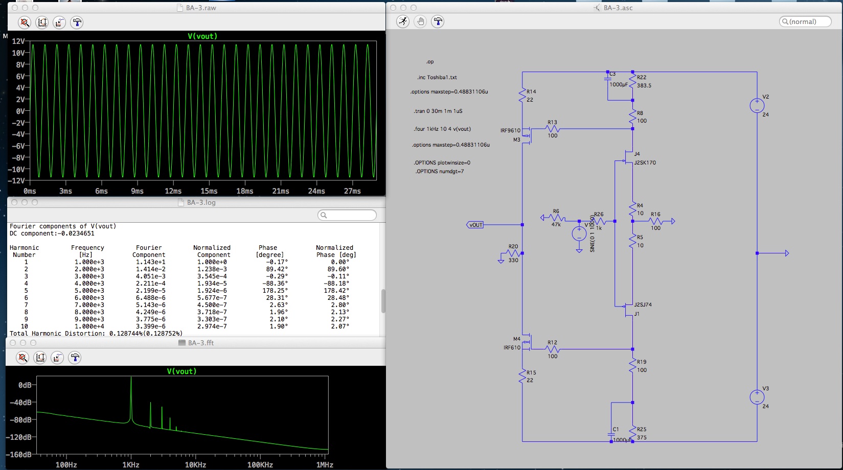

I played a bit with Spice and besides reducing the 330R load resistor even more to get lower gain, it seems possible to make the 100R from the J-Fet source node bigger to get lower gain, in my picture around 3.5.
I do not know if there is any drawback to do so……
Zen Mod please…..
Indeed locking at the high k2 again, I suppose that the high k2 is coming from the IRFs and not directly from the circuit, that would explain the persistent k2.
first picture normal BA-3 and 100R
second picture with 350R source to ground resistor.
both with 1V input

100R going up - there is nothing wrong with local degeneration
no ill effects on Jfet stage , in musician terms - just making input "harder"
compare input voltage with voltage at top of 100R ....... and observe how effective Ugs voltage (effective signal on Jfet gates) is going down in value when increasing that resistor
however , nothing wrong with K2 , as long we have proper rest of THD spectra
