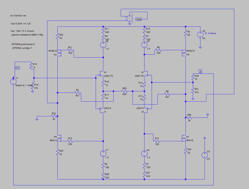

BBA-3 with feedback
I showed it already in an earlier posting….
It is very easy to modify for fun the BBA-3 with no feedback but with the heavy (330R) load to
a) a pre with feedback gain 4 (12dB)
or
b) as a driver stage for a burning amp BBA-3 with feedback and a gain Nelson uses often, 26dB
Of course you have to omit the 330R loads at the output of BBA-3 and omit the four 1000uF caps as well to get enough open loop gain for the feedback.
In case b) you can change from local feedback including only the frontend to global feedback including the output stage also (Burning Amps or F4).
Simply trace the 4k7 from the speaker output to the input J-Fets.
Measure for security the offset in a) and b) with a DMM.
If you get a higher voltage around 20V at the outputs, the 4k7 went to the wrong side.
I assumed in Spice an output stage with an input impedance of 3k. Spice does not allow pots in my beginners level of handling it, so I simply took the 420R and 424R resistors instead of the 500R pots.
Forgot, a 100pF capacitor over the 4k7 feedback resistors could be useful against oscillation.
For me the feedback solution has a bit more punch and definition, the NFB is more romantic.
and helas I always get nervous when I make more complicated contributions like this…. so please check for possible faults….. :)

Pot for adjustable gain?
Is there any reason one shouldn't use 3w pots in place of the R13s?
Found a Vishay PE30 pot that looks suitable. Comes in 470r (see pdf).
I was thinking that would give a nice feature alá Aleph P, with front panel adjustable gain for each channel, and also function as balance adjustment (so no need for seperate mono volume pots). Then I could easily adjust the gain on the fly, to match the given source voltage. This seems to in line with Mr. Pass philosophy, of not throwing away signal :cool:
Has anyone tried this with BA-3?

Thanks for tip about resistor for min. gain, that makes sense. I was more worried about max gain actually, with the 470r pot. Is there any real risk here you think? :confused: Or will it just run a little bit hotter at full gain? :D
i have problem with my BA3 as a preamp. 2sk 170 is 9,4mA Idss, 2sj74 is 10.2mA Idss. I read how match input jfet for perfect sound. but i have only 2-nd, 4-th, 6-th 8-th harmonics with the identical amplitude. Can not in any position potentiometer get odd harmonics. What i do wrong?
