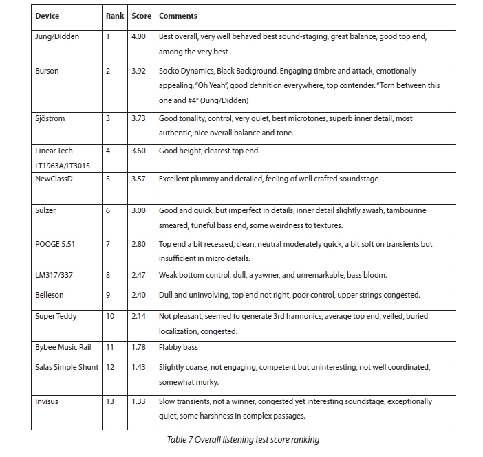

They (LM317/377) are not bad, and they are definitely better than the 79xx and 78xx. I'm using the LT1085 and 1033. These are considered better than a LM327/337 pair. Without direct comparison, I couldn't say. I would love to hear your thoughts on the Didden/Jung regulator with this preamp. You thinking dual or mono supply?

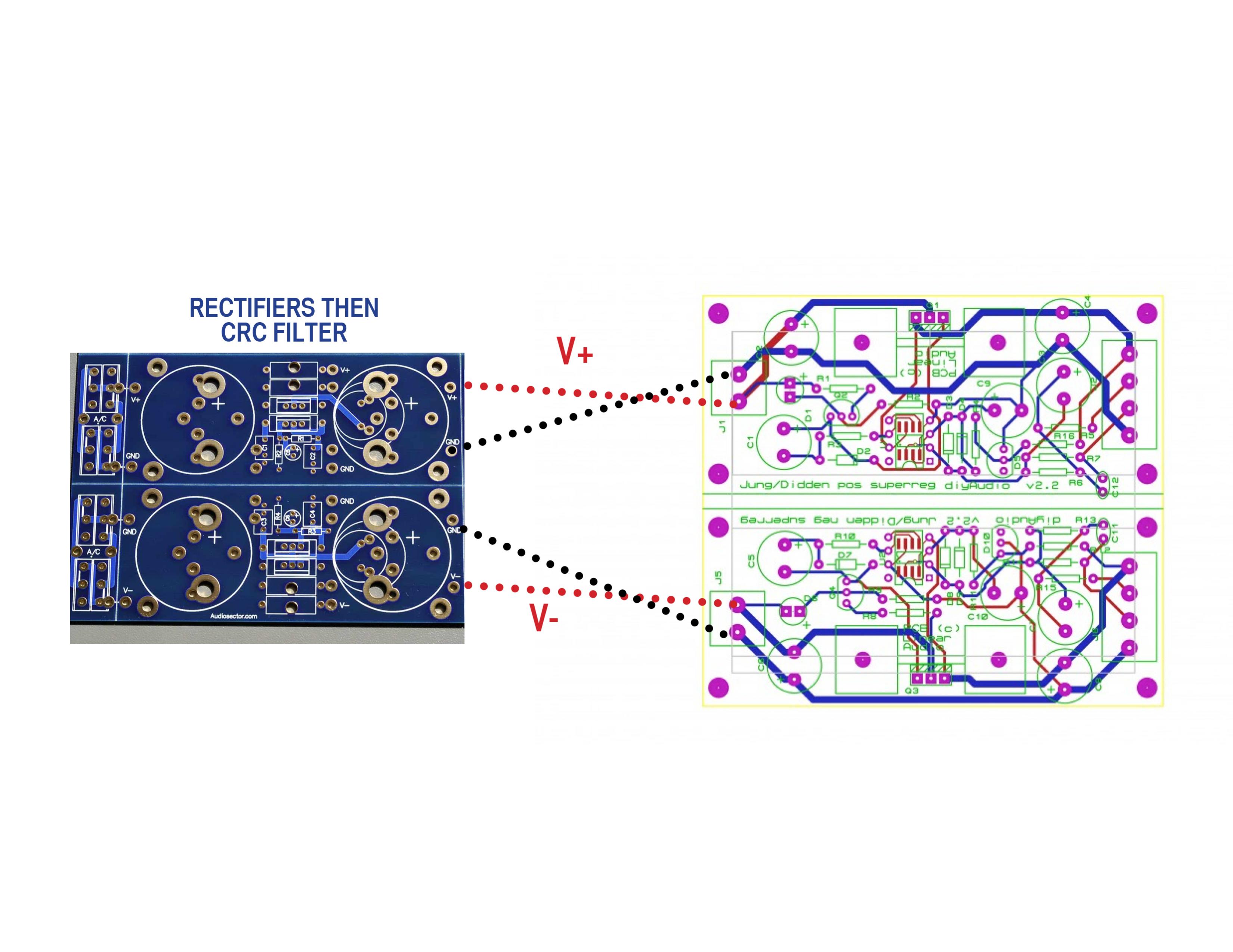

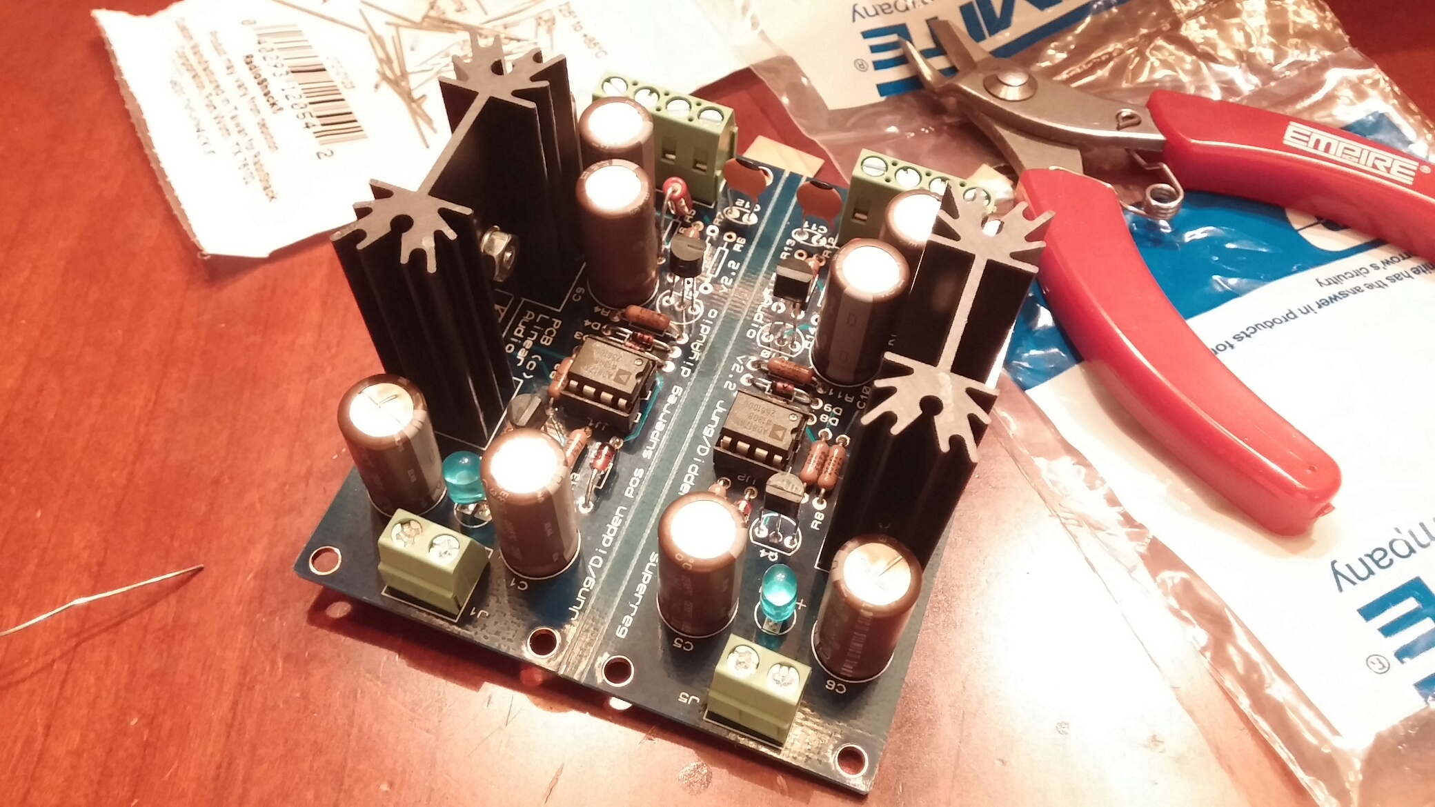

Single supply. I have the super reg board populated and have done the math to get 24V out. I am using PD's 317/337 boards now. I should have it up and running soon, the super reg board board does not include rectifying diodes or a capacitor bank so I need to figure out what to put before the super reg board.
I think it's all going to depend on the PSRR of the BA-3 and how it reacts. The BA-3 is basically designed to be run with an UNregulated supply as a gain stage for an amp...I wonder if the design is really power supply dependent. I am not smart enough to know it's PSSR characteristics by looking at the schematic.
Attached is an interesting chart from Linear Audio...

I converted the PD boards to just CRC, 2,200uf caps with 4x .47R resistors between.
Using a 24V transformer I am getting 33V after the PD boards...hoping to drop 8V in the supereg to get 24V out.

Take all but one .47ohm resistor out per side. That will help a little, but at these current draws, to get a decent drop you will need 10-30ohm.
Still, the red should bring the input to the regulated point.
Iam not really trying to drop voltage with the crc arrangement....just filter a little. The superreg needs at least a 5v drop to perform well. Iam dropping 8v. I think that will do.
I have the neg side up and running. I burnt the chip in the positive side so ill have to order a new one. Stupid mistake....I learned one should always print schematics and pcb layouts in color not bw. Accidently hooked it up to the ps backwards on the positive side.
Ill replace the caps and chip and hopefully it will be up and running in a few days.
Btw...everybody complains about the cost of jfets and such....the ad817 chip is $5 each! Ouch.

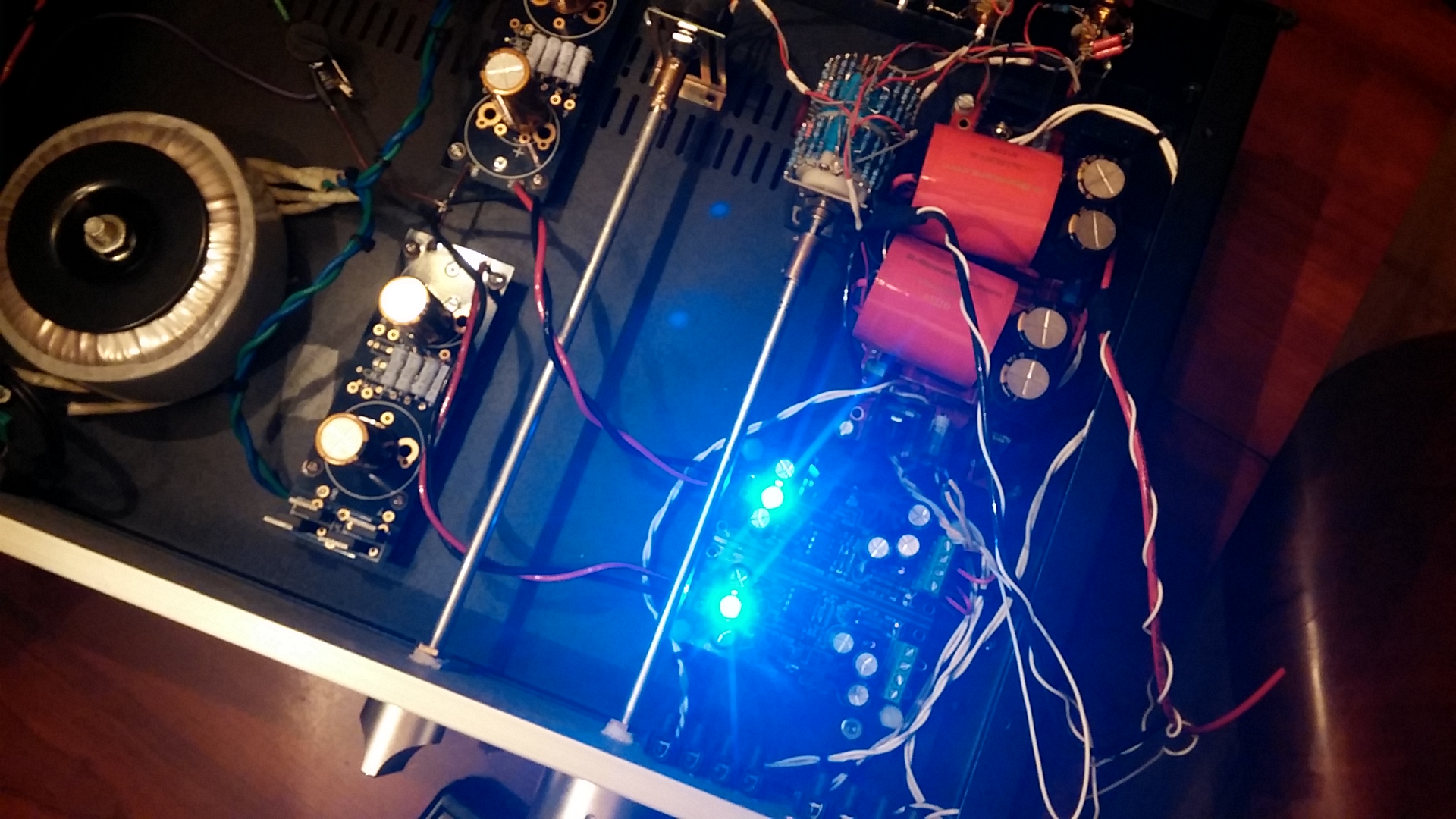

Well it is up and running with the superregulator. Iam now running 25v rails instead of 30v rails on the ba3. My first impression is a little more detail than the lm317/337 set up but i need to let it burn in a little. Ill follow up with my impressions in a couple of days.
The difference between 25 V rails and 30 V rails is going to be more of a different than the regulator itself...
Maybe....iam running a little less bias right now too. Iam going to let it play for a couple days...maybe raise the rail voltage and bias. I can take it up to 28v rails and still have 5v of drop out. Right now iam noticing more detail and less slam and bass. But it sounds extremely good, just a bit delicate. Better detail on cymbals and piano sounds more true. But perhaps not as much drive and kick. Could be the bias and rail voltage. But iam going to give it some time before making a judgement.
