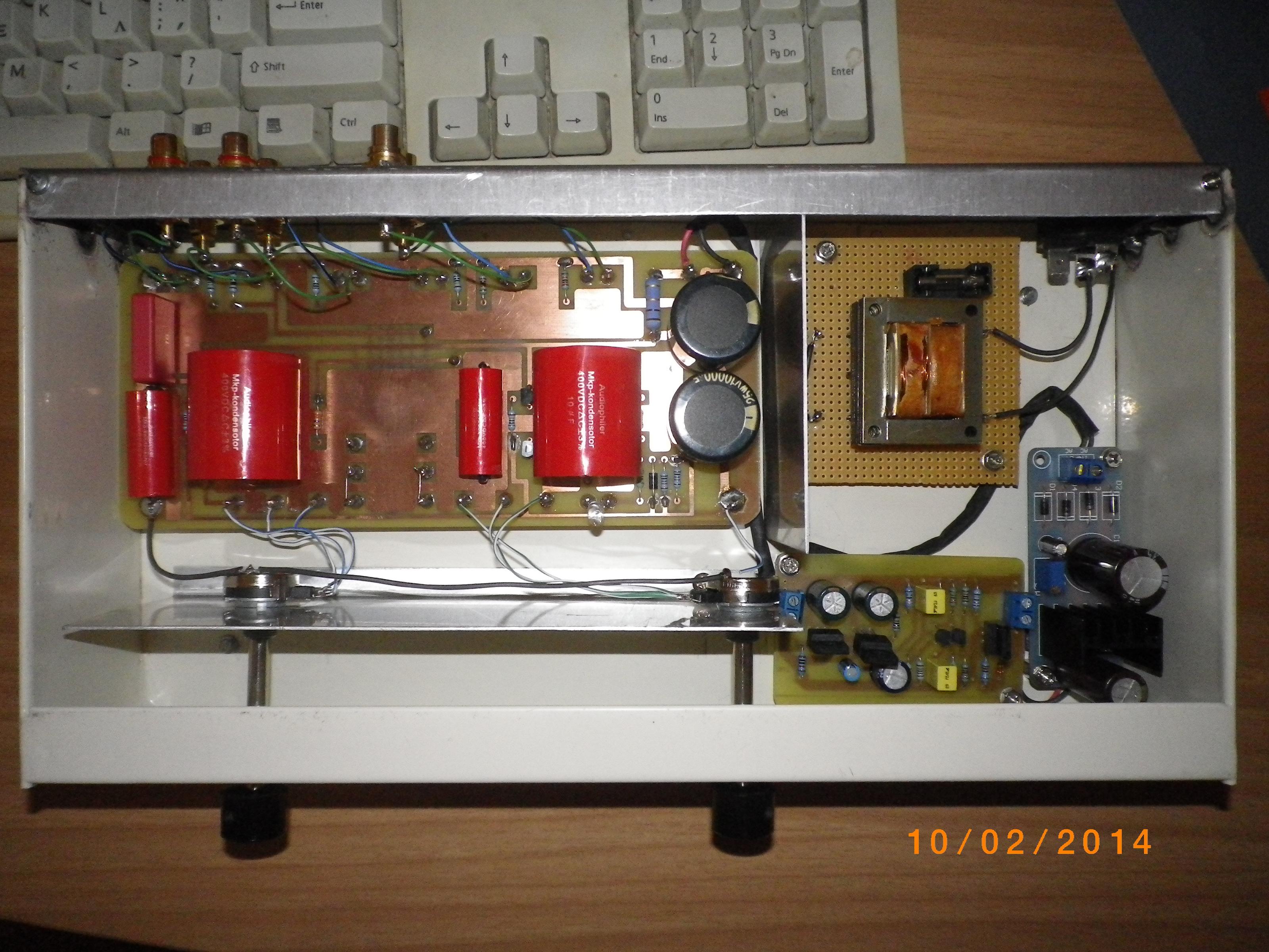

Used 220 ohm for gain resistor.
So you're using 220 ohm resistors for R13? I saw where someone else had used 180 ohm resistors.
My concern here is too much gain with the BA-3 since I typically only use a buffer between my sources and power amp.

i have finished almost my B1 in chassis but i have matched two couple of 2sk170 sj74.
which are the values of voltage on rails? +/- ?
can you give us more details B1 buffer vs BA-3 about sound ?

Great...I think I'll order 220 ohm resistors instead of 332.
Are you using both R1 and R2 along with your volume pot?
What value volume pot are you using?
Thanks...
Only used R1.
25k DIY shunt step attenuator. Used standard 1/8w 50ppm resistors.

24+\- dual supplies.
It's not so much the detail because they sound similar in that respect.
It now sounds like there's more weight to the music. But this might be due to the B1 trying to drive the amp or lack of gain. The pairing I have may not be optimal. The B1 is a thorough preamp. It's not leaving my house.
A better comparison will be with the boz-j.

For source i have an old CDplayer Technics SL 520 with output 2V p-p with db attenuator -12db .
My B1 buffer with 0.012V dc offset match perfect with my GOLMUND clone 9.2 and my VSSA without cap input i dont have any problem lack of gain due CDplayer Technics SL 520.
Very VERY detail my B1 with two amps

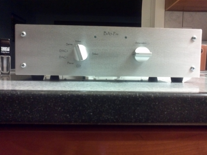

After listening to the BA3-pre for some time, I can say that the B1, BOZ-J and the BA3-pre are all very similar in that they are all very transparent. The BA3-pre adds a bit more force to the sound. I think a limiting factor is the source equipment, not the preamps, especially not the BA3-pre. Only adjusting/changing the ASIO driver in my digital setup revealed sounds missing before. Incredible highs from the BA3-pre!
Reference: Brubeck's- Time Out! 176Khz hi-res tracks. Some well recorded voice are in the room and big. DSD tracks: no harshness in vocals at all and sound very "vinyl record" like. Sound stage wraps around in a semi circle in front of seating area.
all sounds appear to start 1 foot behind the speakers (Slotted Open Baffles).
have not played with P3 adjusmtment yet. That would mean removing the pre from the rack.
Don't be afraid to build this preamp! It's great!
My build:
Dual power supplies with LT1033/1085 regulators
Shunt stepped 25k attenuator (DIY)
20v+20v Antek shielded toroid transformer.
Par-Metals amp case
Mundorf M-cap
Vishay/Dale, Xircon (?) metal-film resistors.
~10db gain
Parts Connexion Connex selector switch. (I'd look around for another switch. )
Pin 2 is output on both poles. The rest are 1-6 input pins. Need continuity tester to figure it out.
Getting decal sheets soon. Will label ins and outs and post a few pics.
Hope this helps someone.
Vince
ps. There is a difference in spiking and isolating the preamp. Spiking adds more focus. Isolating gel feet rendered the sound more smooth, but more stable than just using the chassis feet.
