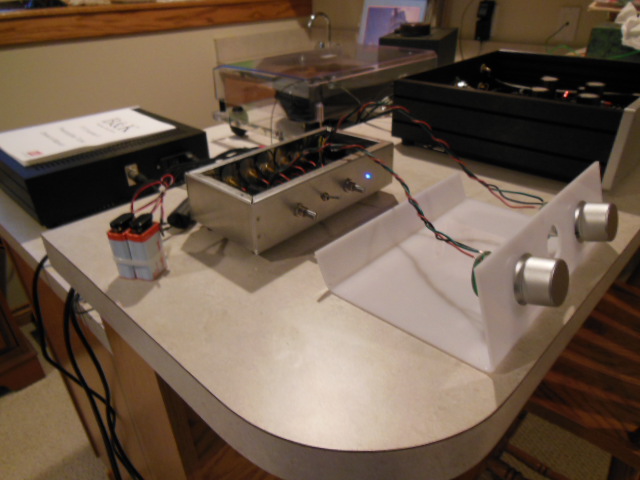

stepped attenuator for B1
Parts for the BA-3 FE have been trickling in. Anticipating Salas BIB boards and parts from the group buy.

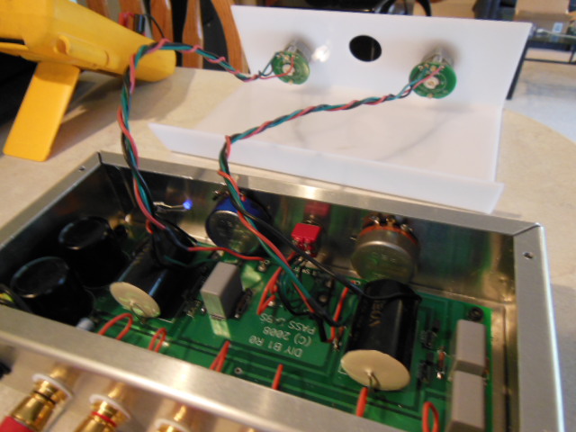

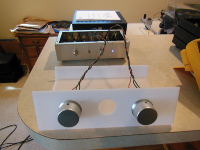

So, I've got these Goldpoint 25K attenuators sitting on the table with no home, wait minute :bulb:...wire them in the B1 in place stock PEC pots for comparison. There is a difference, everything seems more clear and detailed. Can't wait to get them in the BA-3 preamp.
Also thinking about trying the B1 powered by batteries. How would I go about wiring that on the Passdiy boards.

I did hook the B1 up with batteries and it does make a difference in the sound.
I wonder if Energizers would sound even better than the Ratshack batteries;)
I used duracells. 6L6 regulated supply worked better. BA-3 Pre makes it a non-issue by a large degree.:) I didnt care for B-1 with F-5. BA-3 is wonderful with my F-5! I can hardly wait to get the BA-3 Power Amp done, finishing touches only needed.
