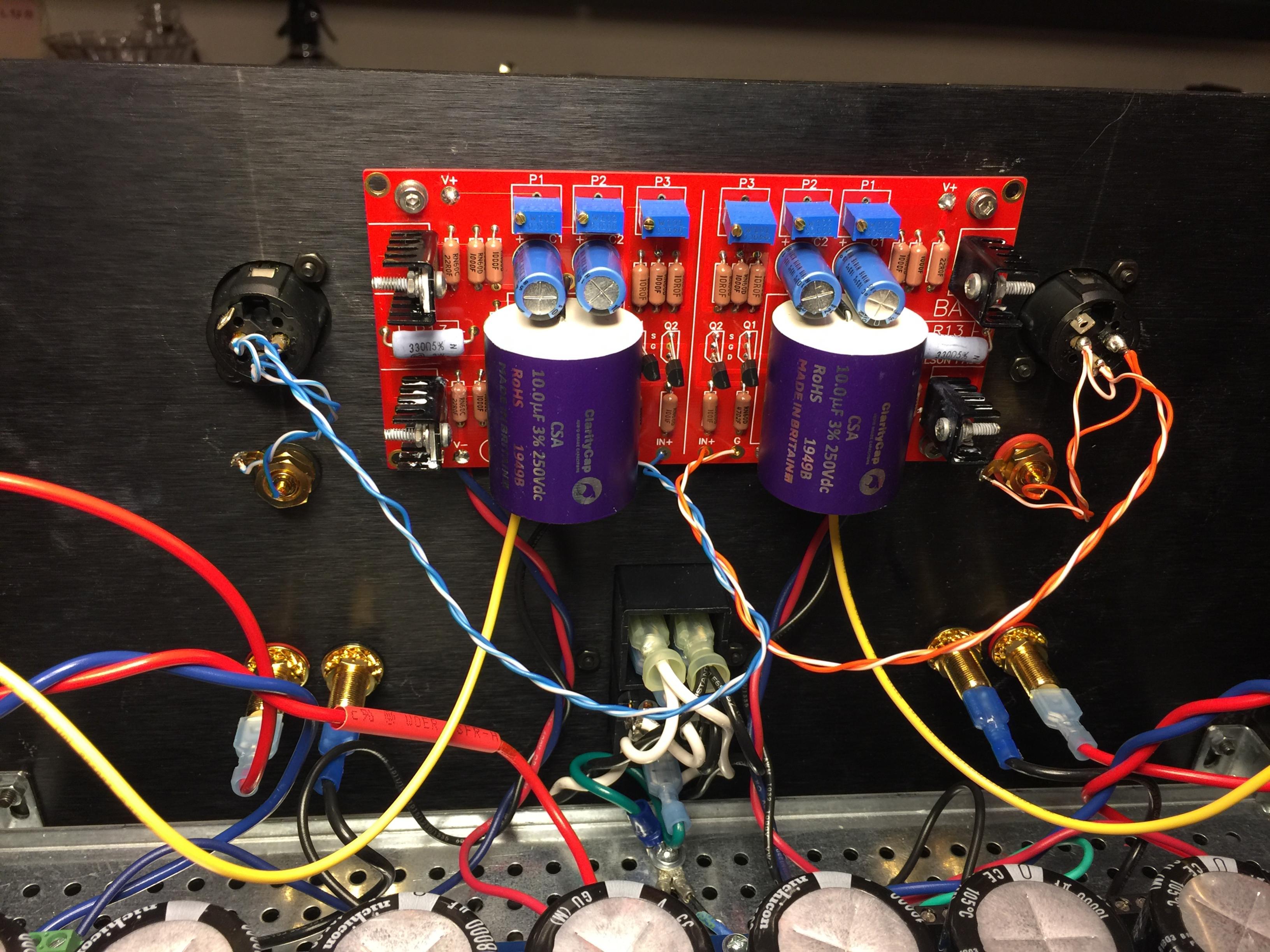

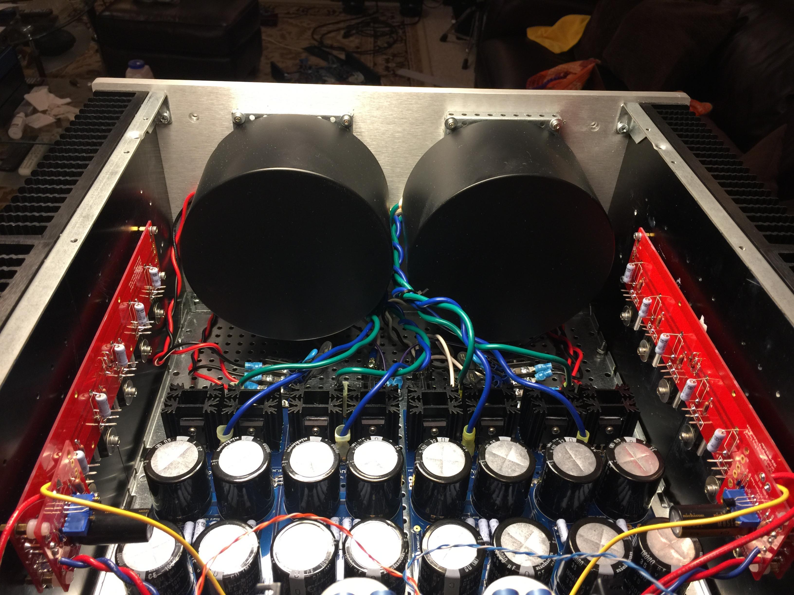

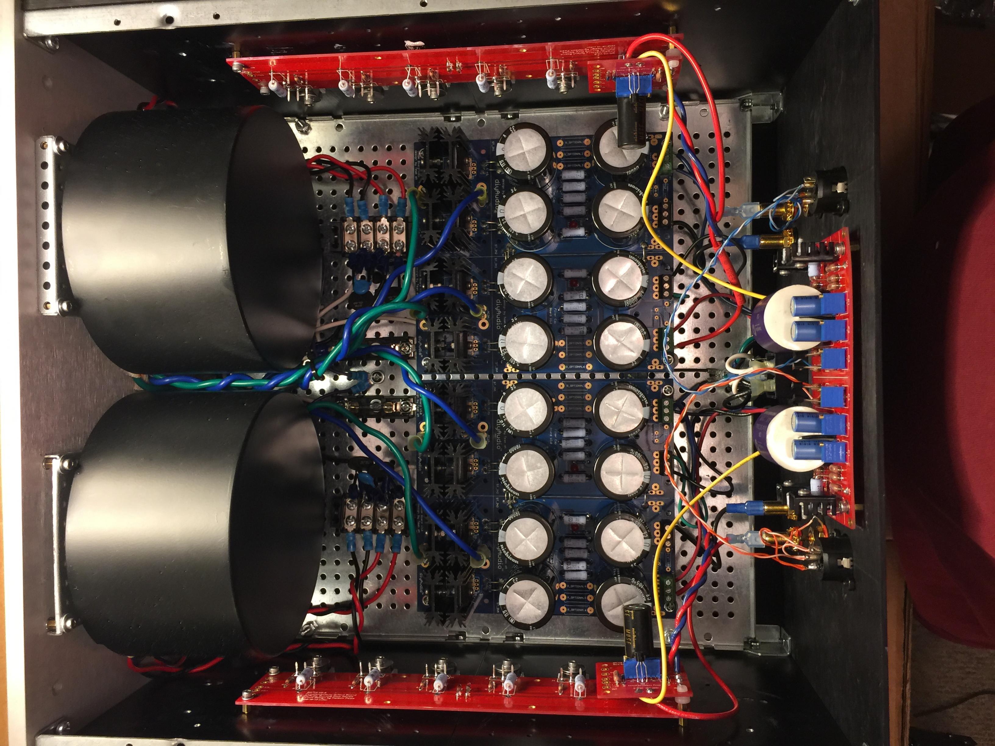

Another BA3 is born!
Initially started with 0A5 bias with 6 devices per channel. More fun to come.
As always, a heartfelt thank you to Papa, 6L6, ZM and the countless others that have made this possible!
I'm still not thrilled with the wire routing. I have a few tidbits to tend to, but it's alive - dead quiet and making music.
#protip - make sure to ground the front end. Ask me how I know... :rofl:
