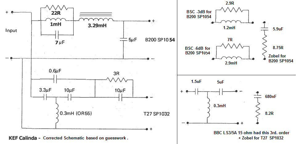

RDLewis, I can't understand why KEF used this strange crossover design...

Michelino, don't dump that tweeter of yours on a whim. Is there any reason to think it's bad? But FWIW, Vifa XT19 and XT25 are pretty good too. The crossover design is definitely wrong. I'm thinking 1.2-1.5mH and 7uF now for the B200. Maybe a 2-3 ohms resistance on the shunt too.
Come on people .... how can you take a x/o circuit that gives
a near short across an amplifier at high frequencies seriously ?
Its wrong, very wrong, people do make mistakes ....
If you swapped the position of the inductor and the notch
filter it would make a lot more sense*. As it stands you
have a 12uF path to ground (7uF + 5uF) which is 3 ohms
at 4.5KHz, 1.5 at 9KHz and a crushing 0.75 at 18KHz.
I guess circuit simulators still don't do smoke very well.
TinaTi has a nice option : an impedance meter, try that.
rgds, sreten.

The high value of the inductor may be due to it
doing BSC duty and reducing a midrange peak
in combination with the notch filter, hard to
say in a sim without the drivers response.
You can see the trap is before the capacitor here, the 5uF being top right:
So is the 3.29mH by the look of it.

I don't care, perhaps the board is wrong. 12uF across the input is wrong.
i've seen completely wrong x/o boards before, somebody gets it wrong.
12uF to ground is 12uF to ground, very low high frequency impedance.
Its not intentional I'm sure. I'm sure the positions should be swapped.
It should look like those x/o's in post #33.
Here it won't stop the speakers working, but its wrong, very wrong.
rgds, sreten.
That is a viable arrangement, both before the capacitor.
rgds, sreten.
I think the simple answer is that the x-over in #34 has an error. If you look at the lines near the bass inductor indicating wires there seems to be a cut and paste job that suggests a later alteration. Having the large inductor feeding the small cap across the bass unit would make complete sense and the values would not be outrageous. Both the B110 and B200 had peaks around 3k. Depending on the baffle size these could be 8-10 db. A over damped second order configuration was not uncommon. (I have schematics for at least 7-8 combinations of KEF bass units and various tweeters.) E.g. the Wilkinson 2-way stepped baffle design (B200//T15, Wireless-World from about 1978) had the bass signal passing through a 2mH coil to a 2uF cap for a 3kHz x-over. Totally non-standard values but measured fine apparently.

I think I'm becoming obsessed with this KEF Calinda crossover. It interests me, because 8" bass plus 1" tweeter is such a common design and I'm figuring what to do with mine.
To recap, here are the main T-S parameters for a KEF B200 SP1054 8" bextrene bass/mid (large magnet, low Q. n.b. Other B200 models had Qts around 0.45 and Le around 0.25mH):
Vas 130L
Qm 3.27
Qe 0.25
Qts 0.23
Le 0.45mH
Re 7.0R
Fs 25Hz
Main parameters for T27 SP1032:
Le 0.05mH
Fs 900-1100Hz
Re 5.2-5.6R
I've redrawn the schematic to reflect what we think it really was. And I've added some appropriate calculated Bafflestep and Zobel values for those who know about these things. So we've now got a bit of a cookbook if you allow for how they interact.

My bad regarding the 12uF, of course it would be 3uF which
isn't half as bad, a quarter in fact, but it would still be strange.
With 5uF across the driver a zobel is not a good idea, probably,
as any driver inductance will "help" the x/o, not hinder it.
Back of an envelope indicates the trap filter is centred on 1.9KHz,
sounds about right, you really need to know the drivers response.
The big inductor is doing the baffle step stuff.
rgds, sreten.
