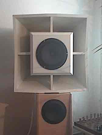

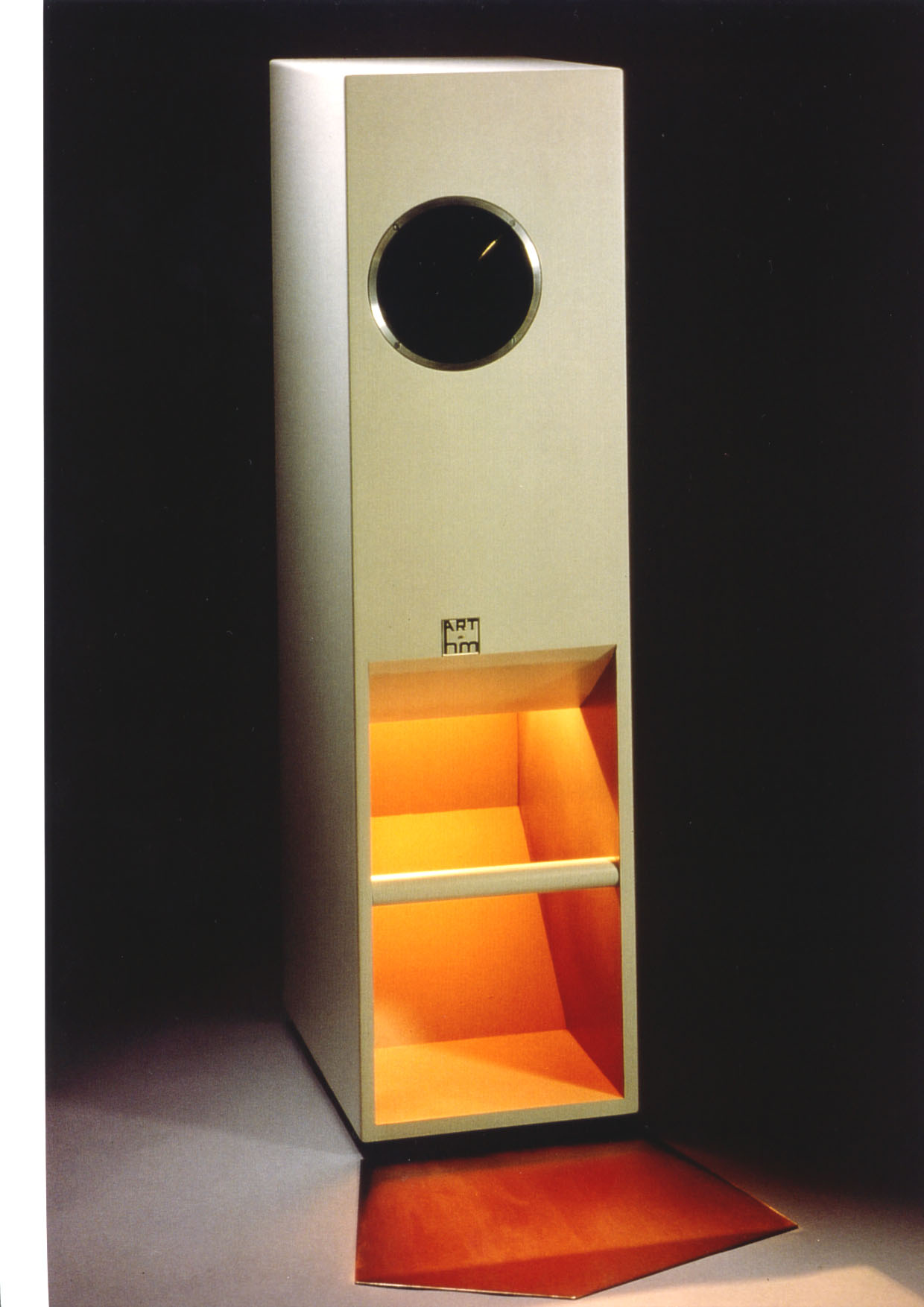

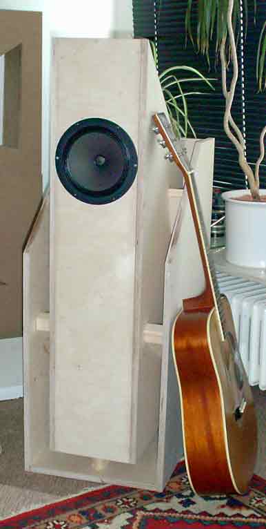

Hello,
if you made a measurement of the Manger
from the back, you won´t use it OB.
i made in the 90´s the BASSTUBA with MAnger.
If you couple the Manger with a B200
in a wide range you disturb the Step response,
look Basstuba measurements on my HP.
because of the data of the B200, it works best
in a BL lowmid Horn, no parts up to 98 dB, + sub
look my SCHALMEI, HORN, TRUMPET sat horns,
and in my double horns SAXOPHON, RDH20
+ invers 2nd driver
feedback, measurements
