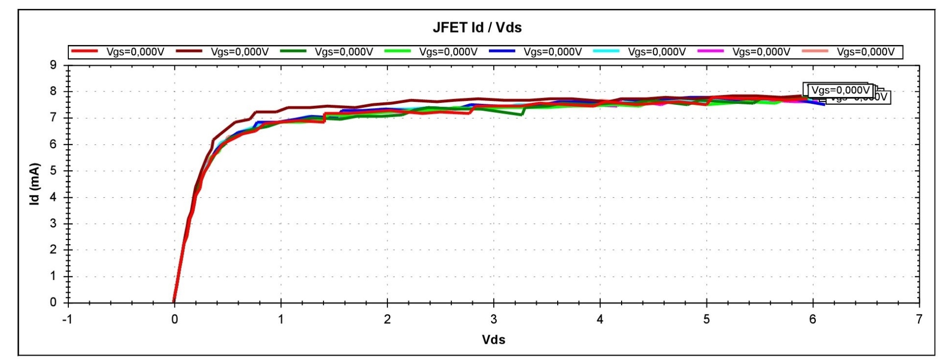

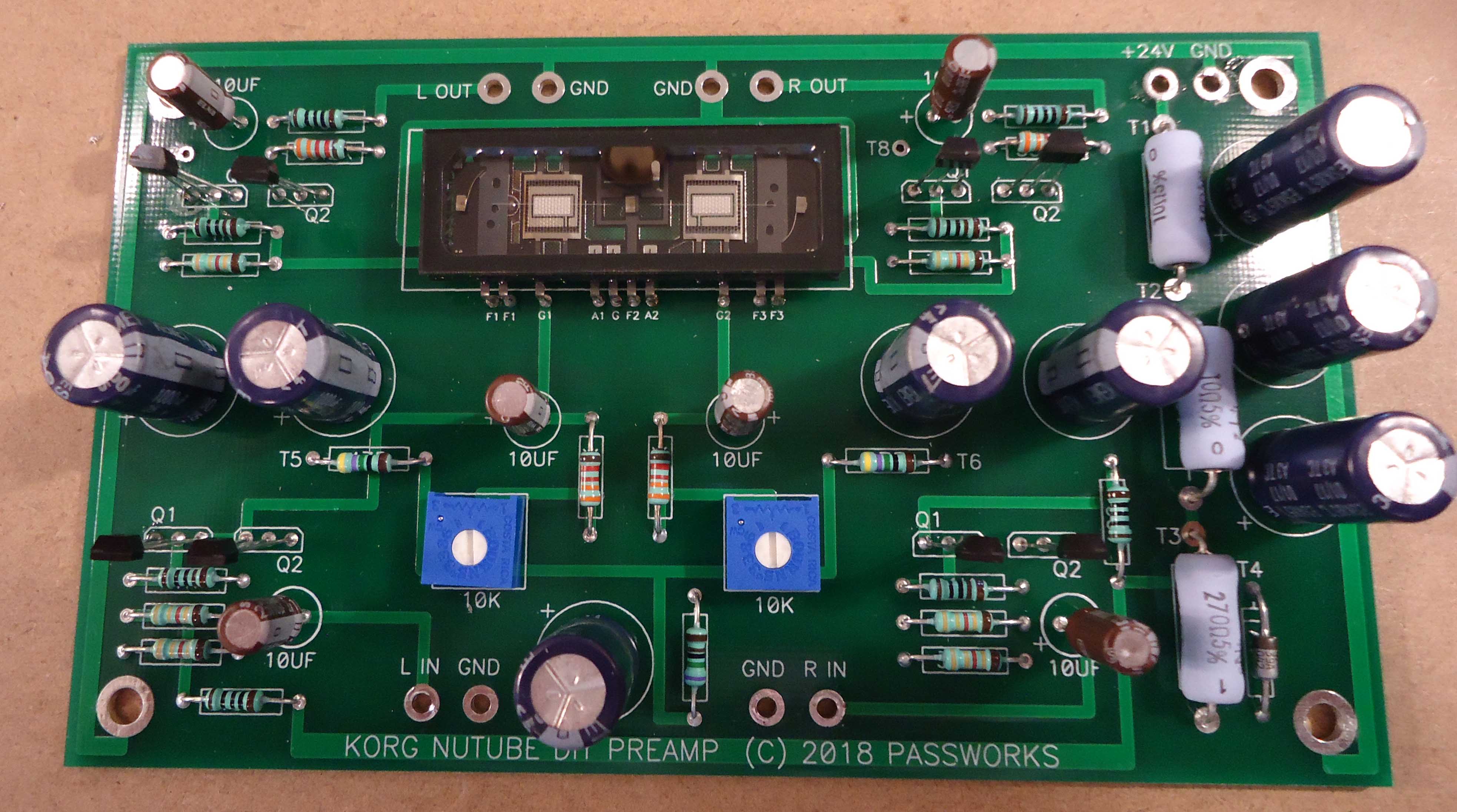

Here is the operating stuffed copy.
It uses the Toshiba 2SK370, which is the 170 in a slightly different package.
I am considering two versions of the board, with the Toshiba/LS parts
and with the cheaper Fairchilds.

Ok......I was thinking if only one version should be handled (the expensive) then this version would be a little bit cheaper than if two versions should be handled. I would go with the expensive (best components). Compared to the time it takes to finish such an amp.....the price difference is not important for me…...but maybe it is for other…..
It would probably be something like the difference between $49 and $99 in the store.
I think 50 bucks is significant in a preamp circuit. Is this just a pinout thing plus possibly some resistor values? If it comes down to only making one board version available, I vote for the LS pinout and I can cross the legs on the J113s if I decide to use them.
Done. New artwork will accommodate DGS and DSG pinouts and
current source degeneration resistors on the buffers.

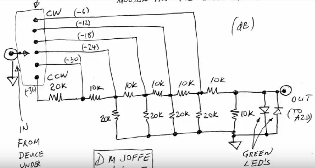

i use a UCA202 DAC (20$) with my old laptop to do the measurements
Softwares are: Audio Tester, REW and Arta
After having destroyed two DAC i built an attenuator following a schematic by DM JOFFE (?) i found somewhere here around. Helps a lot
I really would want some means to see the distortion when setting the bias for the Korg triode. The changes in distortion pattern are a lot! In my case i use a setting of well out of half supply voltage.
